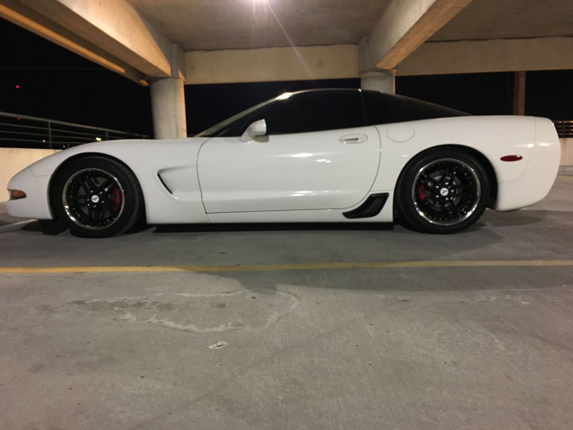

I used my jacking puck locations, I can lock mine down tight, to get a good stance. Stock is rear puck 1/4" higher than the front, as long as the rear is not lower these cars look good with that rake, I set mine level and my wheel well height with same diameter tires is 1/2" higher than the front 26" front & 26.5" rear. Picture has been straightened. I say set how you are most happy.
