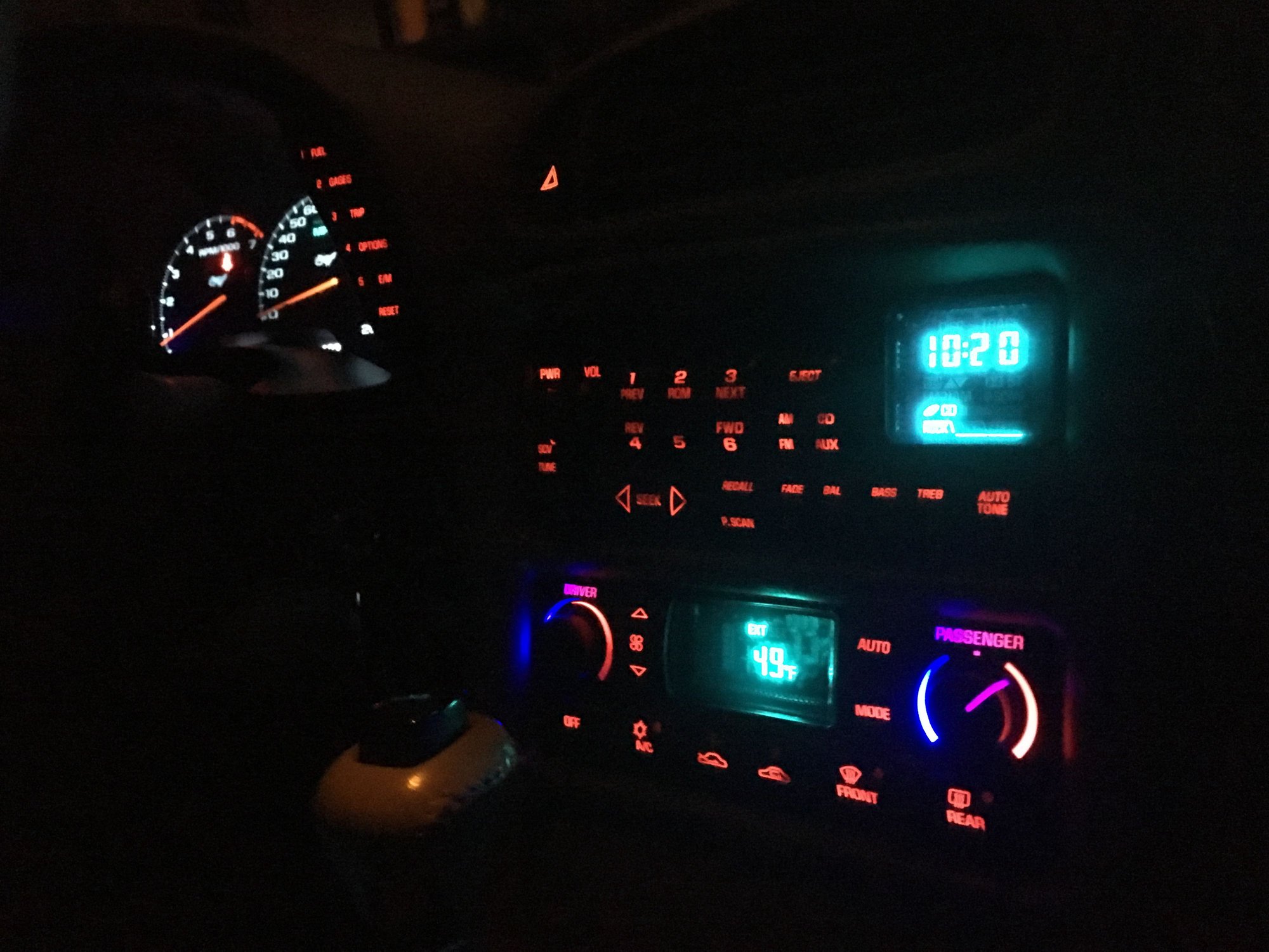

Didn’t lose my dimming either, not that I care, I like the ‘circus’ of colors I have. Dave is in Georgia and turnaround was less than a week both times I used him.

Its interesting to here about the leds still dimming, could you elaborate? The stock dimmer is a rheostat and would dim much faster than the original incandescents. I assume it would be completely dim by about the half way mark, wouldn't that look out of wack with the dash display (blacklights)?
I am having a nightmare trying to find the stock incandescents for the DIC cluster. You can get generic ones from ebay but they don't have the blue rubber shield around them. I'm thinking switching to LEDs might just be the easier option..
Also great advise about removing the bulbs from the neo wedge, and then not having to use a resistor!
