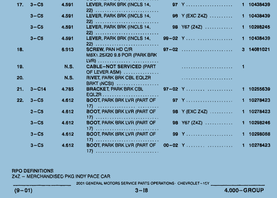

Taken from Part Manual:
Clearly shows Pace Car E-Brake handle having a different part number. But as stated I wonder if it had to do with a different color handle and boot ?
#17 shows 4 listings, 1st, 2nd and 4th have the same part number, the 3rd is the Pace Car Z4Z RPO Code

So I did a little investigating work for ya...........the new part number is
10323579 and that is interchangeable from 97 thru 04.
https://gmpartsheadquarters.com/1998...parking_brake/
YET, this site states same part # but : EXC INDY PACE CAR ( Z4Z ) ?
https://www.wholesalegmpartsonline.c.../10323579.html
As stated I would check with Marc from Vettenuts just to be sure but I see no reason why you can get a replacement from a base model
