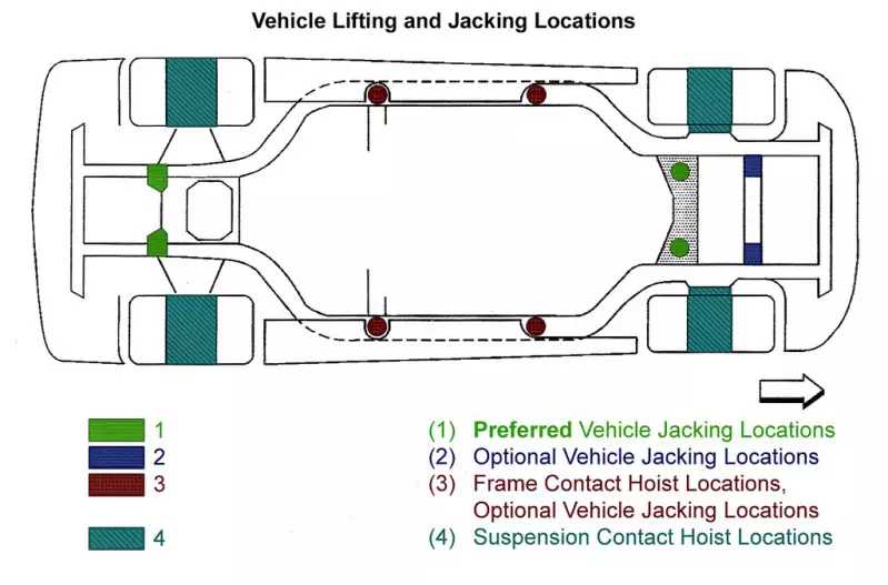

The C5 has a super strong hydroformed chasis which is not fragile and will not flex. Pucks are used to avoid damage to the body panels that wrap underneath.
I use Race Ramps so that I don't have to deal with slipping Rhino Ramps and for better clearance. Then I jack up the rear from under the cradle just a bit higher than the front. Be sure to use wheel chocks on the front tires before jacking the rear.
Here is an illistration of the lifting and jacking points.
Elite Frame Rails. http://www.eliteengineeringusa.com/c...nd-mtg-screws/
