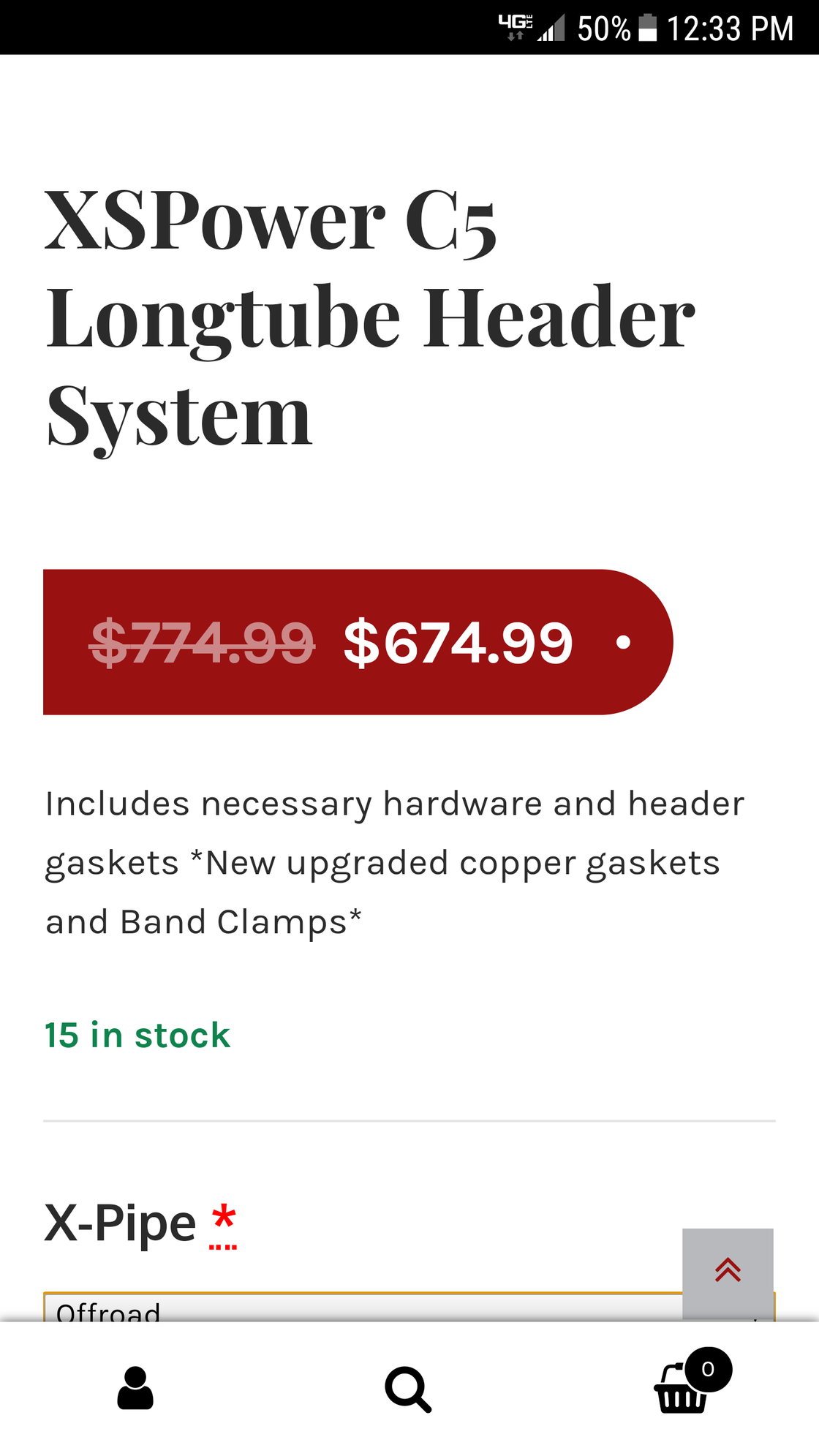

I know this topic has been beaten to death and I know there are a hundred other threads on the forum. I'm like most guys that bought a C5. I bought what I can afford and I think for the money, the C5 is the best bang. Now comes time to do the headers, since I am planning a cam swap in this winter. I do not have the resources for $1,000+ Kooks or AFH. I wish I did. So after my research online and on the forum, my plan is to go with the XSPower kit.
Rather than the cheaper Fleabay kit https://www.ebay.com/itm/Long-Tube-1...LH_TitleDesc=0
Does anyone have anything to add before a pull the trigger, both positively or negatively?
