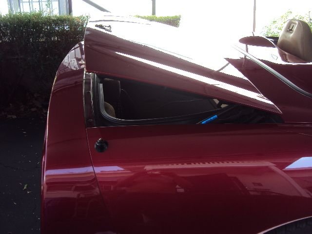

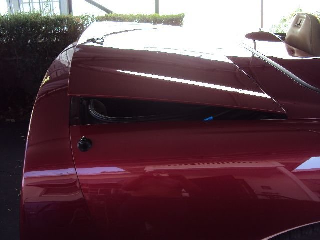

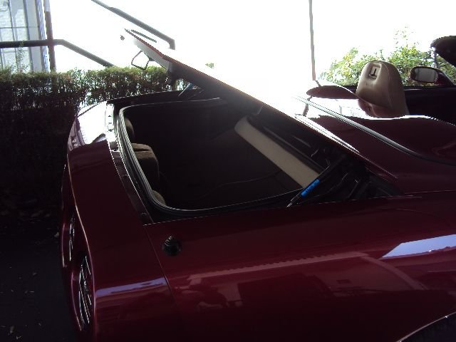

I replaced the struts last fall.
My trunk lid stays open, no matter where it is placed.
