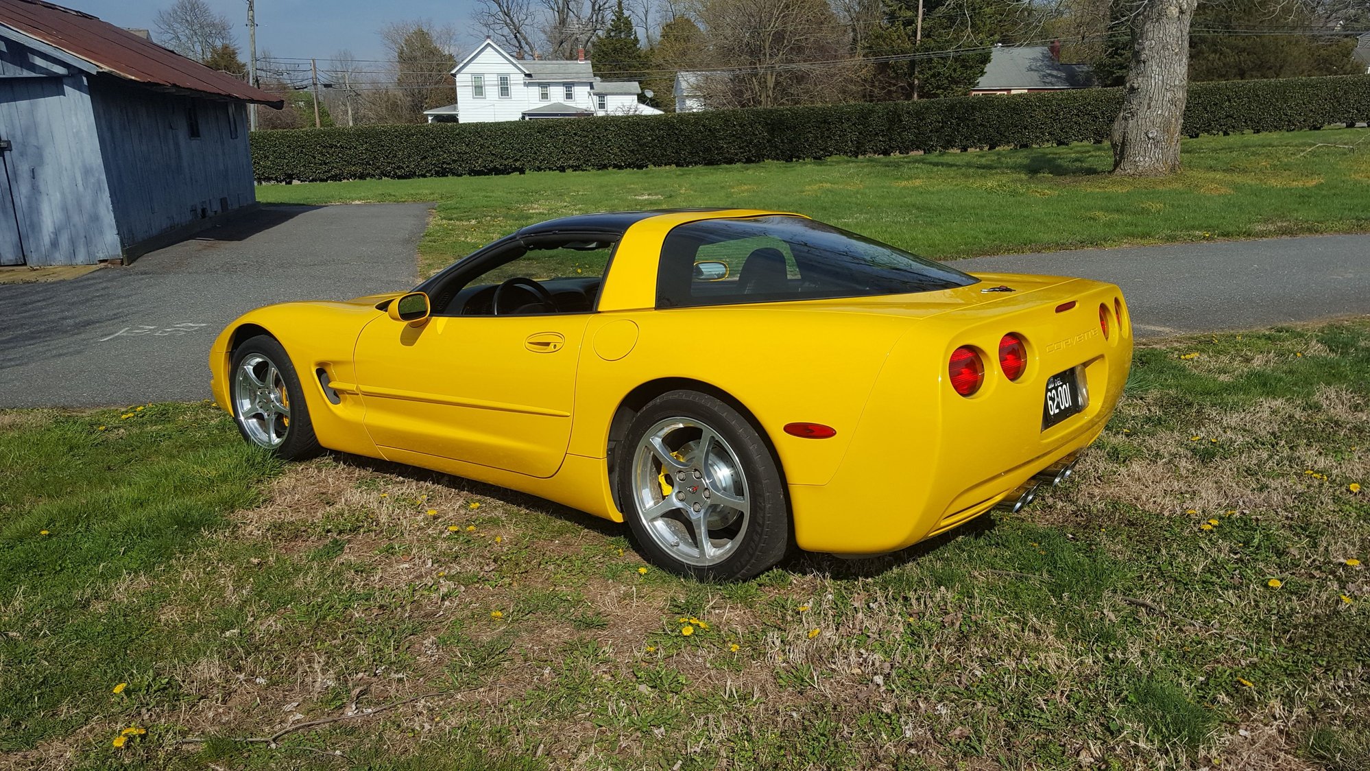

It's doable. Unthread the rear all the way so 1 thread is showing. Take the fronts out and grind off the rubber. That's what I did. I'll go snap a pic for you.

Old Jul 26, 2018 | 08:16 AM

Not very good photo. Might have to wait til the sun comes out.

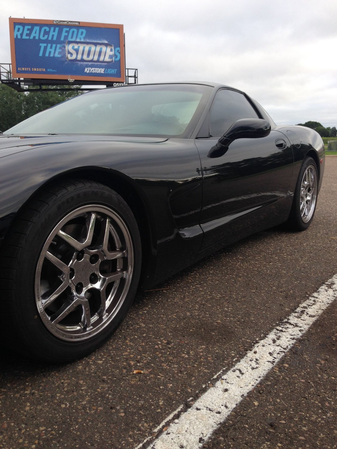

An inch is no problem on factory bolts. I still have threads left and I'm down about an inch and a half.
