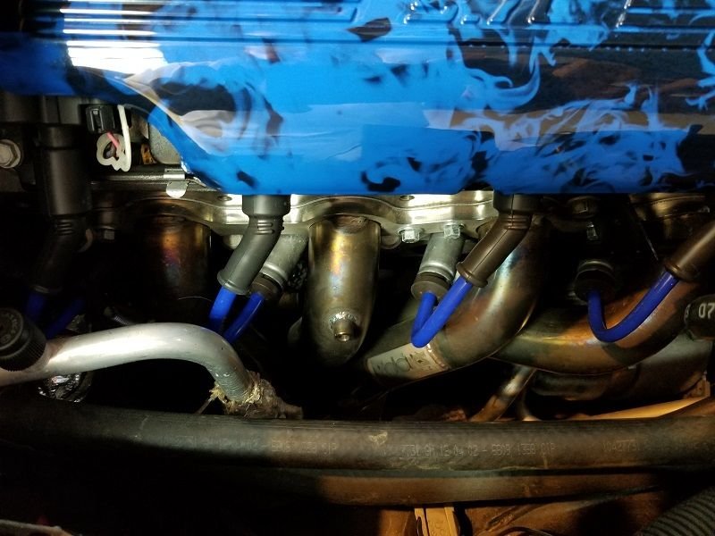

Metal factory pieces, no problem after 4 years...
TSP headers. If you run headers that are closer to the wires, maybe another solution will be needed.
