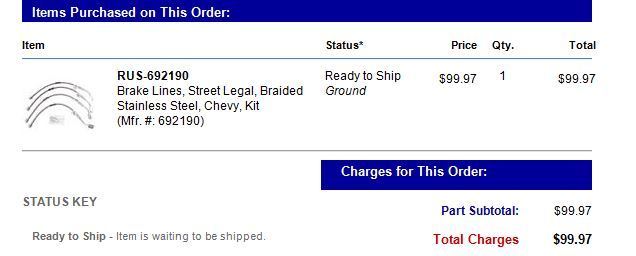

I'll check out TCE if i end up upgrading the fronts to a bigger setup.
This is what i paid to summit. also shows the part numbers in case you're looking/wondering. they came in 2 days, no tax or shipping charges.
