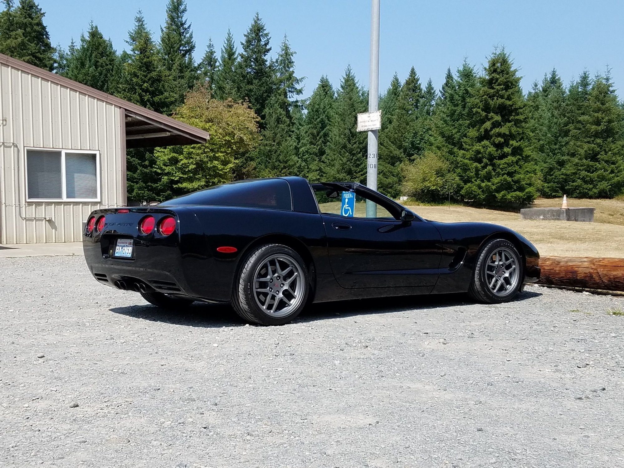

Yes, They will fit and are commonly swapped onto base C5s
It is my favorite look of all the C5s. Even if the wheel might be a little bit dated by todays standards by some.

Classy!
As much as I like some of the wider, more aggressive fitments with bulging fenders on these cars, sometimes simplicity works well, too. This is a perfect example. The dark argent works wonders with the dark paint.
You're making me want a set as a 3rd set of wheels. I don't need another set, but man do those look good.

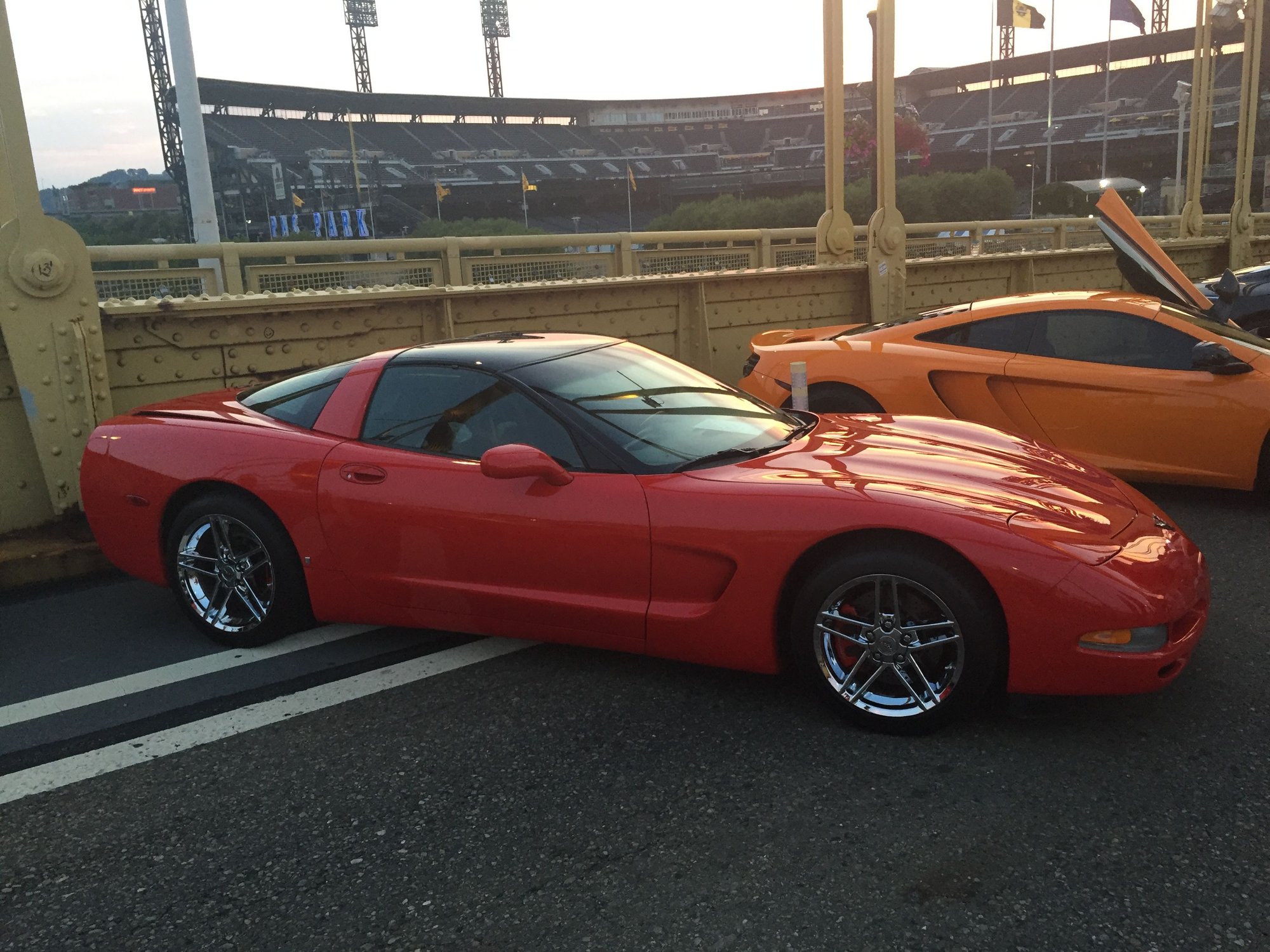

This is a C6Z06 wheel in C5Z06 sizes with standard C5 Coupe tire sizes. I have been running these wheels and tires this way for well over 10 years without a problem.

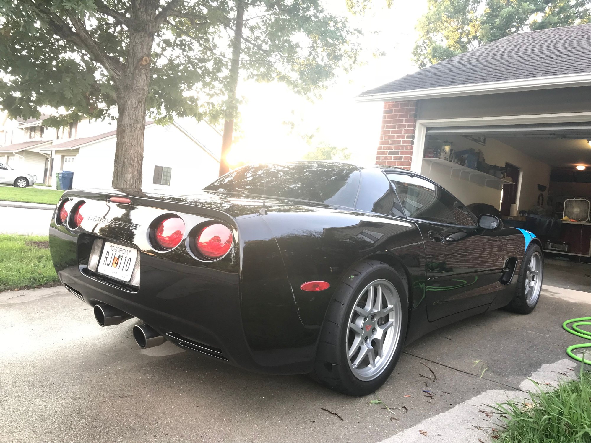

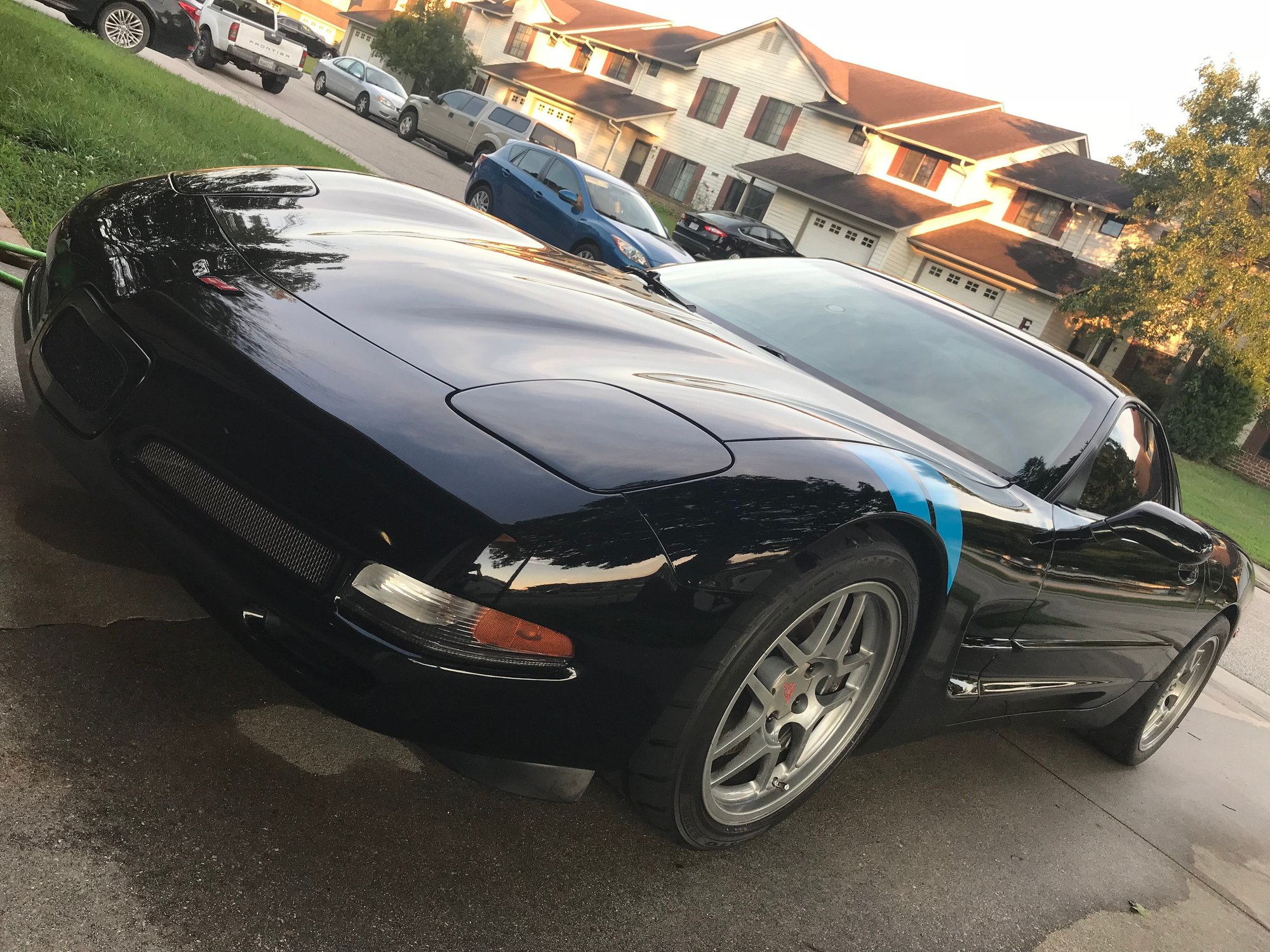

If you don't already have the wheels you can do 18x9.5 and 18x10.5 like I have on my car. There's more tire choices and sizes like 265 front and 295 rear.
