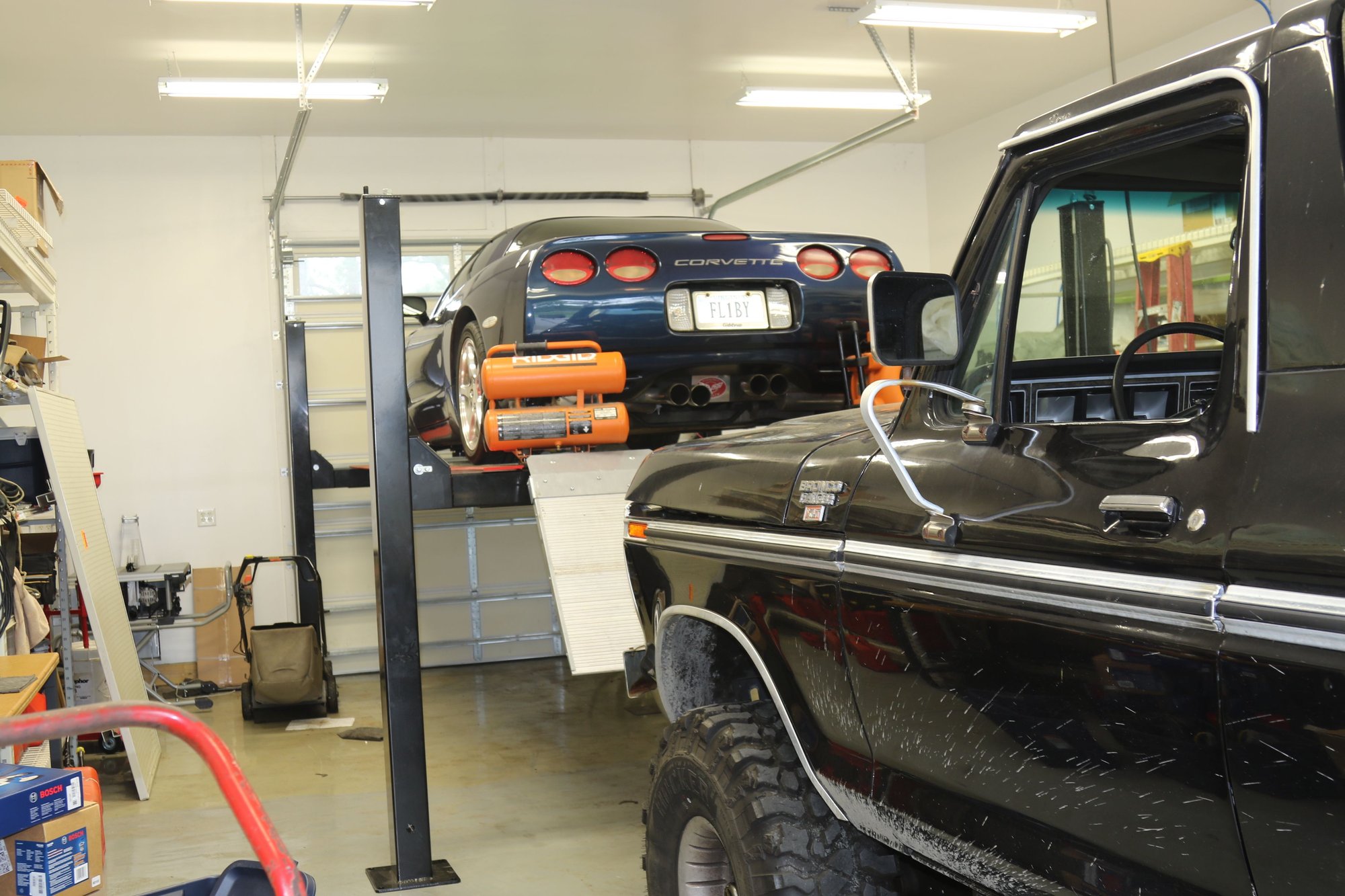

Inside height needs to be 10 feet. That would allow you to put the Vette up and leave room for most vehicles under it. If you can get a larger footprint then go
26 x 44 10 foot door and 12 foot inside ceiling
10x10 back door; front 18 x 10 Hurricane Florence prep.
high.

As great as all the wonderful advice is listed here, if you have a fairly firm budget to keep and limited to size, you are painted in a corner. Bigger means footings, footings = $ (at least in a frost area).
If you have to keep it small, attic trusses and drop down steps are a must. 9-10' ceilings a must. I have a 9' ceiling, wish it was 10'. I just purchased and installed a Twin Busch 2 post lift (9,200lbs, $1499.00 +300 shipping, good quality, happy so far) the posts are about an inch from my ceiling. I can get the bottom of the car close to 5' off the ground, but haven't measured it to be exact. Wishing I had that 10'ceiling. We all want the biggest man cave possible. Good luck with the wife
