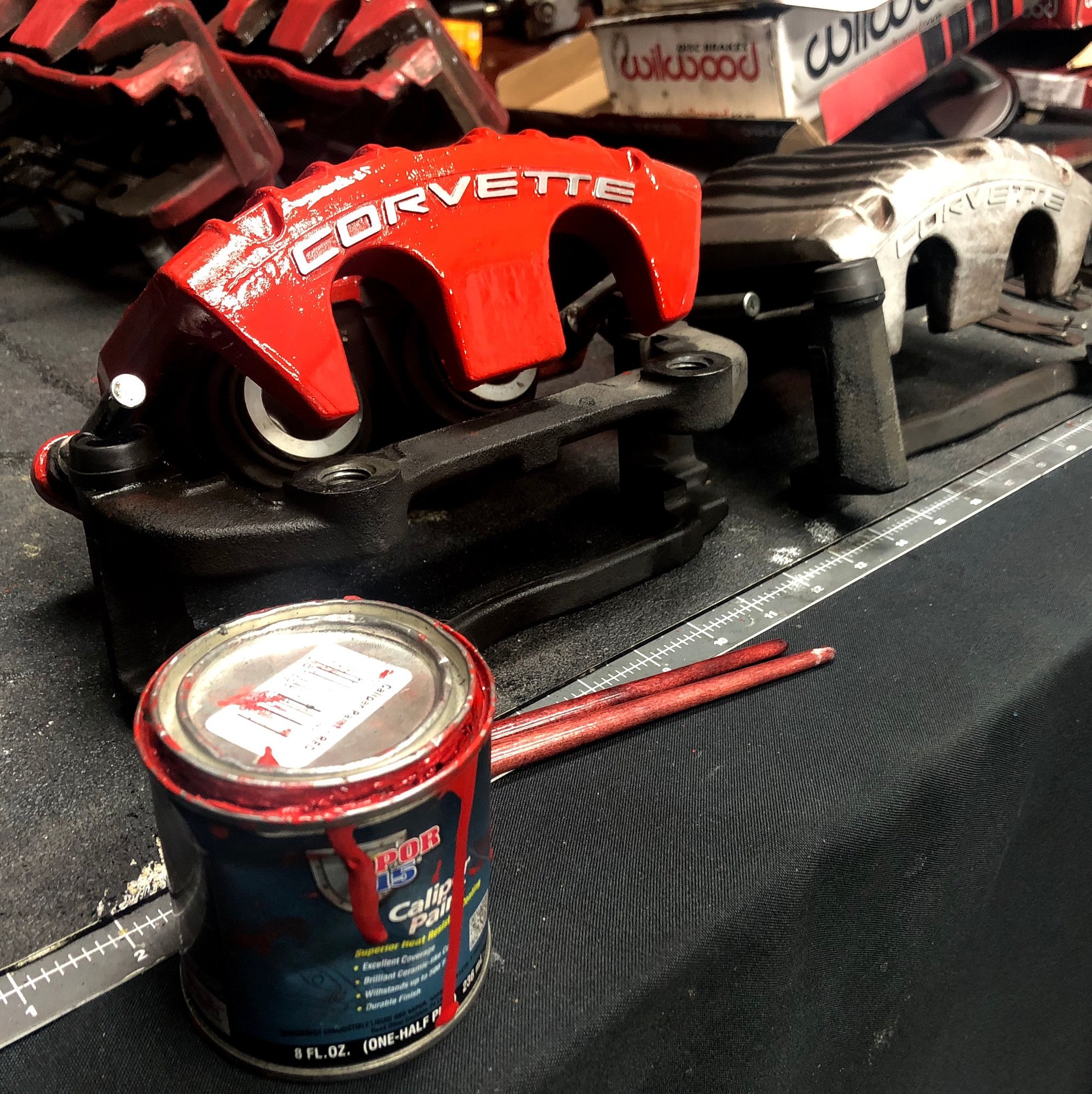

Hi - I usually paint my sets with POR-15 Caliper Paint. I usually don’t have to mask off but I have several paint brushes I use to get around the areas where I want it. I find it holds up great and easy to wipe down (brake dust/grime etc) without chipping or fading. Anyways, here’s a pic, I was actually painting some tonight so I snapped a quick pic halfway through:
Goodluck!

Por15 has a legendary hard surface when cured, I was never able to save brushes tho.

Is that torch red?

Well it’s pretty dang bright red, I just touched up my C5Z calipers several days ago with it without issue. I’ve also used VHT caliper spray with luck but can be chippy without proper prep (like most things).
yeah it hardens pretty good that’s why I like it, I actually use the black on rotor hats (depending on rotors) and that stuff sticks and easy to wipe down, plus it’s pretty cheap on Amazon, not sure who else carries it. Almost as soon as I’m done brushing I wash the brushes with Lava soap and I’m good for another day.

Yeah, I'm always messing around in the garage so I keep plenty of those bars on hand - I just scrub them down right after I'm done otherwise they'd be ruined. I was gonna take another pic of the POR-15 once it dried but it looks just as glossy so no point I guess
