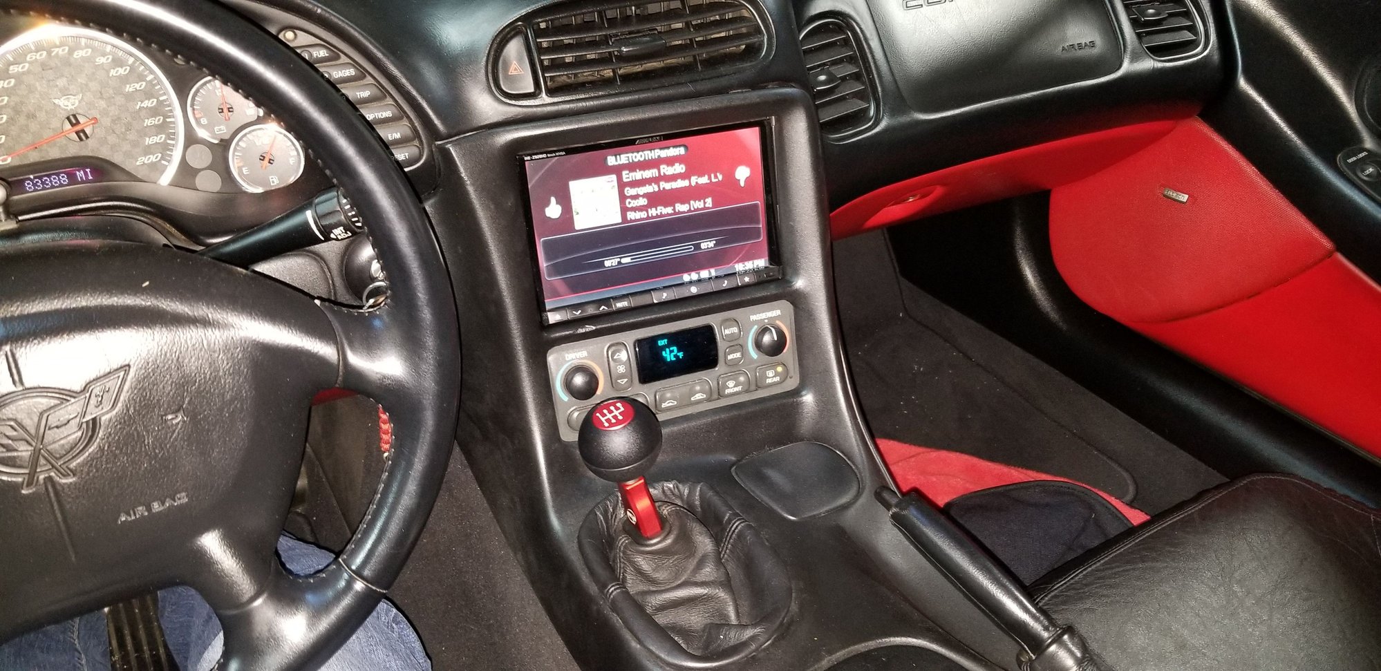

car almost back together, radio boots instantly when you insert the key (don't even have to turn it !!!)

so far I think I'm going to love it !!!!!!!!!! (love the flat stick) !!!!!!!!!

Hi Pounder,
Just finished replacing a Kenwood DNX 5150 with the very same unit you have. Did a lot research prior and found this to be a well reviewed with good support and service.
Was skeptical at first but I'm really happy with this unit. The sound quality and clarity is better than the Kenwood it replaced.
I had a Corvette boot up logo / pic ready to install but there is virtually no boot up, it's instant on.
The hand gesture volume up and down are a hoot (this feature can be tailored to suit or turned off)

I love the apps you can use for the desktop, have not driven the car yet, doing other work and some severe weather here ~!!!!
