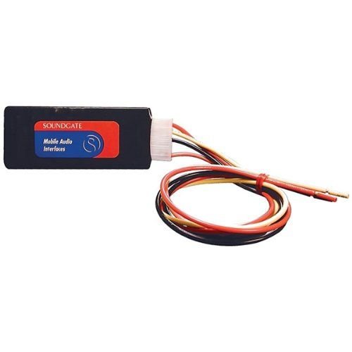

Originally Posted by 8VETTE7
Any options to retain RAP if you have taken Option #5 and ripped out everything and put in a new head unit, replaced all speakers, added a subwoofer and an external amplifier?
The
<b>Soundgate GMACC</b> Soundgate GMACC
will do that. There were at least 2 other options available, but I believe they've been discontinued: GMRAP and Accessory Valet.

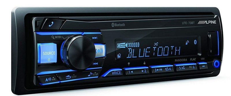

I did a budget single-din upgrade because the OEM deck was so old and tired and pathetic.
My upgrade was under $200 all in. Easily reversible to stock. 1000% better sound.
Alpine digital receiver UTE-73BT with BT, USB, Android, iPhone, iPod, Pandora, MP3, Aux, etc.
Metra dash kit
Axxess XSVI-2004 interface (RAP and Bose interface)
JBL 5.25" speakers in rear.
Crutchfield readyharness
Installed in 60min total. I can finally hear music over my Borla straight pipes. FM reception is better. Hands-free calling is crystal clear. Pandora is nice. Bose speakers sound surprisingly good.
