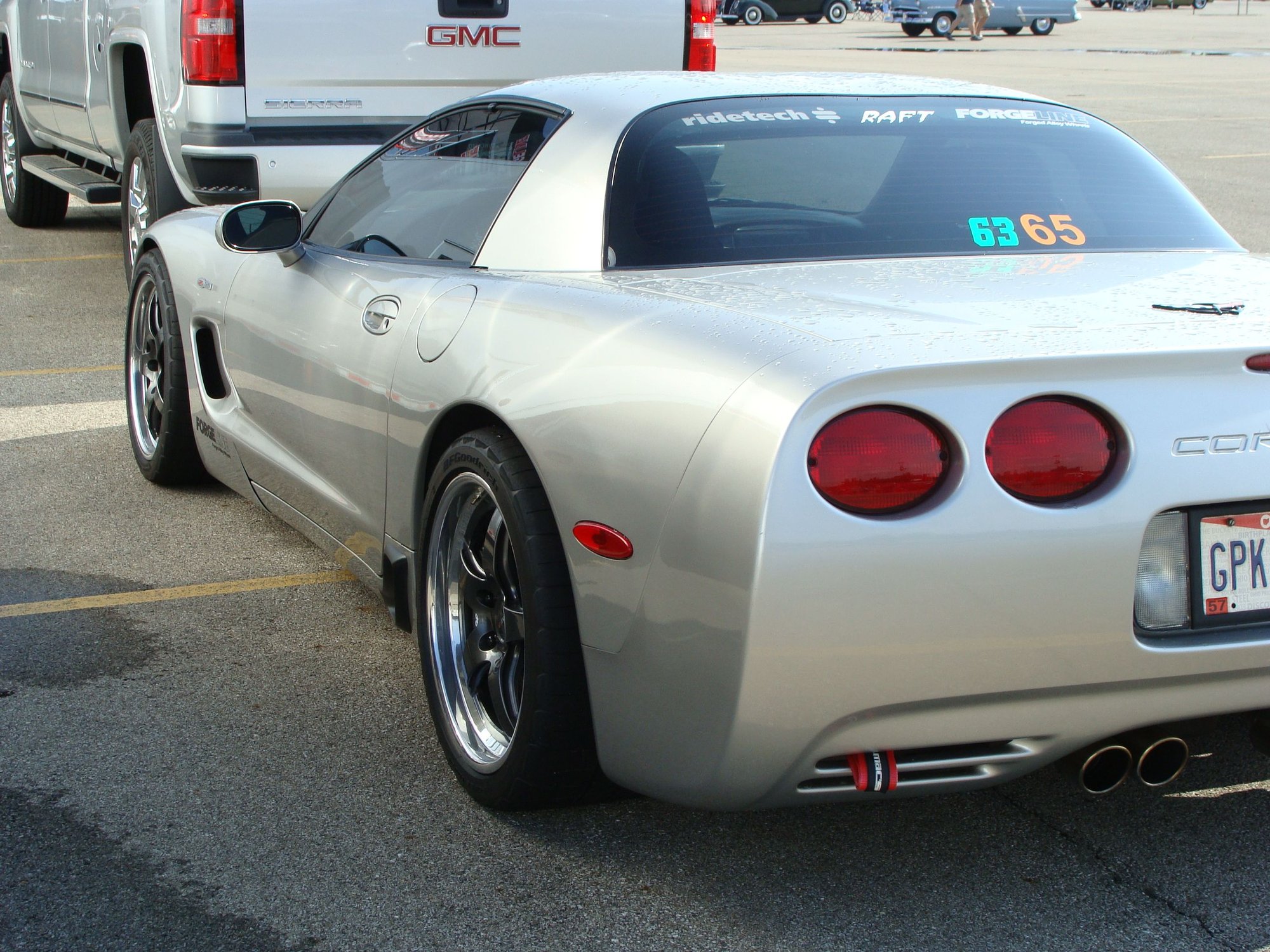

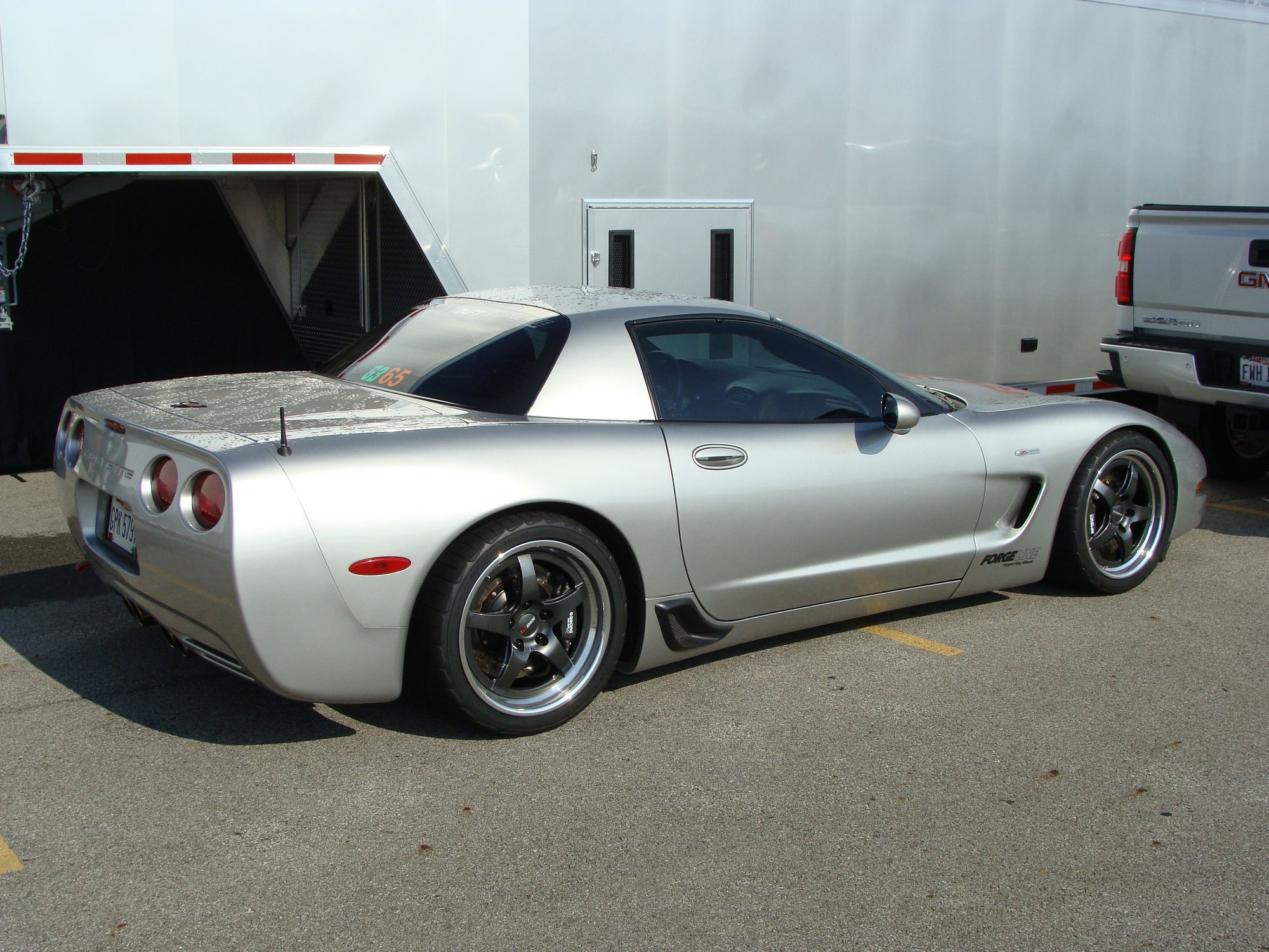

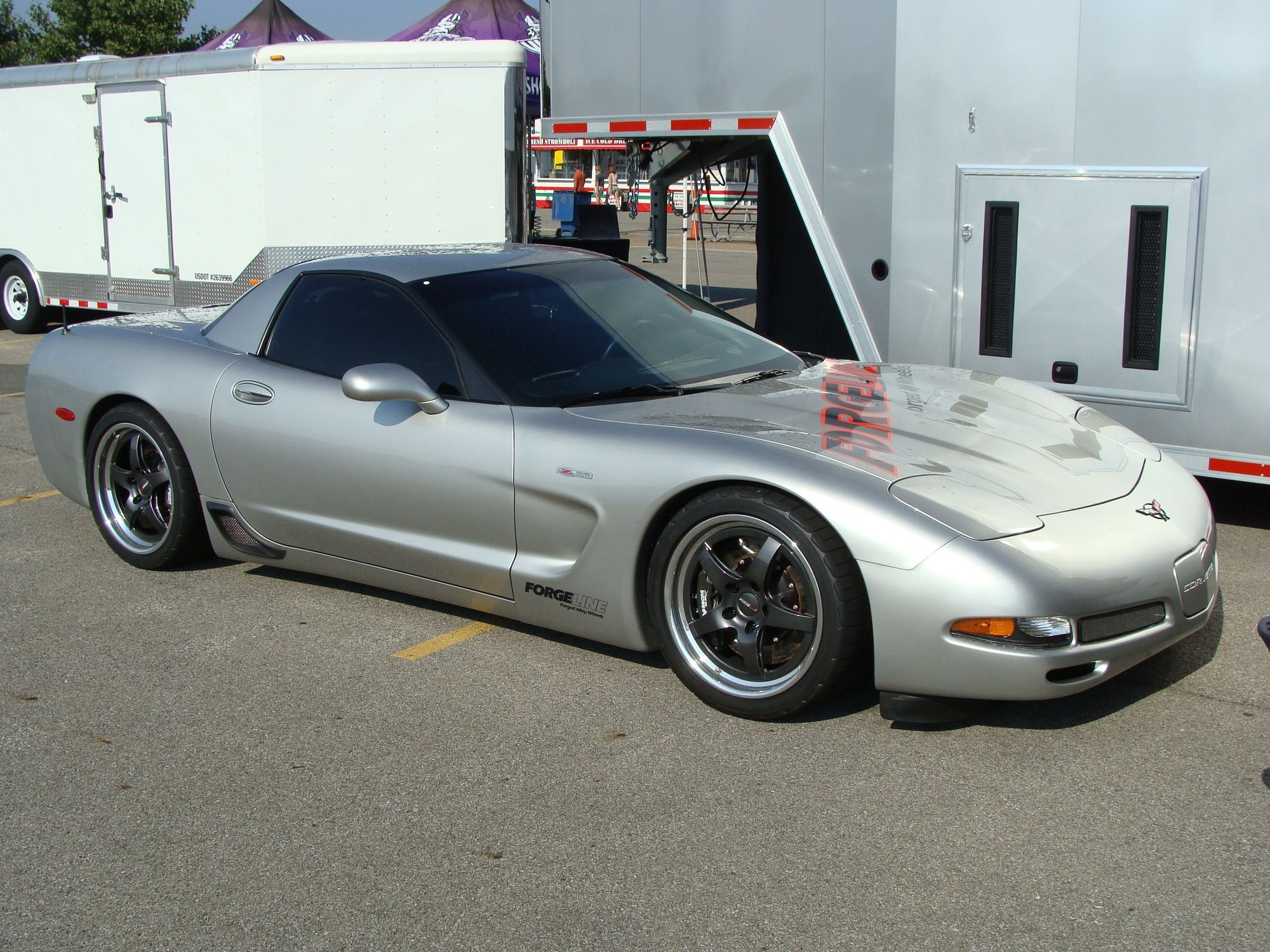

I shot this car at the Goodguys 2017 show in Columbus Ohio, it was a square setup but can't remember if it was 305 or 315, the woman I talked to said they rub at full lock in front.
That looks about perfect. I'm pretty sold on the GA3R, but that's the form + function I'm looking for. Being that I rarely hit full lock, I'm not too worried if there's a little rub. Thanks for the CCW link, btw. The Corsairs are an option I had not considered previously, but might not be a bad way to go.
