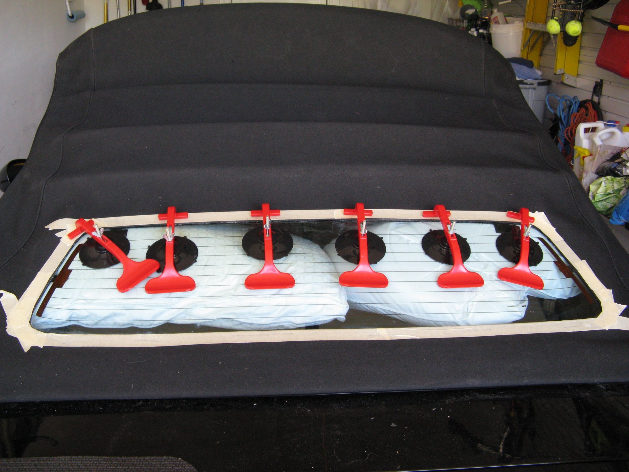

Here is what I did.
Bought Rhino Ultra Glue and “Universal Vacuum Clamps” (six in a box) on the Internet.
Unlatched the top to loosen the fabric. Supported the top with a piece of PVC piping. Stuffed pillows against the window from the inside.
Removed the old glue stuff from the glass using a glass scraper. Cleaned the fabric and glass with rubbing alcohol and glue remover. Masked the outside fabric as a protection against any glue run off. Glued glass top first using all 6 clamps. Clamps stayed on for 12 hours for each application.
The two sides were done next.
Last was the glass bottom.
15 months and still holding

Flex glue was too easy, it did not need any braces or tape to hold it, the stuff grabbed hold and was instant bond like in the commercials. Fast and all I did was clean up the perimeter of the glass with fingernail polish remover then laid down a nice thick bead all around the glass and with a little pressure pushed the glass onto the top window opening which like I said was an instant bond. Waterproof too . Less than 20 mins. I bought the tube at Walmart for 12 bucks.

Ok, I'm done. Time will tell whether my process was successful. I took several of the best tactics listed here and went for it: cleaned glass, pillows to hold glass in place, Goop automotive glue, masking tape and let it sit for 2 days. Looks good. Thanks to all for the input.
