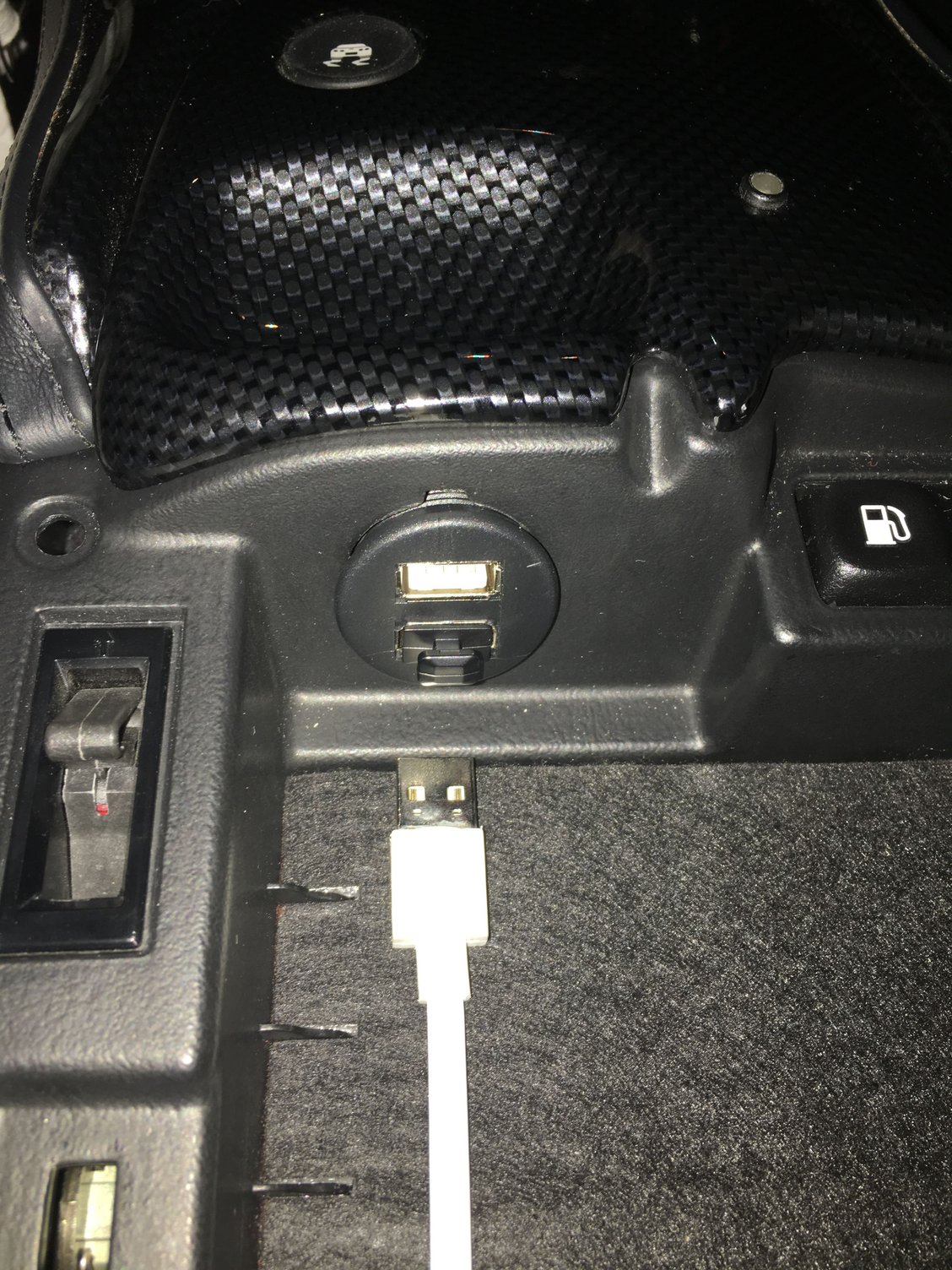

My kenwood dnx893s has two usb cables for android auto or apple CarPlay and usb power, so I got a a flush mount usb extender from amazon and it fits perfect in the 12 v port in the console. I have short usb c cables for my phone and it stays in the console. I do not like phone mounts, they are not my style and with bluetooth and hands free, what's the point of a mount?
https://www.amazon.com/gp/aw/d/B01ICY7VJS?psc=1&ref=ppx_pop_mob_b_pd_ti tle
Here is a picture, this is actually a power only port that I used to have, but you get the idea, that's where the double usb is that is connected to the radio.
As others have said, I had the carpet out and ran the camera wires to the back, I did have to drill a small hole but I sealed it with RTV and no one will ever see it behind the carpeted panel. I found a screw for the license plate light and mounted the camera to that, looks almost factory, and blends in great.

I did the same. It's nice to leave it out of sight! Open console, connect phone, close console!
https://www.amazon.com/gp/aw/d/B01IC...mob_b_pd_title
I love this! thank you! doing research prior to my double din install! this was now added!!!
