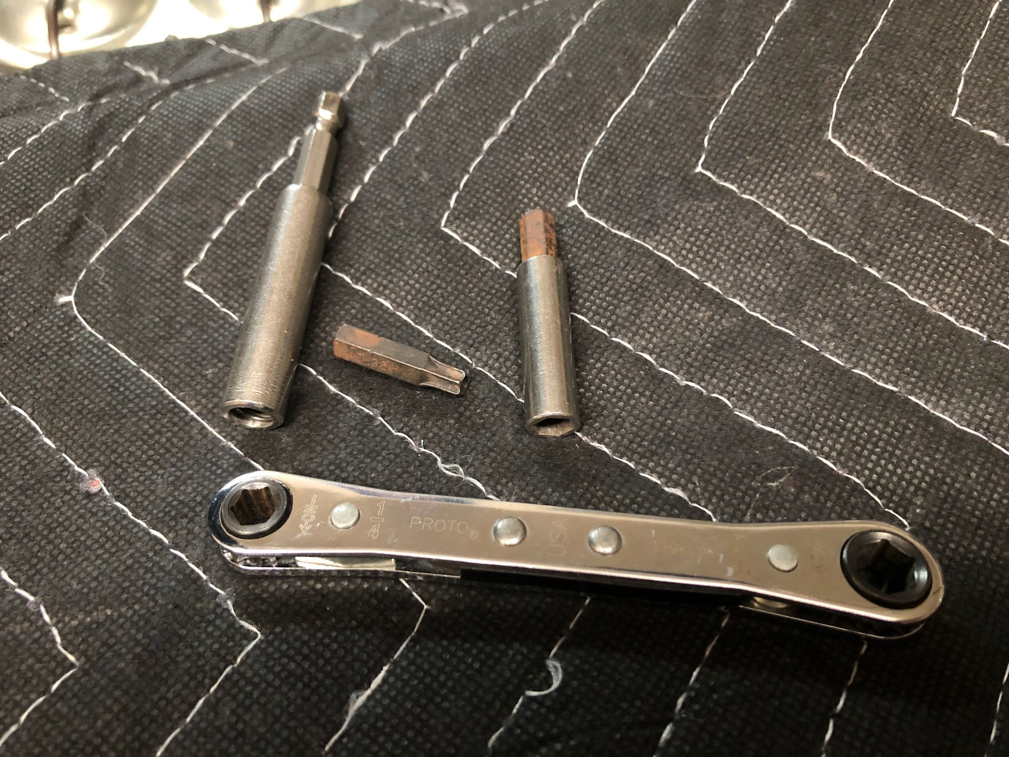

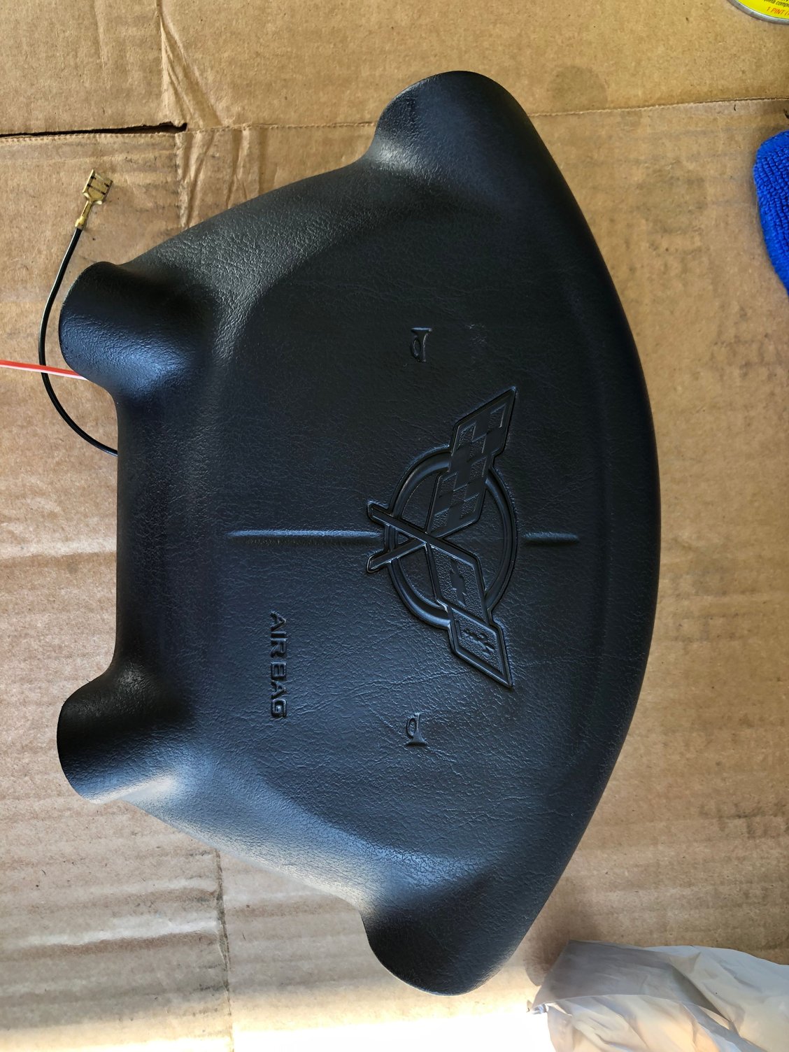

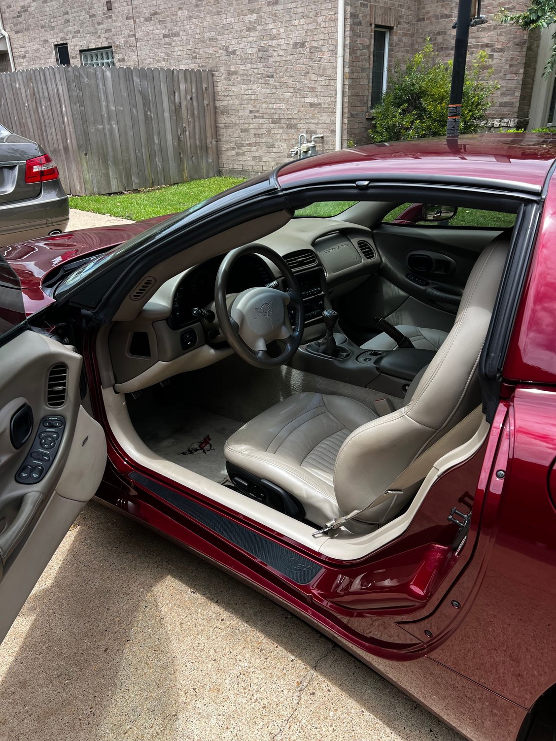

About 5 years ago I had to fix the Black Sticky Horn Button/Air Bag on my 2003 C5. A friend of mine has a 2003 Anniversary Red with the Shale Interior that had the same problem. This is a common problem with the C5 but not that difficult to fix.Let me run through how I do it.
First off I drain the power. I turn the steering wheel 90 degrees to where the top of the steering wheel is facing the drivers door because there are 2 T30 Torx screws holding it on from the back and now you can feel the holes above and below the steering column. Once I have it in this position I disconnect the battery for 24 hours (some say I’m over cautious but better safe than sorry (if you don’t drain the power this could set off the air bag)). After 24 hours, with the Positive and Negative disconnected from the battery I will touch the cables together for a few seconds, this will assure that any power stored in any capacitors will be drained of power. Now I use a T30 torx bit in a magnetic bit holder like you use in a drill. Getting the Torx Bit into the screw seems to be the hardest part, it has to be straight into the hole. Once it is in the screw I use a 1/4” ratchet wrench to turn it. When you have the 2 screws out, on the back side you will see a yellow plug in wire with a lift tab, unplug it. There is a red wire with a white sleeve on it that goes into the center of the steering wheel. Push the white sleeve in and turn it counter clockwise and it will come out Next there is a ground wire on a spade tab, unplug it and you will have it free.

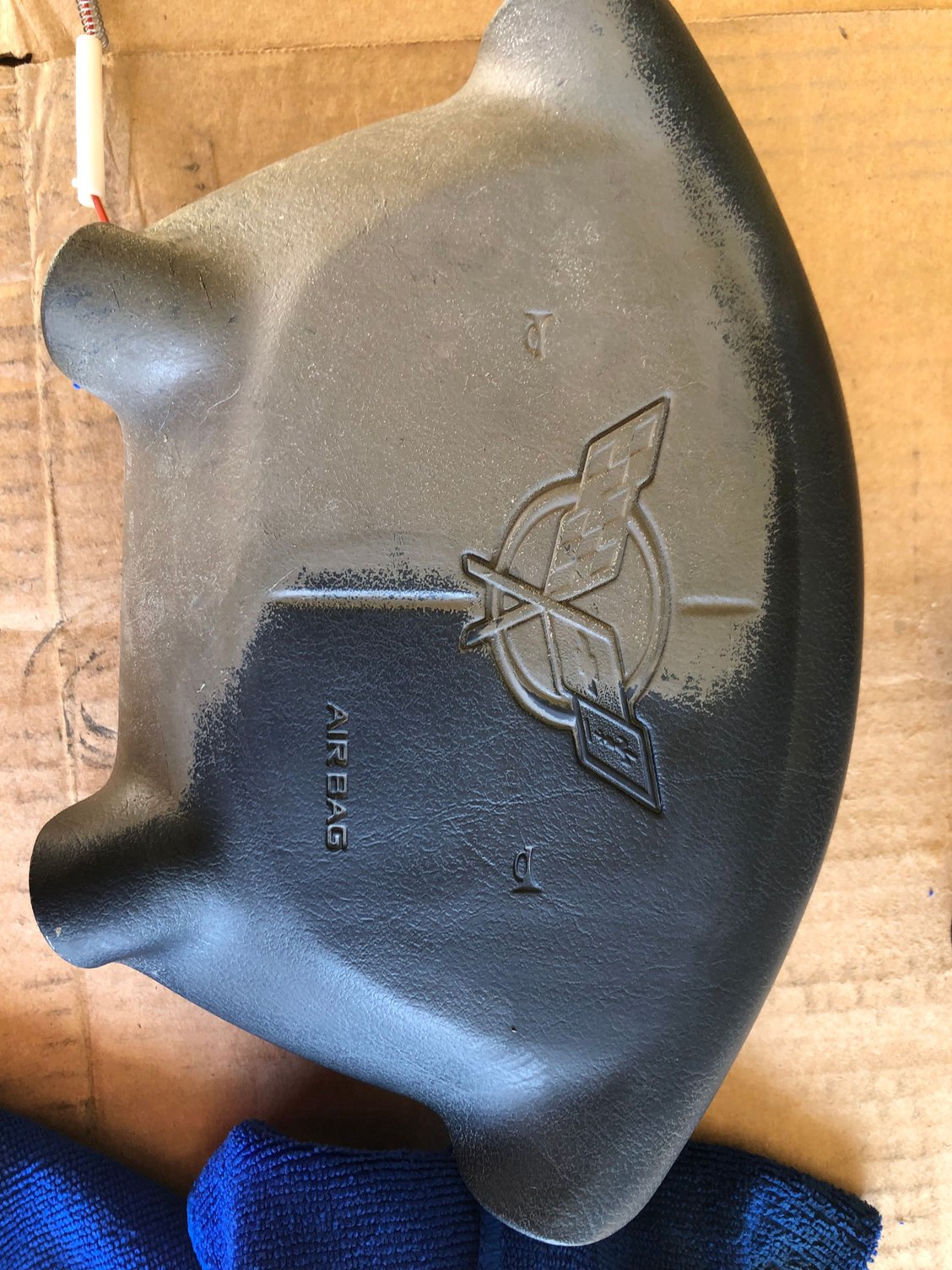

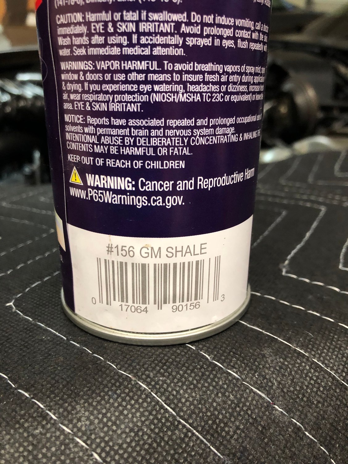

Now I use Goof Off and a Microfiber rag to clean all of the old finish off. You can use a toothbrush to clean the small grooves but I usually just work the microfiber rag to work it out. Make sure you get it all off. Then I mask the back with blue painters tape. When I’m ready to paint I will wipe the front with isopropyl alcohol on a clean cotton cloth (like an old tee shirt)

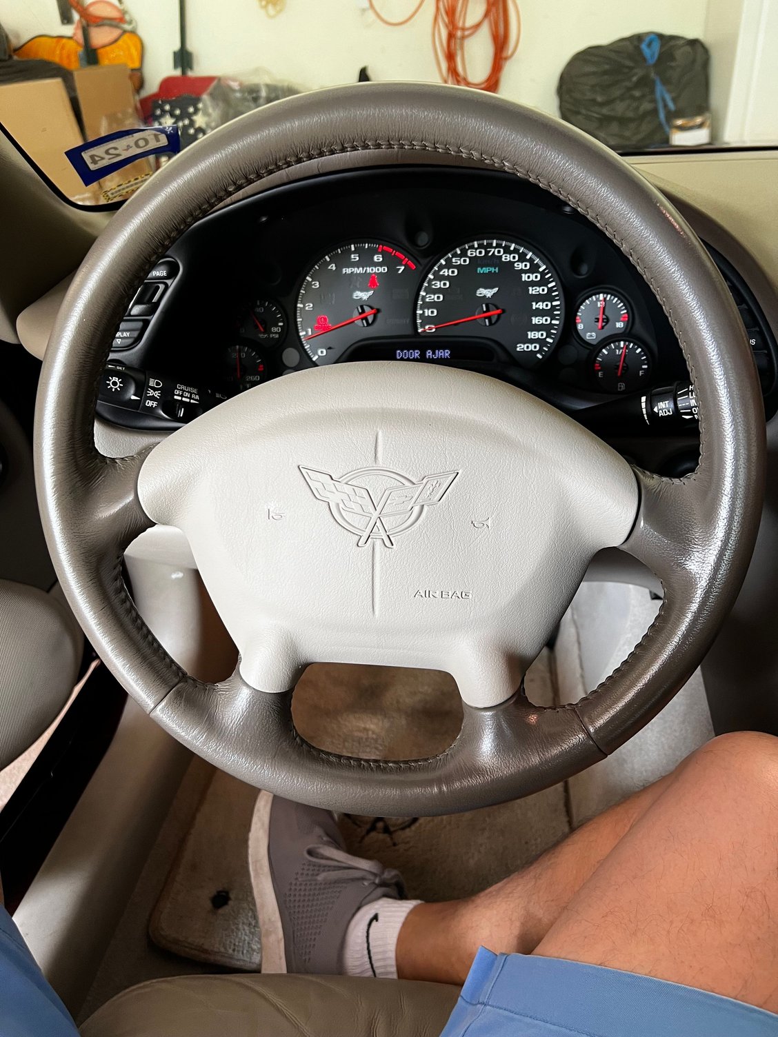

Now you are ready too paint. On the Shale I used “Color Bond 156 GM SHALE”, it matched the interior color perfectly. (On my black one I used VHT BLACK VINYL Dye) FOLLOW THE INSTRUCTIONS!!!! Multiple lite coats 10 minutes apart. Once I get an even coat I am happy with I let it sit at least 24 hours to dry. Now reassemble in the opposite order. DO NOT RECONNECT THE BATTERY UNTIL YOU ARE FINISHED!
Good job but unless you were going for the two tone look, the colorbond medium dark neutral 153 is actually what matches the grip part of your steering wheel...
Old Jul 14, 2024 | 10:54 AM
Karate Kid's Avatar
Karate Kid
Joined: May 2017
Posts: 126
Likes: 142
From: Deer Park Texas
I can’t find that color
The interior is 2 tone anyway and he picked the Color.
Personally I would like to pull it and put the darker color on it. It would be pretty easy to just spray over it with it only being 4 days old if I could find that color but, it’s his car and I think the 2 tone goes with the interior when you see the whole picture.
Certainly looks better than it did.
What do you think?
Old Jul 14, 2024 | 03:19 PM
jdmvette's Avatar
jdmvette
Night Owl for life
Joined: Nov 2003
Posts: 24,679
Likes: 4,526
It sure does match the lighter shale interior parts well. I'm a fan of the darker shade and was able to buy the 153 directly from colorbond on their website

Old Jul 15, 2024 | 01:03 PM
alex04vette's Avatar
alex04vette
Joined: Jun 2024
Posts: 452
Likes: 774
2024 C5 of the Year Finalist - Unmodified
I ran into that same problem sourcing the darker "medium Dark Nuetral". But it's also good to know that the shale color indeed matches well to the lighter color.
I did not strip mine all the way back prior to painting. Just made sure to use alcohol pre-paint.
