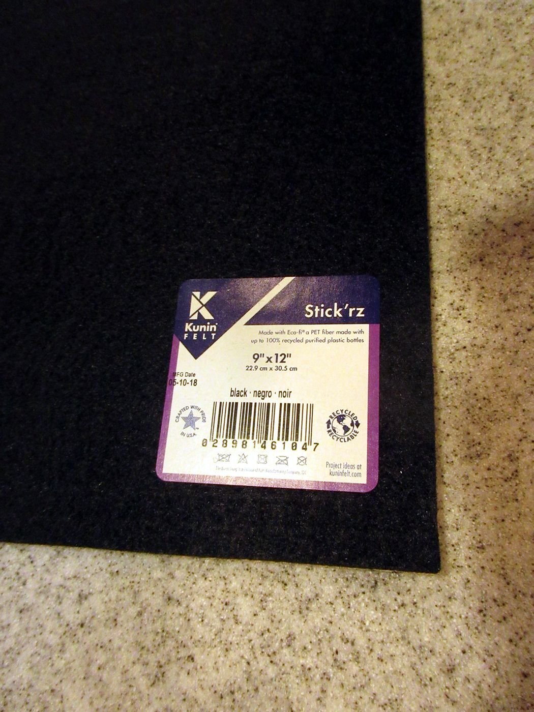

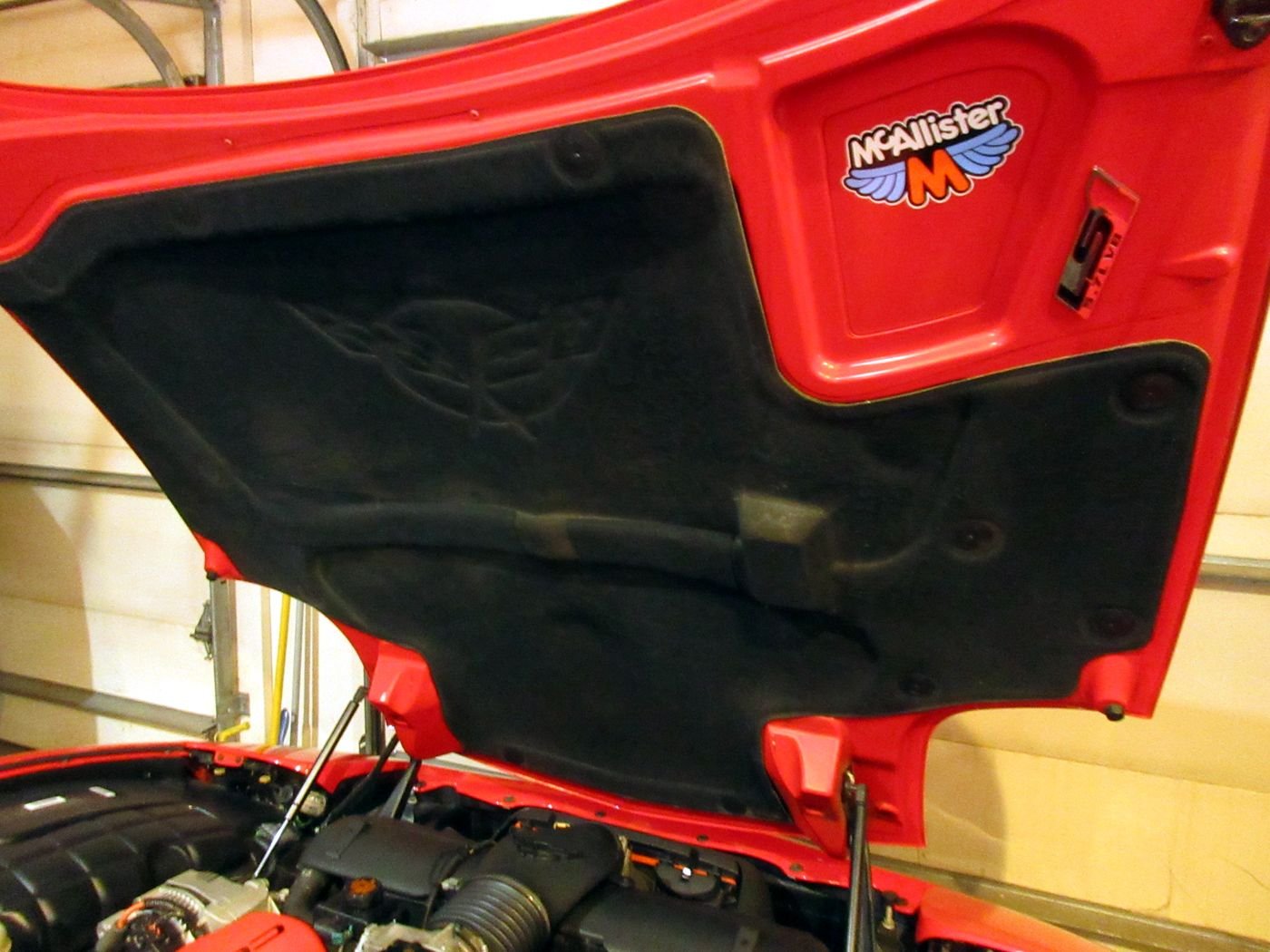

If you have some wear spots on your hood insulation pad, I found a pretty good fix. Mine was worn in a few spots, even had some holes in it. You can find replacement pads for several hundred dollars. However, the rest of the pad is fine, so I went to Jo-Annes fabric store and found some 9"x12" felt sheets with adhesive backing in black. So I just cut some patch pieces so they match the contours and shapes of the worn areas and stuck them right on the existing pad. In normal lighting you really can hardly see the patches. I've driven the car a couple times, and so far they look fine. The 9x12 sheets are $1.49 each. If you have this problem, you might give it a try....

Remember that this is more than an insulator; it is a fire suppression blanket. The idea of the hood liner is that it has a much higher melting point than the plastic plugs so if you have an under hood fire the plastic plugs will melt first, dropping the liner onto the engine and - hopefully - putting the fire out. You can do a Google search not just for Corvettes but cars in general and see how this function works.
Not saying necessarily anything you have done is incorrect. However if you similarly have an underhood fire, the plugs melt, and drop the liner onto the engine the places you have "repaired" with this fabric material will melt first, potentially allowing oxygen in and fire escaping through the liner.

Velocity- Thanks for that info. Definitely a consideration. Doubt many of use would know of that concept. The patches I made are pretty small relative to the overall insulation pad. I'm guessing if you have a fire under the hood that melts the plastic plugs and the entire pad comes loose, the felt patches would be the least of your worries. Your information is good to know before making repairs.

I think a major engine fire is pretty rare, and I hope none of us ever have that happen. I doubt a few small pieces of felt to cover worn spots on the hood liner will have much effect in a major engine fire. But now we have all the facts to make our own decisions. By the way, the patches really blend in better than the pictures even show.
