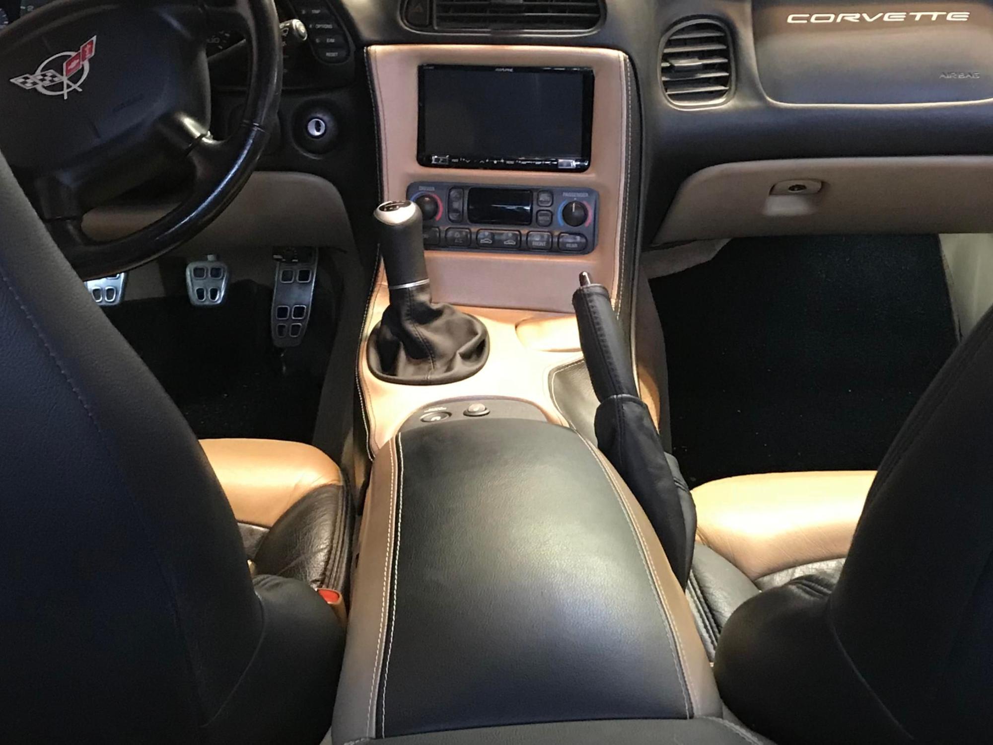

Honestly, you can get by without bolting the HVAC controls to the frame at all. Mine is held in place by the friction of the bezel pressing against the HVAC and it holds just fine.

I just cut off all the tabs and the HVAC just rests between the frame and the bezel as mentioned above. I may have used some foam spacers on the HVAC "ears" to give it some resistance or "push back" against the bezel to keep it snug in place.
If you yank on the HVAC *****, yes it will move. but if you're just pressing the buttons to turn it off and on or move the temp up and down...you'll never notice.

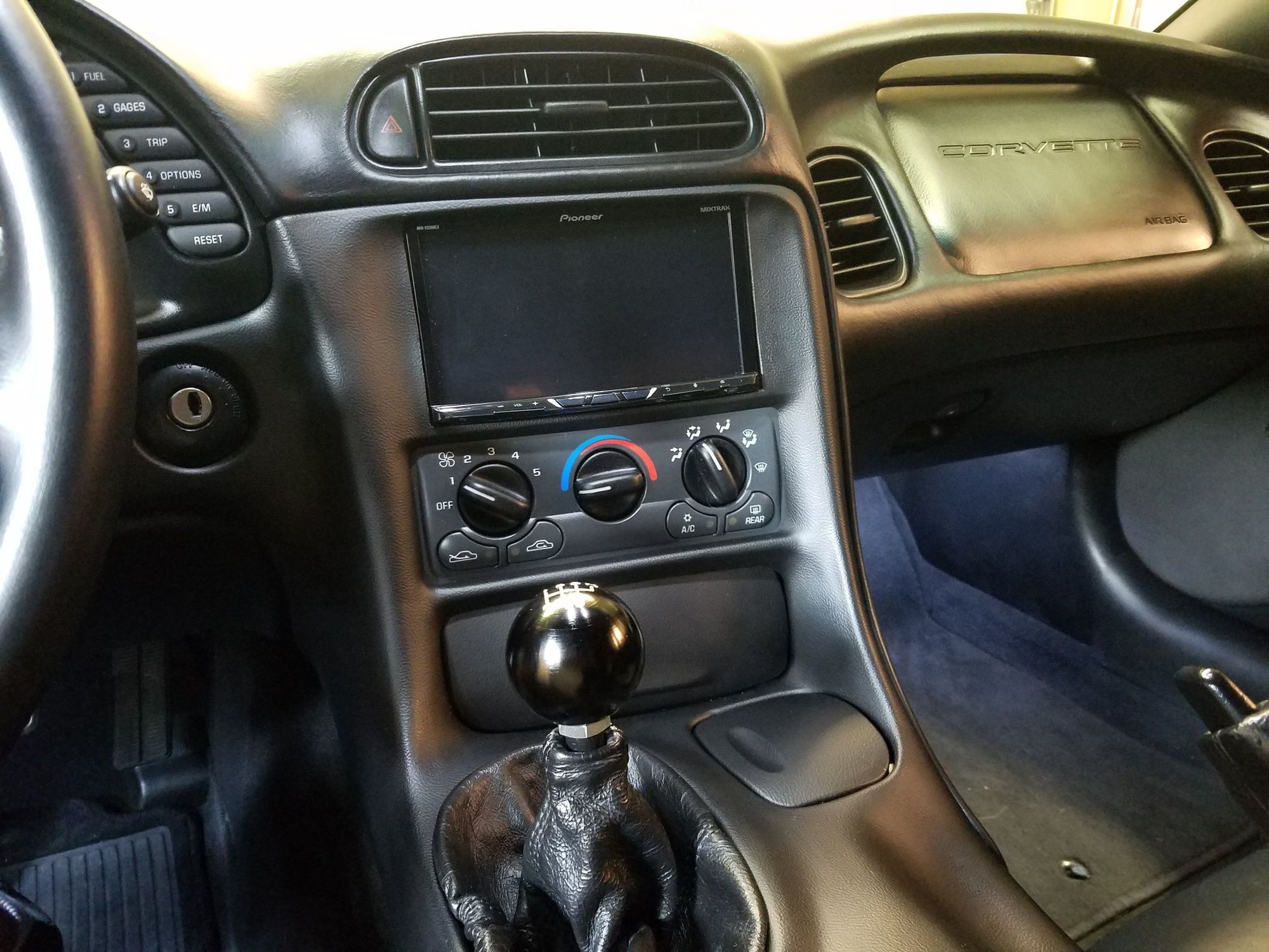

I have the Vettenutts bezel and did NOT have to relocate the HVAC panel. I did have to shim it out a bit though so it didn't have a gap between the face and the bezel.

Picture of finished installation.

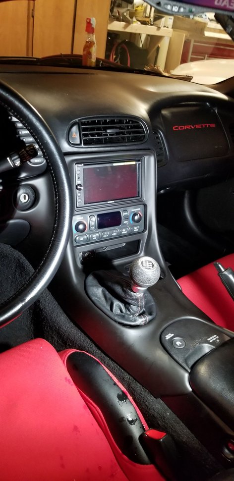

Another picture with the bezel not installed. Point of the matter it fits just fine, and there were no intentions by Vettenuts for you to have to relocate that panel.

I shimmed it out towards the shifter. Not UP or DOWN. It is still screwed to the factory hole locations. I used washers as shims to get it to be flush with the lip of the bezel if that makes sense.
