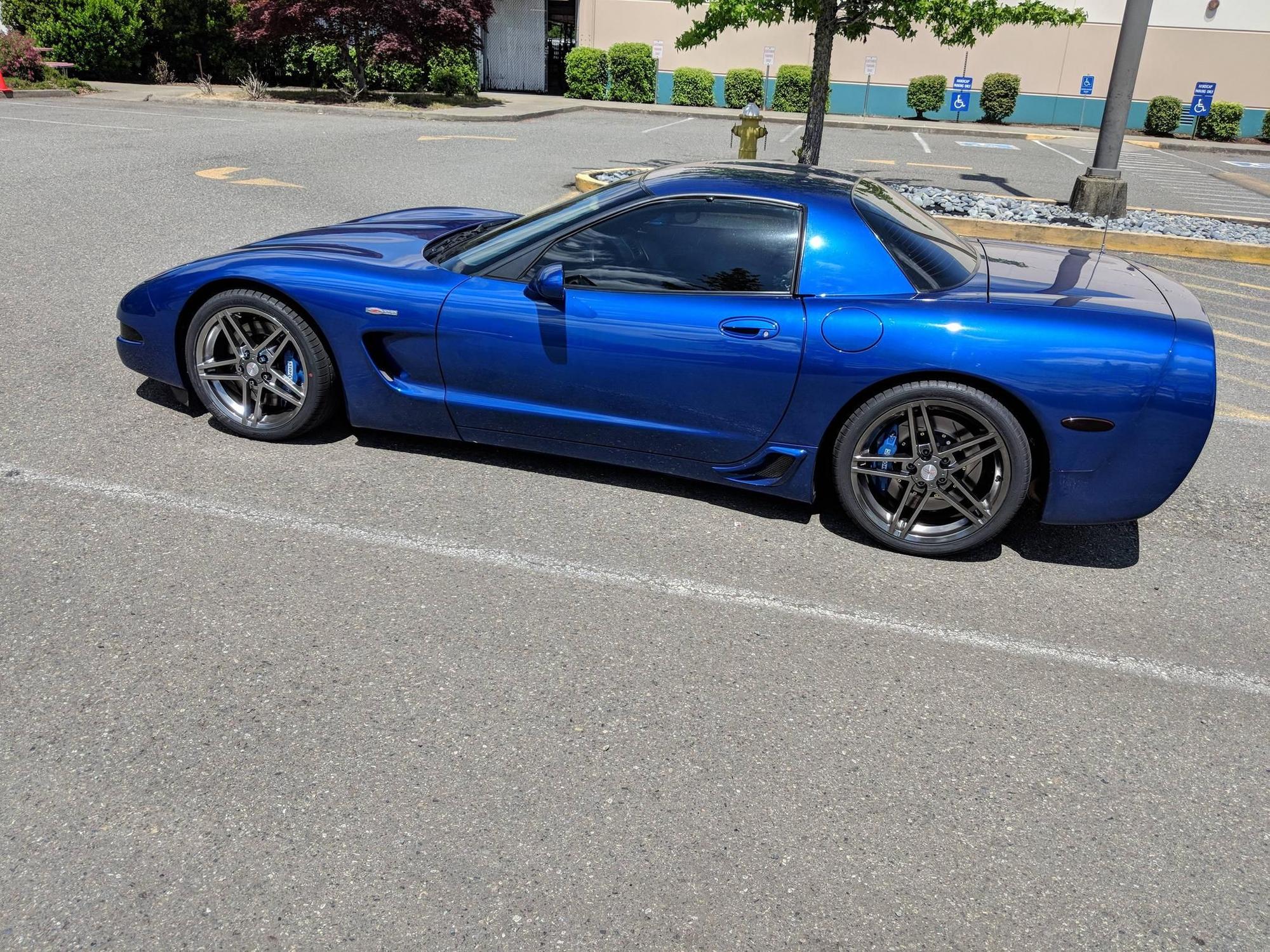

Lots of road course C5s are set up with the same tire size front and rear, and as far as I can tell nobody run into AH / TC issues. So as long as the diameters are getting less staggered, I'd expect no issues.
My current setup uses C6 repro wheels...
Front - 18x8.5, +56
Rear - 19x10, +56
Hankook Ventus V12 Evo tires
Front - 255/35/18
Section Width - 10.2
Tread Width - 8.7
Diameter - 25"
Rev/Mi - 807
Rear - 295/30/19
Section Width - 11.8
Tread Width - 10.5
Diameter - 26"
Rev/Mi - 775
Front has ~5mm poke, mostly because of the 1/2" spacer I needed to clear Stoptech ST-60 calipers
Rear flush at top, slight poked lower down. 1.5 degrees camber, 3mm spacer
The clearance issue is partly due to the wheels themselves, TSW Nurburgings have a ton more clearance.
