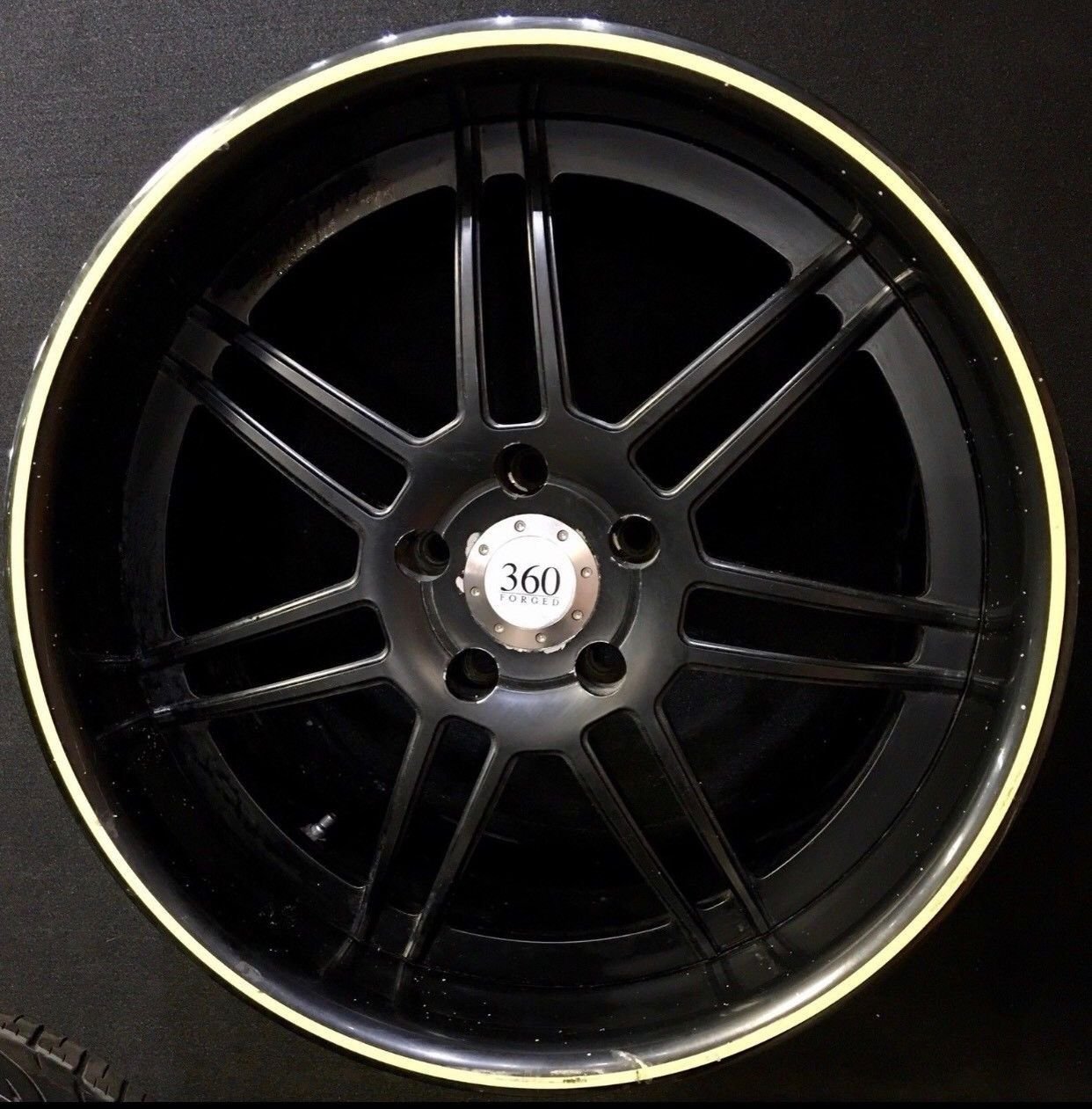

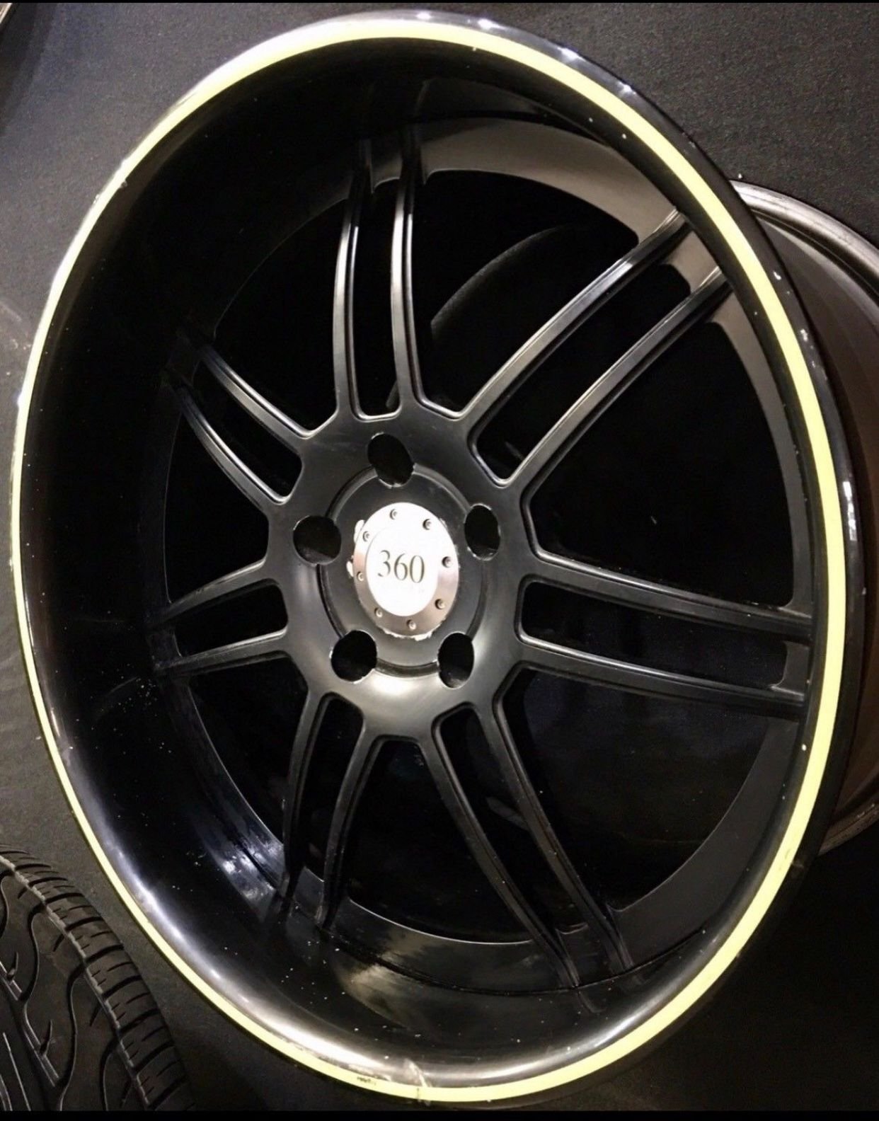

Got a used set of wheels off a yellow C6Z
360 forged 3 piece 7 split
19x12 n 19x14
need to powder coat them
hope they gonna fit 🤞🏻

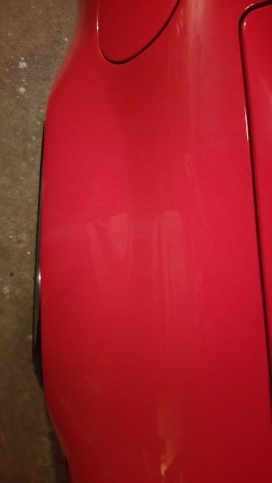

14" wide? Geez, I think you'll need the 2" wide fenders for sure and even then they might stick out. I think the largest rim I've seen on a C5 is 13" wide and that was with the 2' flared rear fenders. C5s look AWESOME with the wide fenders and wide rims. These are Evil Twin's rims
You forgot to post this photo.. it give meaning to the words, 13" is enough.
345/35/19 on a 13 inch CCW 505. Taken from a security lens cam.
Since the distance from the inner hatch wall to the outer quarter panel lip is 11.5 inches, you can not tuck anything under the fender that is more than 11.5 inches, you also need room for suspension geometry ( shock travel ) and clearance ( at least 0.5 inches.) If you want anything wider than 11 inches on a stock quarter panel it will stick out beyond the fender lip.

Im not sure why this simple calculation seems to be so difficult. . But Ill try to answer.. if you think simple, and not try to make more out of this than it is, You may see just how simple it actually is.
The trunk or hatch area of the car is what you see when you look at the back of the wheel well opening. . If you put a measuring device. (Tape measure or yardstick ) into the fender well, and measure out to the lip of the quarter panel, you will see that measurement is 11.5 inches. meaning you can not put any more tire or wheel ( UNDER ) the fender. You can not put more wheel or tire than the area will allow. Now if you add 2 in flares, it will increase this under fender measurement from 11.5 inches to 13.5 inches ( simple math right ? )so If you subtract suspension geometry and clearance, ( 0.5 inch ) you will have 13 inches of area ( Under ) the fender.. Dont confuse back space with this calculation. Backspace only moves the position of the wheel's C/L ( centerline ). It moves the position of this center line of the wheel by its position on the the axle hub.
There is also something called tire section width, and tread width ( two different things ) section width is the widest part of the tire's side wall, tread width is the actual footprint. You will notice some tires seem more square ( section width and tread width are similar ) eg Good Year Tires... However many tires have a wider section width and a more narrow tread width. eg. Nitto tires...
You can not put a 14 inch wide wheel or tire ( UNDER ) a stock quarter panel with only 11.5 inches of available space. Many seem to like the look of stuffing more tire in this space than will actually fit.. leaving an inch or two outside the fender line. ( More susceptible to hitting and cracking a quarter panel due to (suspension travel geometry. ) To me this looks like crap. There has been lots of debate over this look. To me tires and wheel belong Under the fender not some oozing out past the fender. It lacks design integrity. ( Looks like a mistake was made in the selection of wheel size and tire size )But as I have seen many times. people with this look learn to live with it ( So they say ). Some actually do love it.
Hope this makes things simple to see.
This is how a 13 inch wheel and tire should fit completely (UNDER) the fender crown.
there should be enough clearance to allow for rear wheel suspension travel under the fender.
This is how the tire and wheel should look when looking straight down at the quarter panel ( nothing sticking out.
