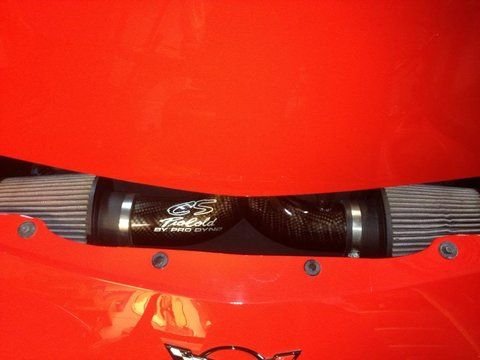

This is duel K&N filters. This is the first thing I did to my car 21 years ago. All I read when these cars first came out was the air box was highly restricted. This was the only thing at the time that was available. Anything is better than stock.

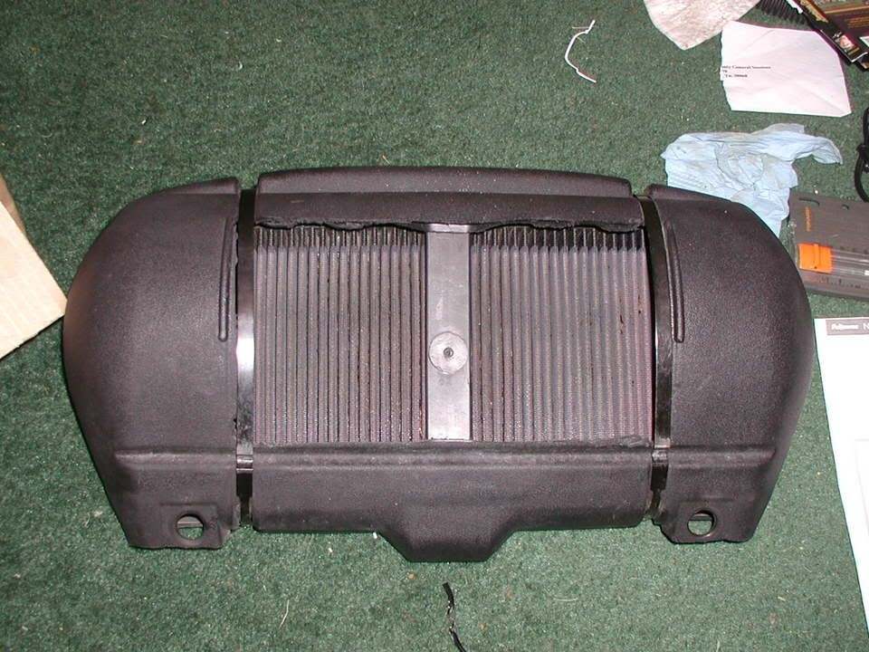

I couldn't come to grips with spending big $$ for questionable power gain for my '02 coupe. So I just opened up the air box and drilled some fresh air holes in the radiator shroud. Also used some foam to partition off the air box from the hot engine bay. No codes or water problems.

Checked out a Vararam in person, wasn't at all impressed with the cheap construction given the MSRP. Went home and did the "zip tie" mod and haven't really thought about it since.
