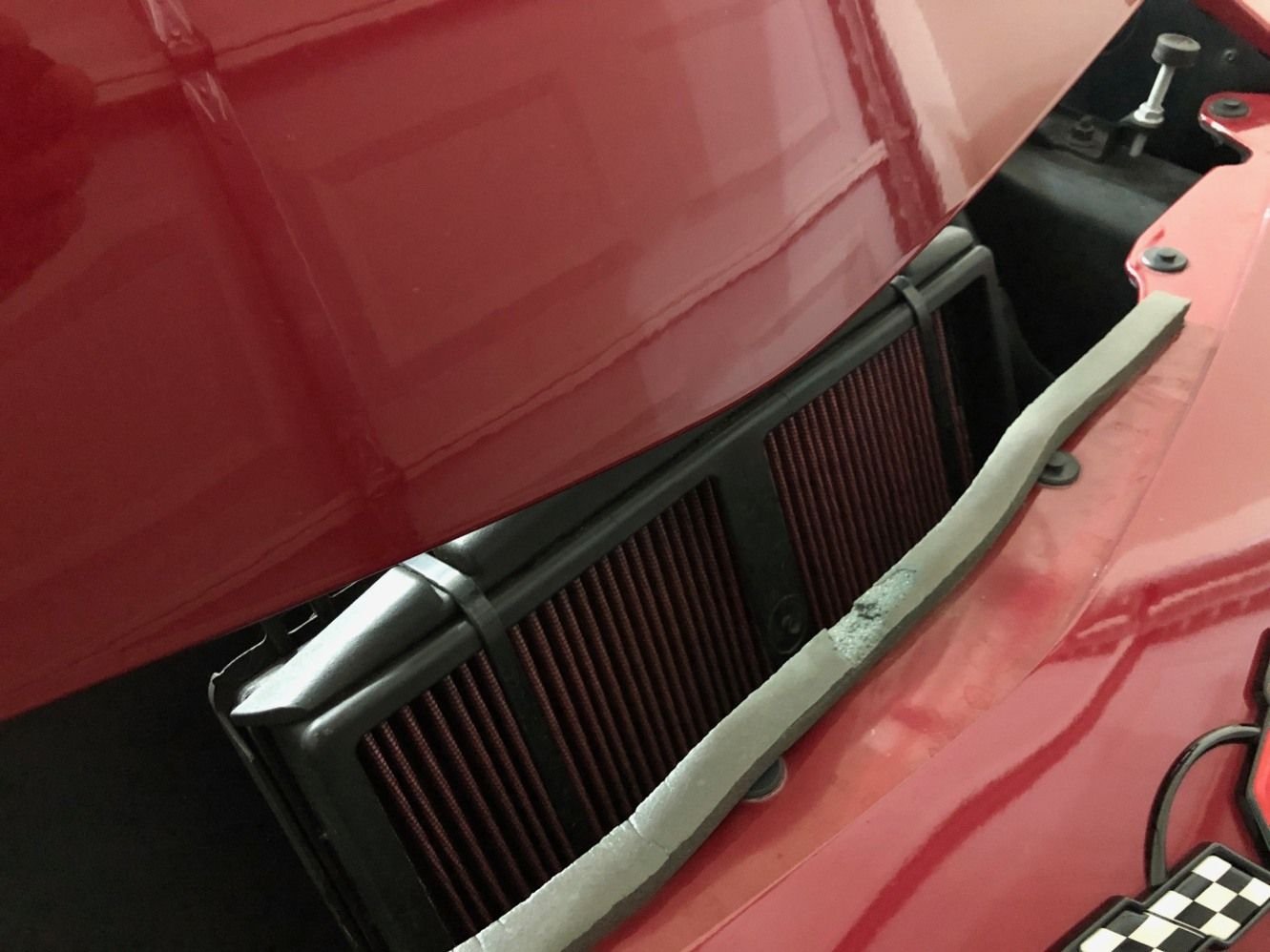

Check again. I had trouble posting picture

Originally Posted by sirdano
Also cut out fog lamp housing
Looks like it was hacked out with a chisel. I'm a little OCD so I like mods that appear a bit more professionally done.

Drilling those 2 inch holes looks like a really good idea. The ram air hitting the spoiler will force some of it right up into the holes. I would never have thought of that. Thanks for the pics and the tip. Looks like another winter project.

Really? The "Zip Tie" and "Flip Tie" mods were pretty popular on here. The ZT mod is basically just removing the top lid of the box and fastening the frame back down with some industrial sized zip ties. The FT mod involves cutting the plastic shroud and inverting the airbox so that air is pulled from outside instead of the engine bay. I didn't feel like cutting any of the plastic up, so instead I spent $3 at Home Depot for a bag of the big zip ties.
Nice. But if you haven't created a means for fresh air to reach the filter, I'm not sure you have gained very much.

I don't disagree. It's louder at least. The way I see it is it should be doing effectively the same thing as a Blackwing or any other air filter setup that doesn't work like a Vararam. Either way, it was $3 spent. The "Flip Tie" pulls air from below the car and is probably better for performance. I know SOMEONE did a dyno test with the flip tie vs. expensive CAIs but I can't find it now. Maybe that was back when I was on Facebook and I saw it there.
Flip tie? What is that? If that refers to opening up the radiator shroud, I agree that would be a good way to go.
