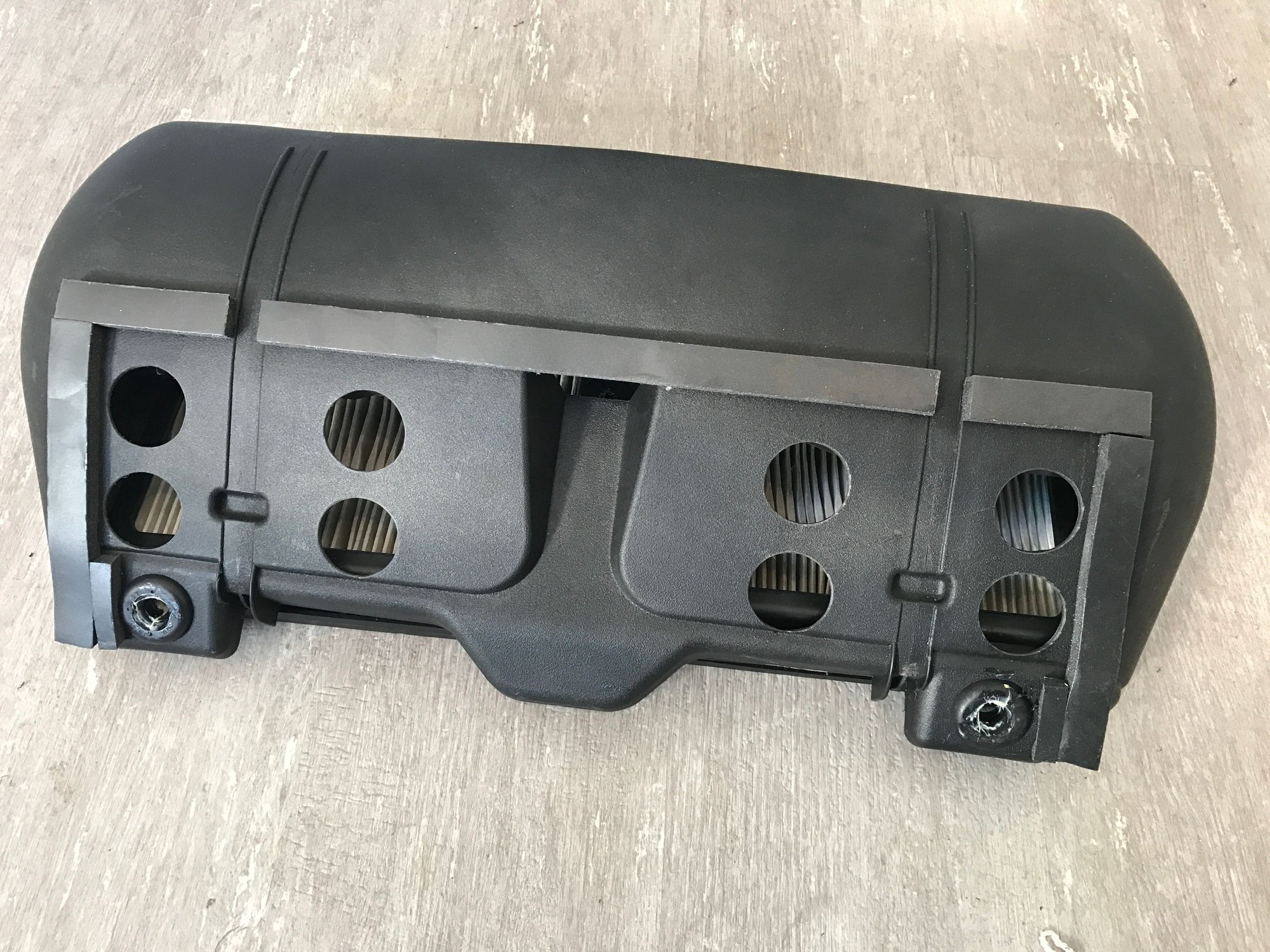

Seen a few threads recently, so decided to write up what I cooked up over the last few years.
Deliverables of a good air intake system
1. filtered air (obviously)
2. minimal pressure drop (restriction)
3. maintain intake air as close to ambient as possible
4. protect filter element from the…. elements
5. simpler the better. the more complex, the more chance of failure i.e. un-filtered air.
My solution is super simple:
Vararam Power duct VR-C5PD
Amsoil EA air filter EaAU4075
Silicone couplers
Experiences
K&N or similar oiled media:
lets too much fine particulate through. This wears the engine, gets in the oil, etc. Stories all over the internet + I have seen it in person on my own vehicles. I have cleaned out several ounces of gritty oily residue from an intake manifold on an engine which used K&N for 30k miles…. I’ve seen it come and go on UOA on my cars as I’ve played with intake systems. NO oiled media filters for my vehicles.
Vararam
super cool design. Uses the K&N style which is a knock-out. Sealing around the filter is so-so; risk of a leak. Complex and bit of a hassle to install. May offer mild ‘supercharging’ effect @ speed. some concern about drowning it when driving in heavy rain.
Flip-tie mod:
Simple. uses stock element which filters well. Decreases sealing around the filer, increasing chances of unfiltered air. Exposes the paper element to water splash etc which it is not designed for.
Calloway Honker:
slick and well made. Uses the K&N style which is a knock-out. Sealing around the filter is only OK, moderate risk of a leak.
Both Flip-tie and Honker:
draws air from under the car instead of front of the car. Maybe this is an advantage but I doubt it. element is more exposed to water splashes etc. At speed, incoming air will be ambient. At stop (light), it is inches away from a radiator/condenser which is often 220f+. I suspect it heat soaks at a light though I did not data log.
Homebrew
Super simple; almost no chance of leaks. Cheap. Great filtration with EA filter. Weighs almost nothing. Good protection from elements. Intakes ambient air from nose of car, same as stock.
I’ve not tested pressure drop across the filter to verify flow restriction; nor have I dyno’d the various setups.
Pics:
Intake is very light and simply rests on the shroud. It can move around with the engine.

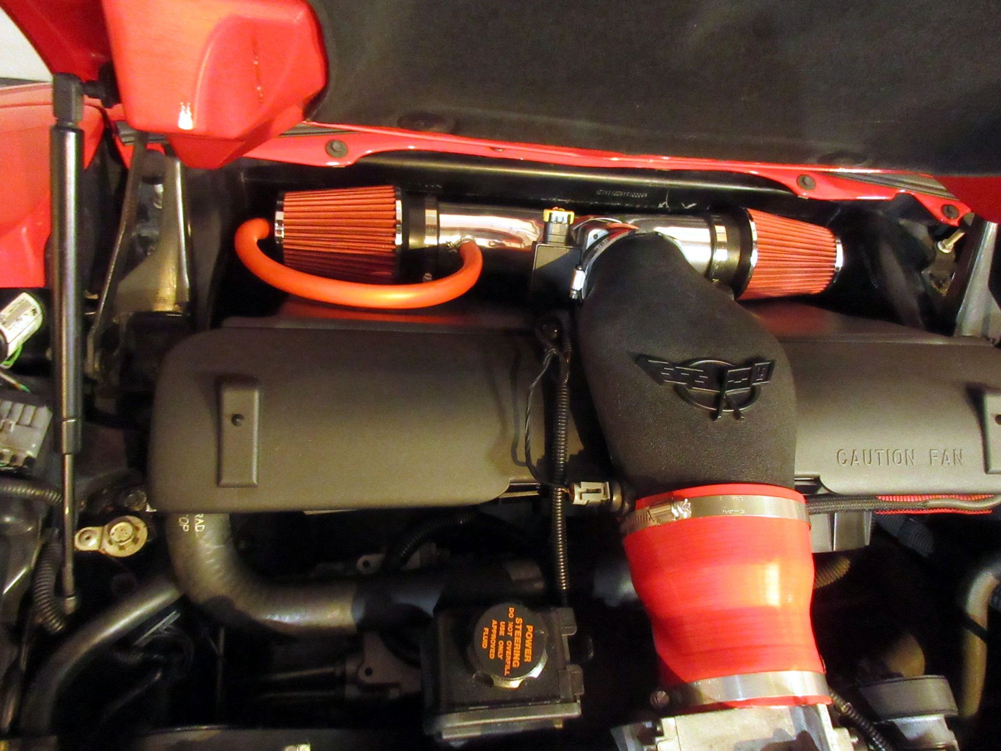

I agree with your thinking. I do like the looks of the dual filters more. I'm also still leaning toward converting the front grills on my FRC to functional air inlets like the Z06. That seems to be a nice solution to bringing cooler air to the intake as well as engine compartment. Not sure if that equates to any advantage, but again, I like the look of the Z06 screens, so I might as well make them functional. The Z06 guys don't seem to have an issue with debris or water with those grill inlets.

This is where Iam on intake so far. Still will do the grill inlets. I'm happy how it looks without mortgaging the house and it's not a race car. I just put the weather strip under the front edge of the hood. Also at 7,000 feet, hot air is usually not a problem.
I also appreciate all the info and suggestions here.

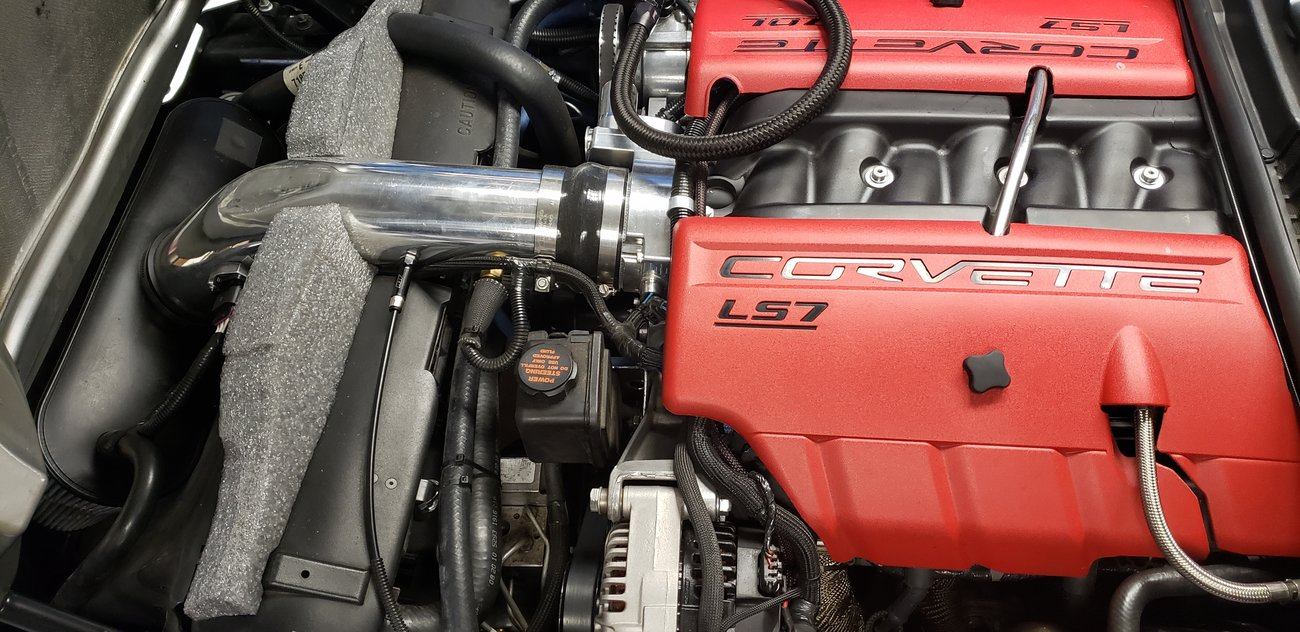

I like your setup, the only thing I might add that I've seen on someone else's car (see pic below) , is a piece of foam that sits on top of the radiator shroud. That way you can isolate/separate the heat from the engine bay and keep it from coming into the air intake area. Not sure what effect this has on aerodynamics though; maybe an aero expert can chime in on this.
See his post here. He said "The foam was in the box used to protect a big TV I purchased. Logging the air intake temp with HPTuners the foam lowered the intake temp around 20 degrees. It is a 440ci big cam and runs hot in the summer, so 20 degrees made a big difference."

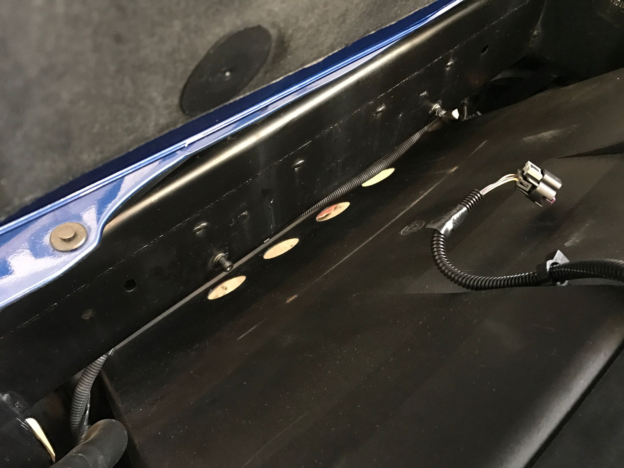

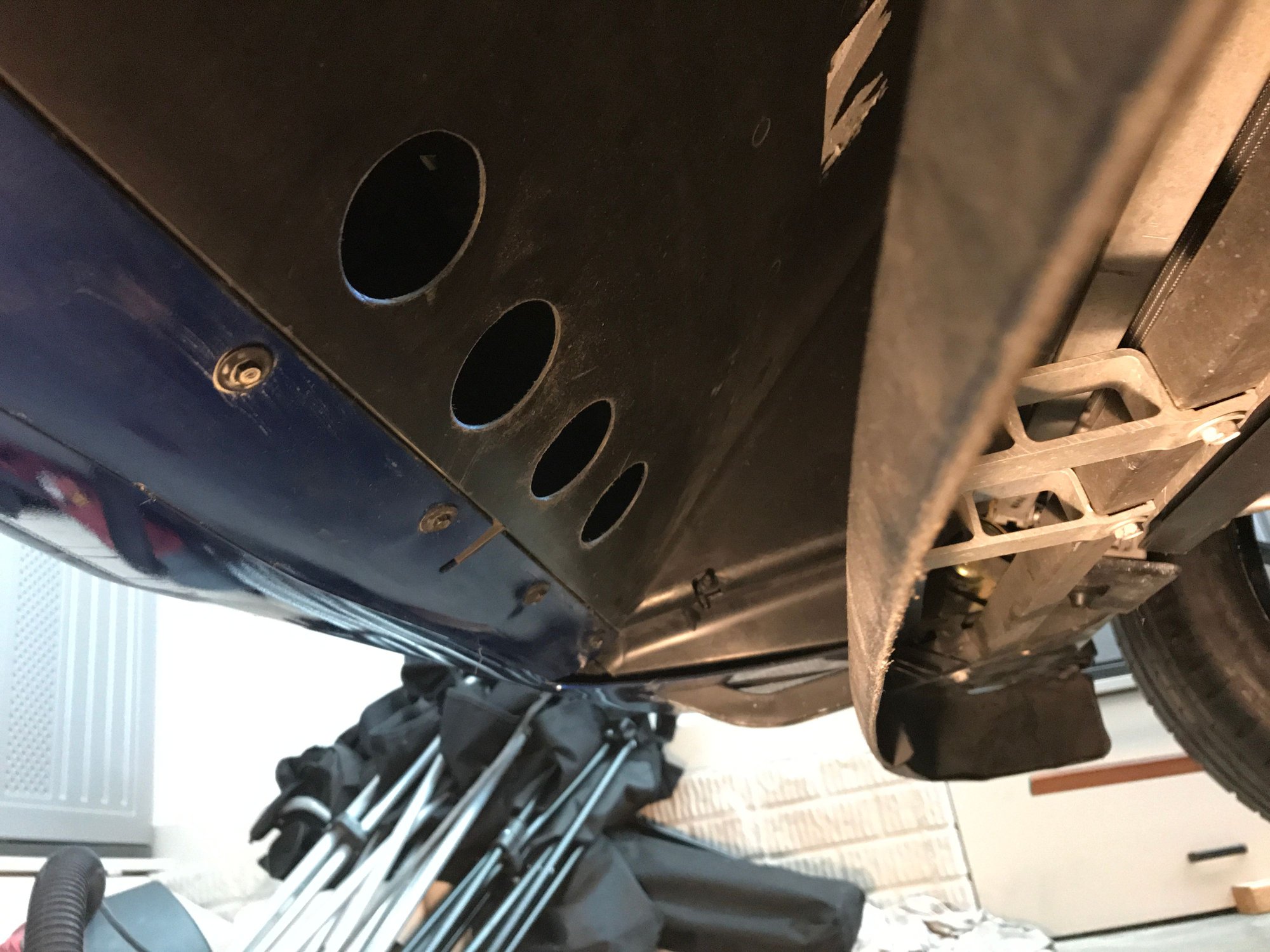

All I wanted to do was provide a good & continuous source of fresh air to the intake..... and I was not interested in the $400+ CAI options. So I just opened up the radiator shroud & and the filter box. The box is blocked off from the engine compartment using foam. No turbulence or other issues. The Z06 air box provides more airflow than std models, so I figured that opening things up couldn't hurt.
