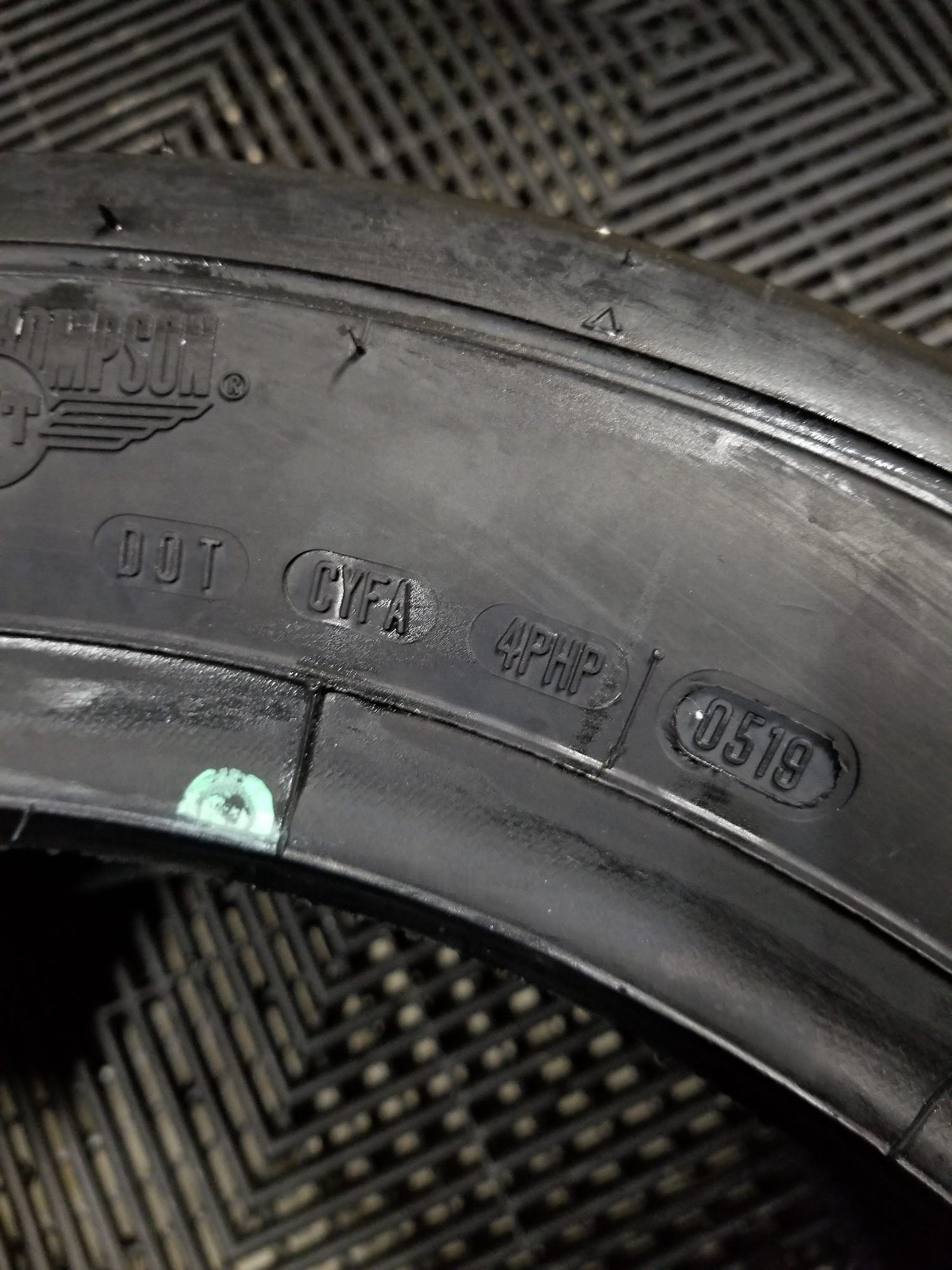

The date code is on each tire usually near the DOT number the date code is in weeks and years. So if you see 0819 that means the tire was manufactured the 8th week of 2019. If it says 2218 that means it was built the 22nd week of 2018.

I just bought some tires a week ago from SummitRacing. The date code is in the little box (0519) Fifth week of 2019. All tires should have this someplace on the tire.
Originally Posted by 1999corvettels1
I went out and looked with a flashlight and on 2 tires could not find date codes, however I did see what I think are some age defects, a ridge that looks like it will rip open one day on front driver's side, rear driver's side didn't have it.
I will definitely get new tires when it's insured and registered again.
