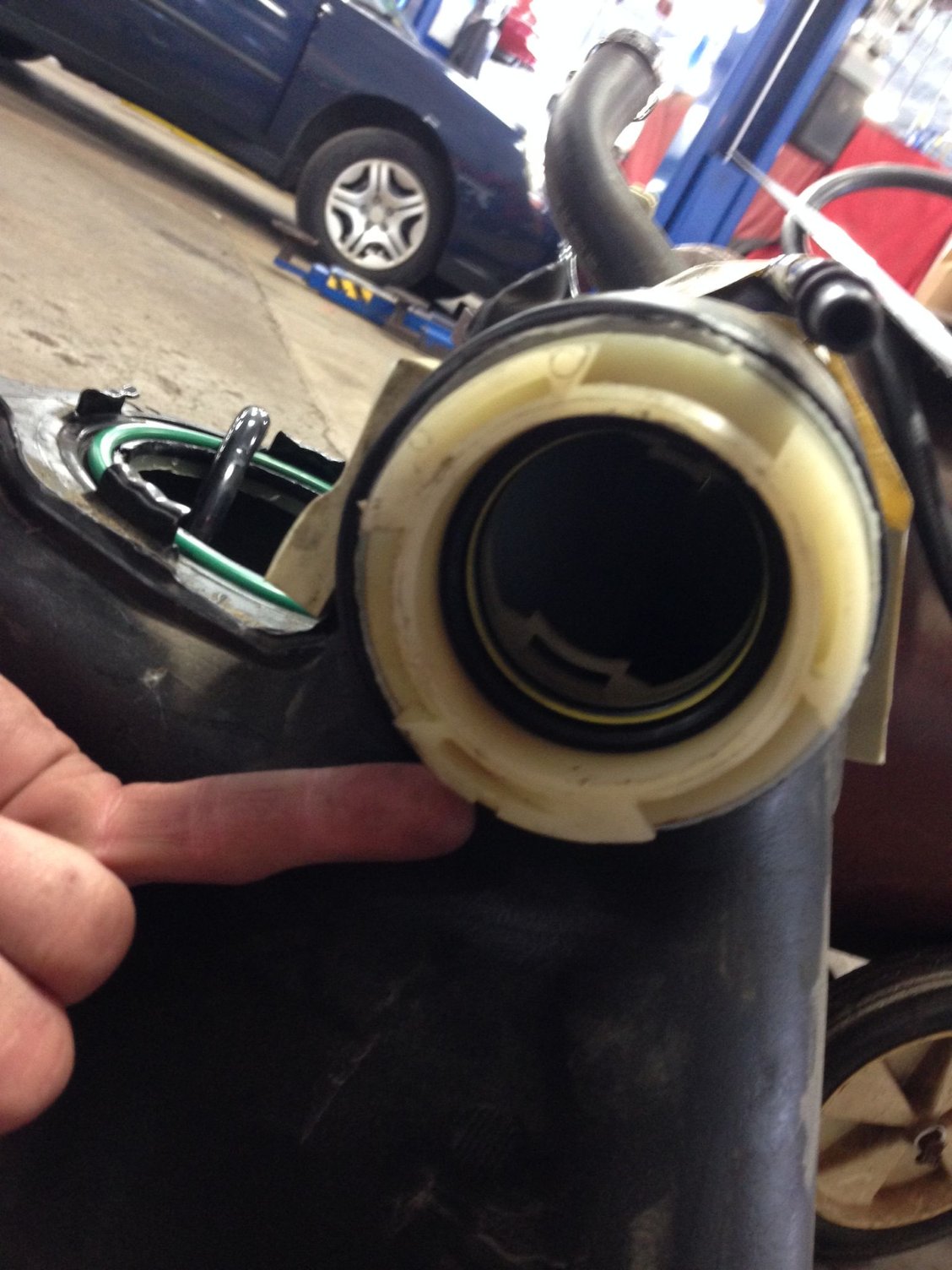

I had the cross over problem on my 04 my car at the time had around 14,000 miles if I remember right and appeared in Aug of 2014 . Dealer did repair and I had a extended warranty which cover cost of repair which at the time was about 2100.00. after repair I had no further problems. I traded car in in 2017. Here are a couple pictures. First picture is of under car below gas fill door and second is the defective part. Go to your local GM dealer with vin of your Corvette they might run a VIS report for you and it could show if repair was already corrected or try a Carfax report.

Here is additional picture of my fuel tank system out of car .
