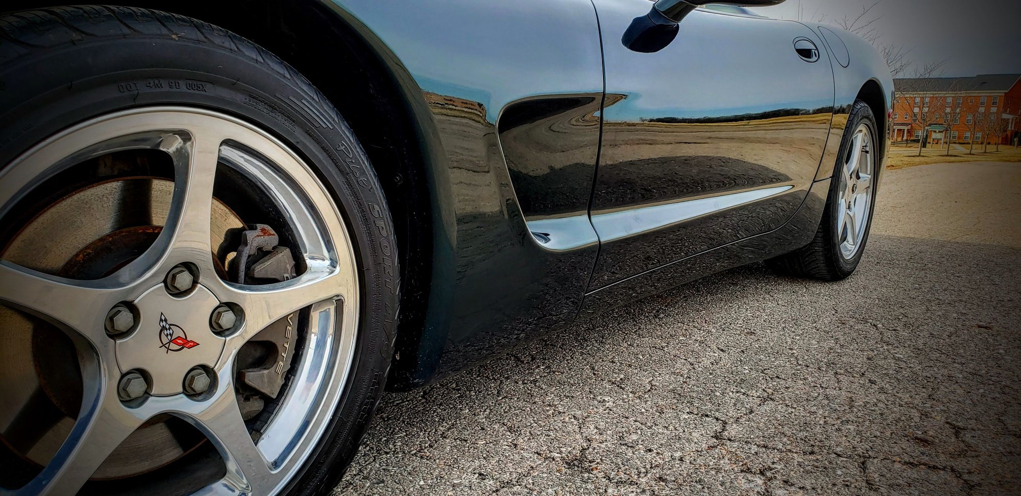

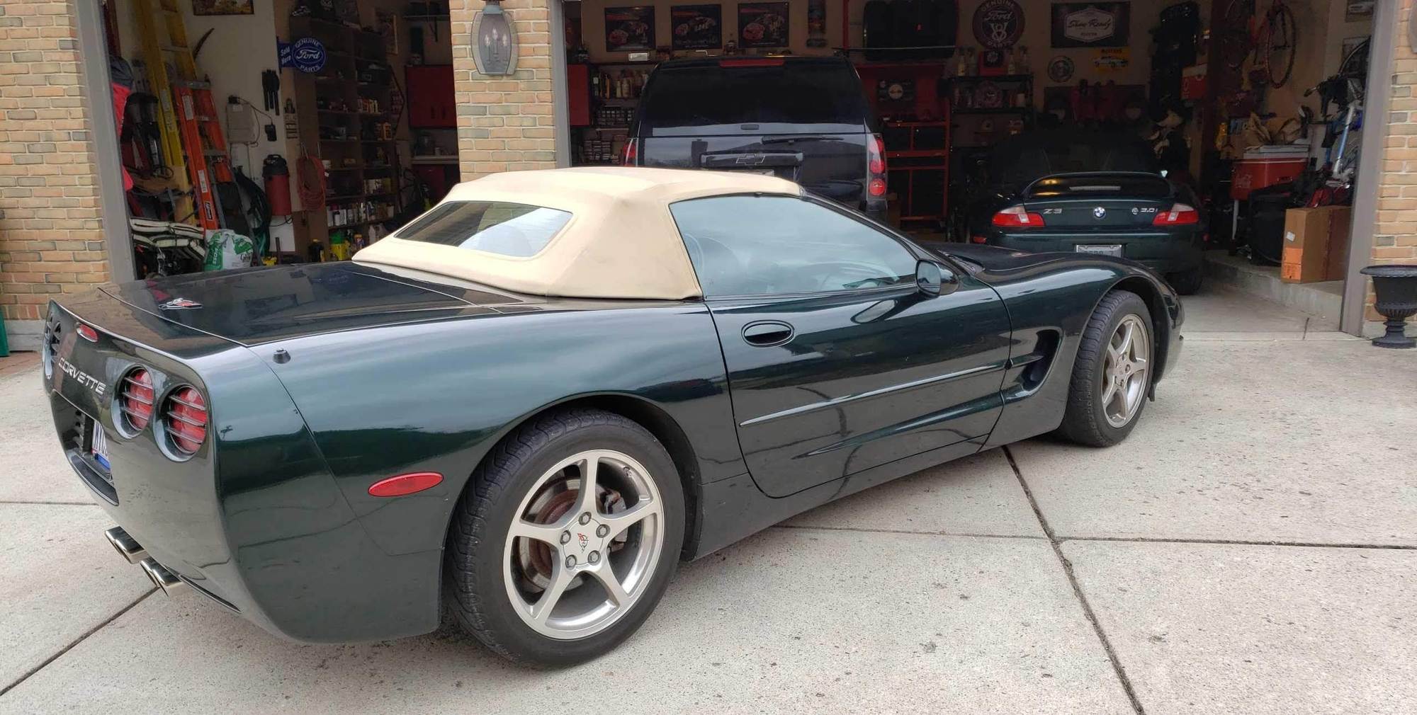

I have had the car for ten days, but I've been reading posts here for over a month in prep for my new arrival. I noticed how much everyone LOVES a question like "Should I remove my body side moldings?" I used the search function on the process, the reasons, the arguments for and against; I then gathered my courage along with the tools mentioned on the already exhaustive threads on how (and why) to remove BSM's. Prior owner had a great wealth of service records, nothing mentioning any respray or touch up of the original DBGM. I took my time, practiced patience and diligence, and Voila! the moldings came off. There was much relief and rejoicing. I didn't think it would make such a BIG difference in appearance for me to remove them, but boy, did the smooth sides make the car look more youthful and aggressive! The moldings came off with no breaks or damage to them, so they are put up on a shelf for safe keeping.

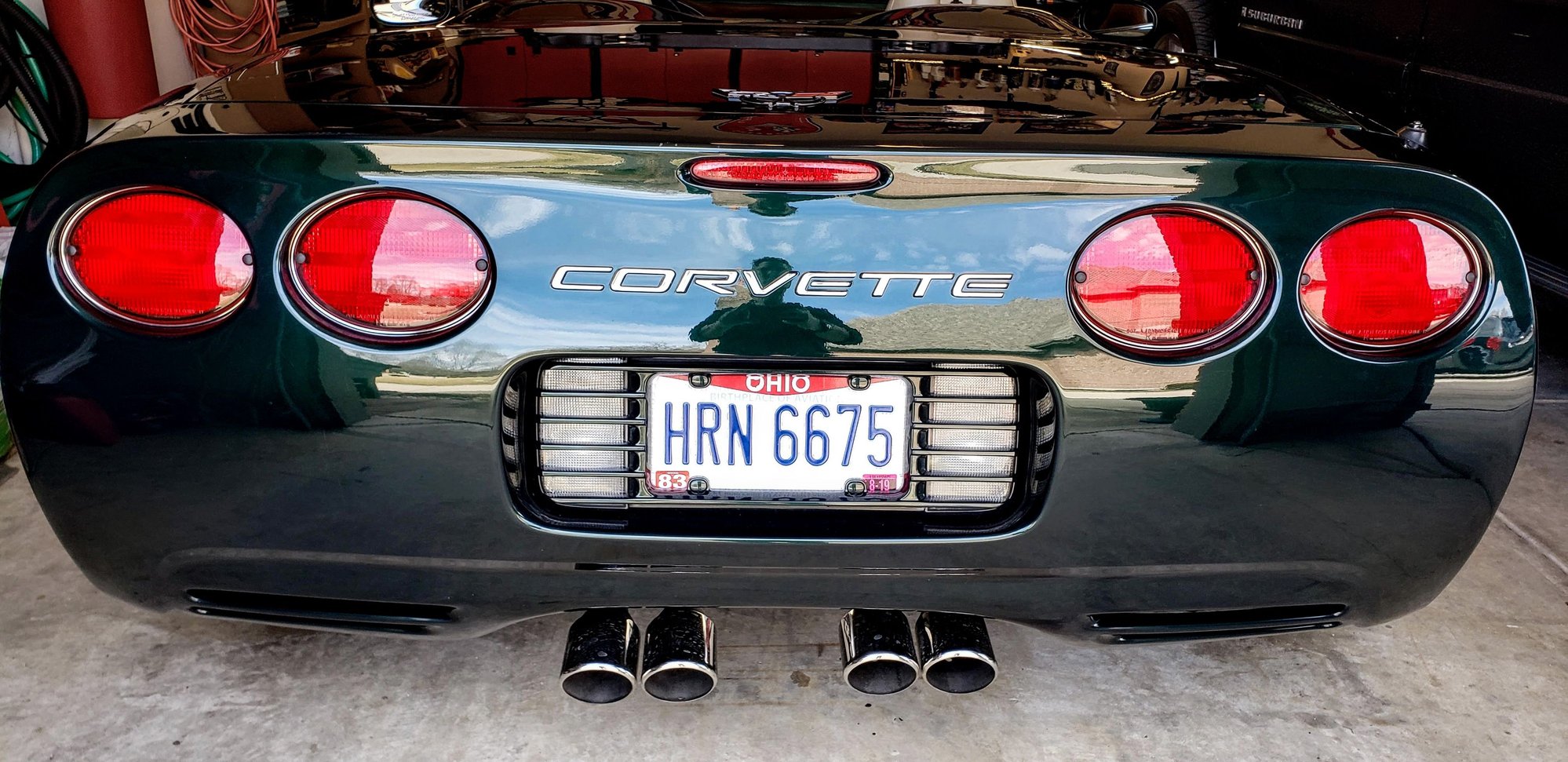

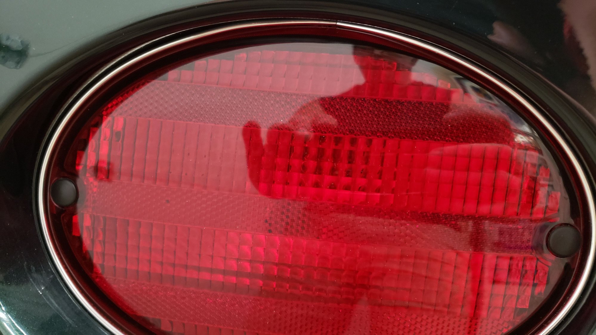

While I was at it, I removed the tail light louvers and applied some very thin chrome trim edge rings around each lens. It seems to pay homage to the C2 tails and is very understated.

Here it is at its new home
Louvers removed from lights, kept the louvered frame on the plate for now
Here's the chrome trim around the lights
A close up of the chrome trim, and added plastic screw caps, too
Here's the BSM before--
And the new clean look AFTER

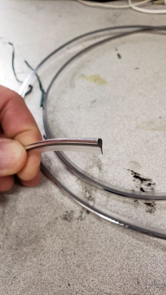

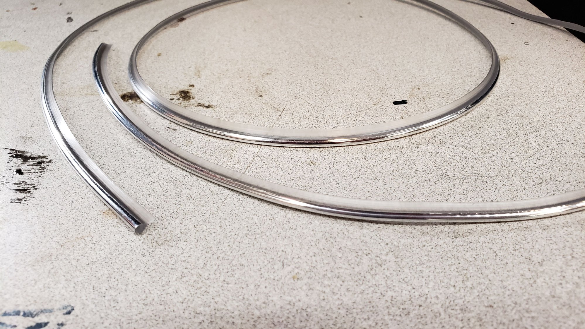

Where did you get the tail light trim rings? I like that style.

The rimgs were made using chrome panel gap trim that I had bought from Autozone or Advance Auto (I know it was one of those) I'm sure that you can find it on Amazon, too. Remove and clean each tail light lens, then measure the outer diameter of the lens. Next put double sided 3m tape against the tab of the chrome trim, and press it down and around firmly against the lens to hold it there. Then reinstall the lens! A great little DIY that isn't your average louvered taillight mod! I think a roll of this trim is about $15 for 15ft
