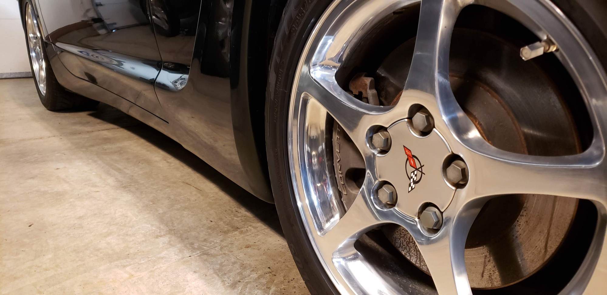

I have had the car for ten days, but I've been reading posts here for over a month in prep for my new arrival. I noticed how much everyone LOVES a question like "Should I remove my body side moldings?" I used the search function on the process, the reasons, the arguments for and against; I then gathered my courage along with the tools mentioned on the already exhaustive threads on how (and why) to remove BSM's. Prior owner had a great wealth of service records, nothing mentioning any respray or touch up of the original DBGM. I took my time, practiced patience and diligence, and Voila! the moldings came off. There was much relief and rejoicing. I didn't think it would make such a BIG difference in appearance for me to remove them, but boy, did the smooth sides make the car look more youthful and aggressive! The moldings came off with no breaks or damage to them, so they are put up on a shelf for safe keeping.
While I was at it, I removed the tail light louvers and applied some very thin chrome trim edge rings around each lens. It seems to pay homage to the C2 tails and is very understated.
The car got a full decon wash and clay, then I did a two-step paint correction and polish. I just need some pleasant weather and we're ready for cruisin'!
Here it is at its new home
Louvers removed from lights, kept the louvered frame on the plate for now
Here's the chrome trim around the lights
A close up of the chrome trim, and added plastic screw caps, too
Here's the BSM before--
And the new clean look AFTER
I finally own a Corvette!!

Great job on the BSM. Glad they came off clean. Without all the gory details, what was your basic technique for removing them?
Well, I started with a heat gun from Harbor Freight and gently warmed them up. That was followed by WD-40 sprayed onto the adhesive and sliding some 30lb fishing line behind it to saw away. As I went along, I inserted a plastic trim pry tool (wide blade) and gently pried apart the molding from the car body. That let me spray the WD-40 onto the glue, and lubricated the fishing line a little bit at a time. The combo of spraying WD-40, then sawing and prying gently as I went down the side of the car, rendered the best results. After the moldings were off, I soaked a shop towel in Goof Off and applied the heat again at a good distance, essentially "rolling up" the glue. My forefinger and thumb are still sore, and it's indeed a task you want to devote some time to accomplish.

Originally Posted by rjwvetttt
I prefer the BSM too and not a fan of the tail light trim rings at all. They look great on my C3 but not for a C5. But that's my opinion only and others may love it.
To each there own.
That's okay, I'm personally not a fan of spoilers, hood scoops, and fairings on a C5, but isn't it great that we have all these options available for our rides to make them what we want?

Originally Posted by Phanni
I don't think those are "magnesium wheels", The early thin spokes were painted, not polished aluminum.
My first C-5 was a 2000 dDark Bowling Green Metallic, a beautiful color.
Mine had the same wheels, and I removed the BSMs too.
Indeed, these are the polished aluminum wheels, except they weren't polished at the time I took the pics(!) We've had only a few days of dry weather around here, and this was my first chance to get it outside after I had done the paint correction. (I save the wheels for last, and so it wasn't 100% done)
I have seen pictures of the magnesium wheels on Bowling Greens, and they are a very nice option!
