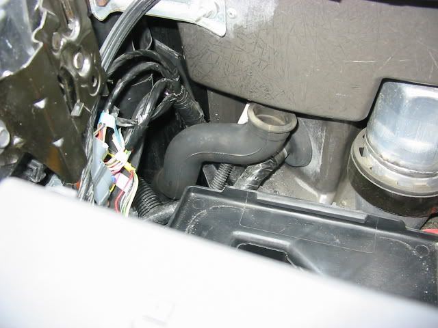

Udder on passenger's side

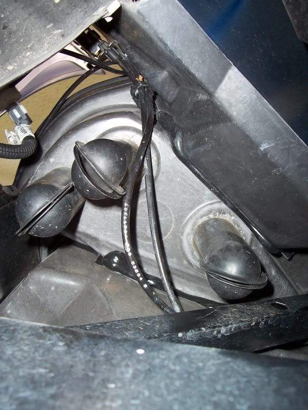

Udders on driver's side
