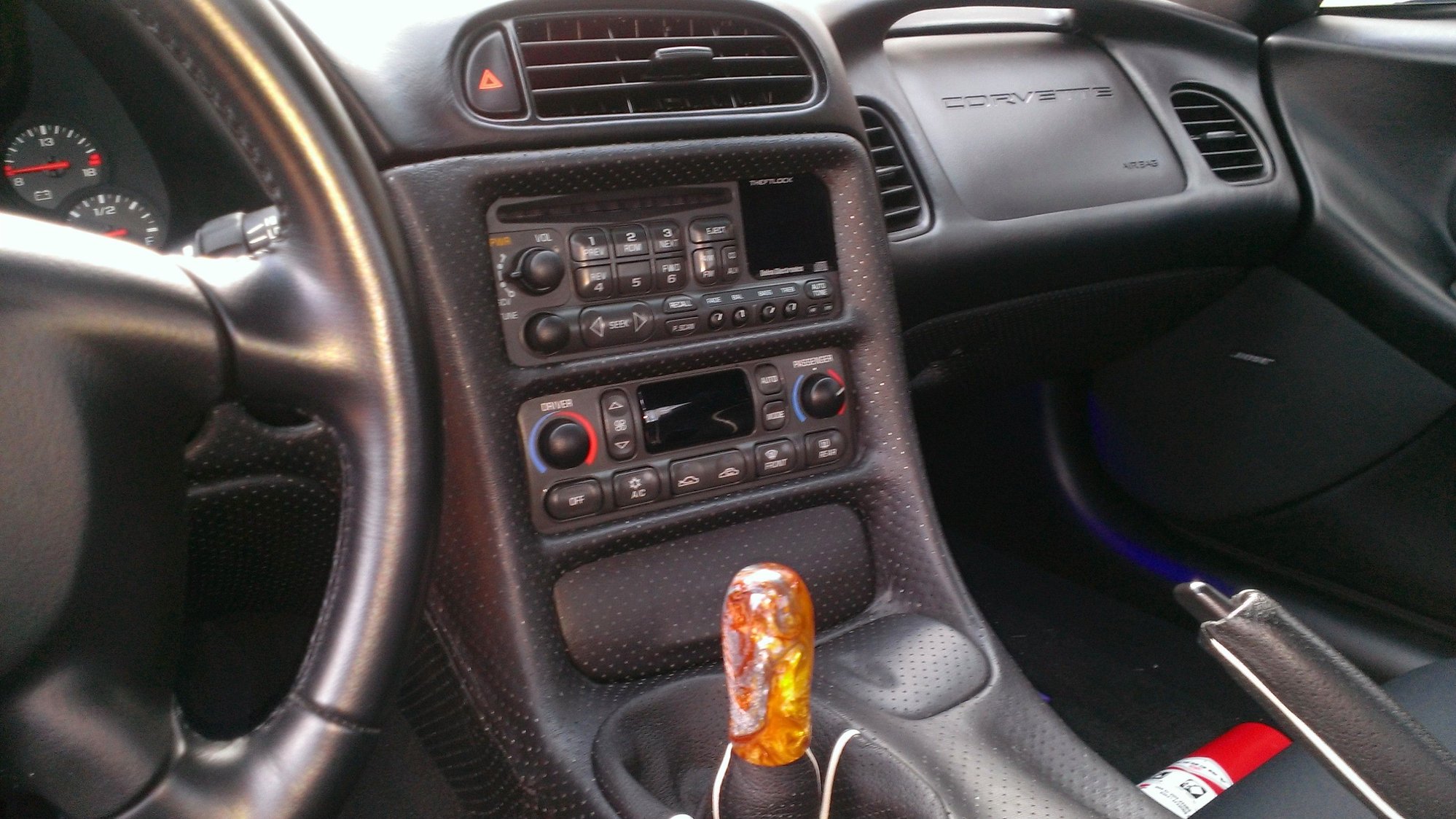

This is the Naugahyde job in my Z06. The seam is in the lower left of the picture. Much easier to work with than wrap vinyl, and if I could find some that matched my current perforated trim, I’d do it again. I didn’t even have a good contact cement at that time. There was some lifting after about a year, but I now know how to prevent/deal with it.
