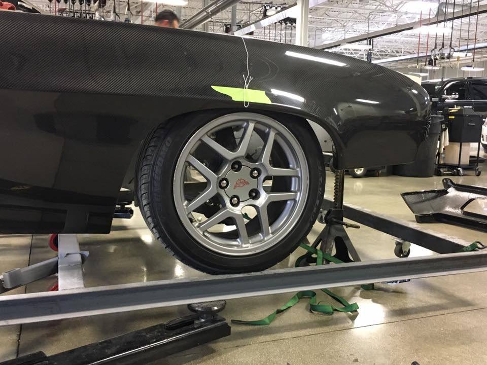

The tire isn't really a concern here, I'm concerned about the rim making contact with the A arms or tie rods and hopefully looking to get a 11" wheel on it so I can run some 315's. If I have to cut the fenders to get a 10" wheel to fit I'm making it worth my time to put a 11" under it.

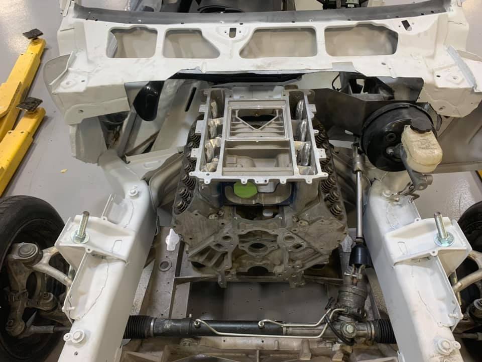

For reference this is the car I'm working on. It's a '69 Camaro with a C5 frame. I have tons of room for tires since I'll have to make tubs after the wheels are measured and fit. Basically I'm trying to not have to cut my carbon fenders. The stock C5Z front don't touch by like 3mm, but when I turn then they make contact. I was hoping just a custom offset would get me what I needed to fit.

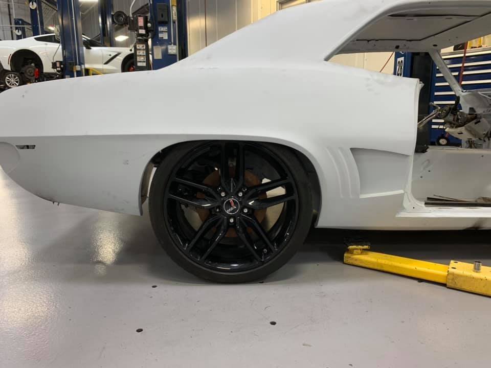

I'm also working on the rear fitment. This is a 20x10 with a 79 offset and it moved the wheel in far enough to not to have to cut quarters so far. Working on more measurements to try and get into a 335, but that might not work without some cutting.

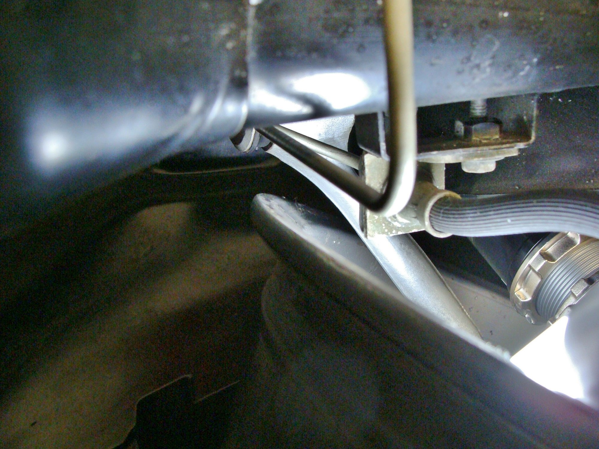

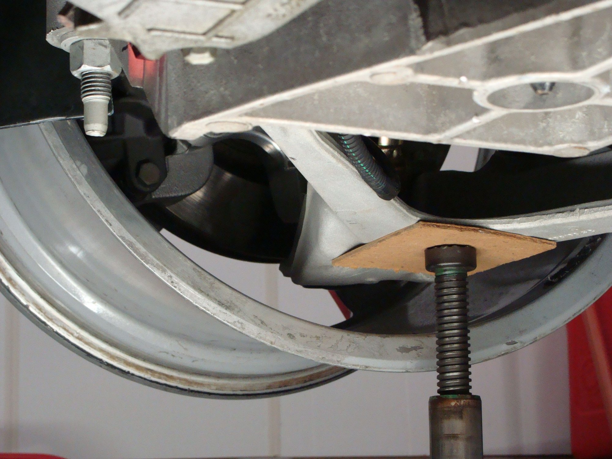

I have a 19 x10 79mm C6 rear rim at home I will try it on this weekend, & get you some pictures, that rim is about 5/8" more backspacing than my 20 x10 with a 64 mm offset which has plenty of room lock to lock.

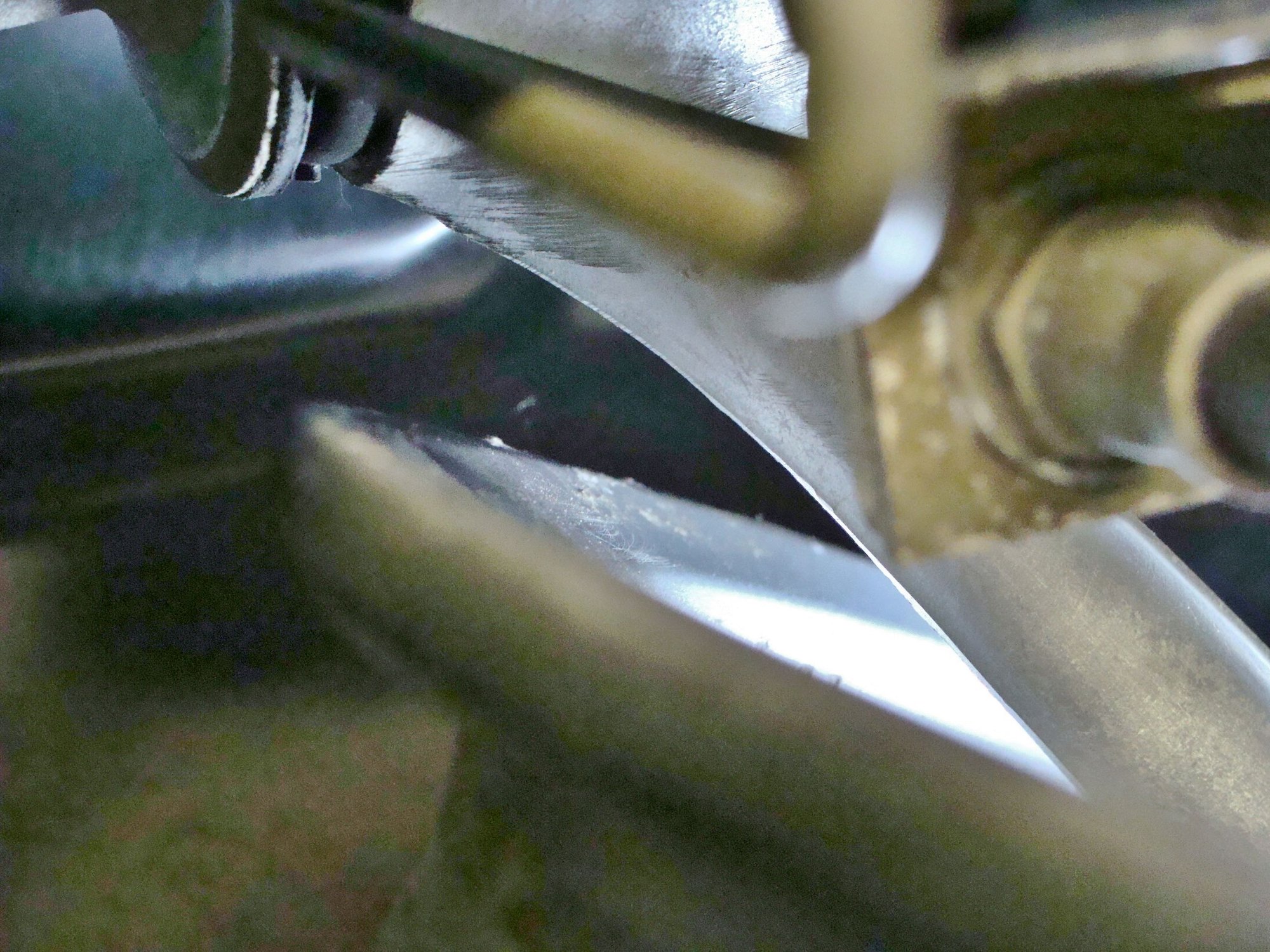

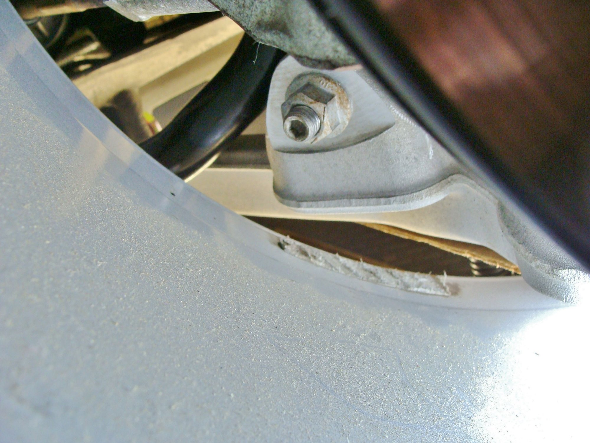

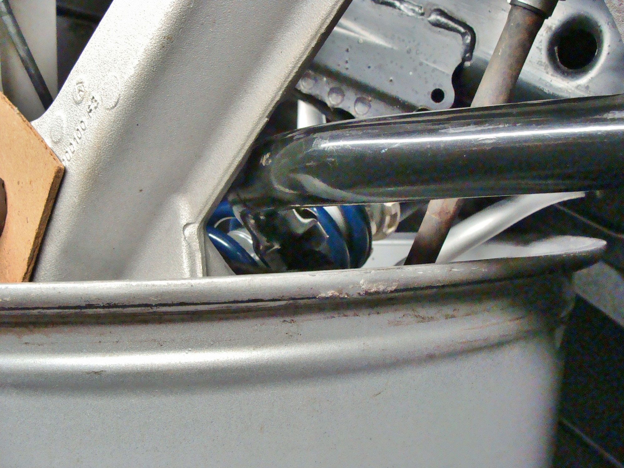

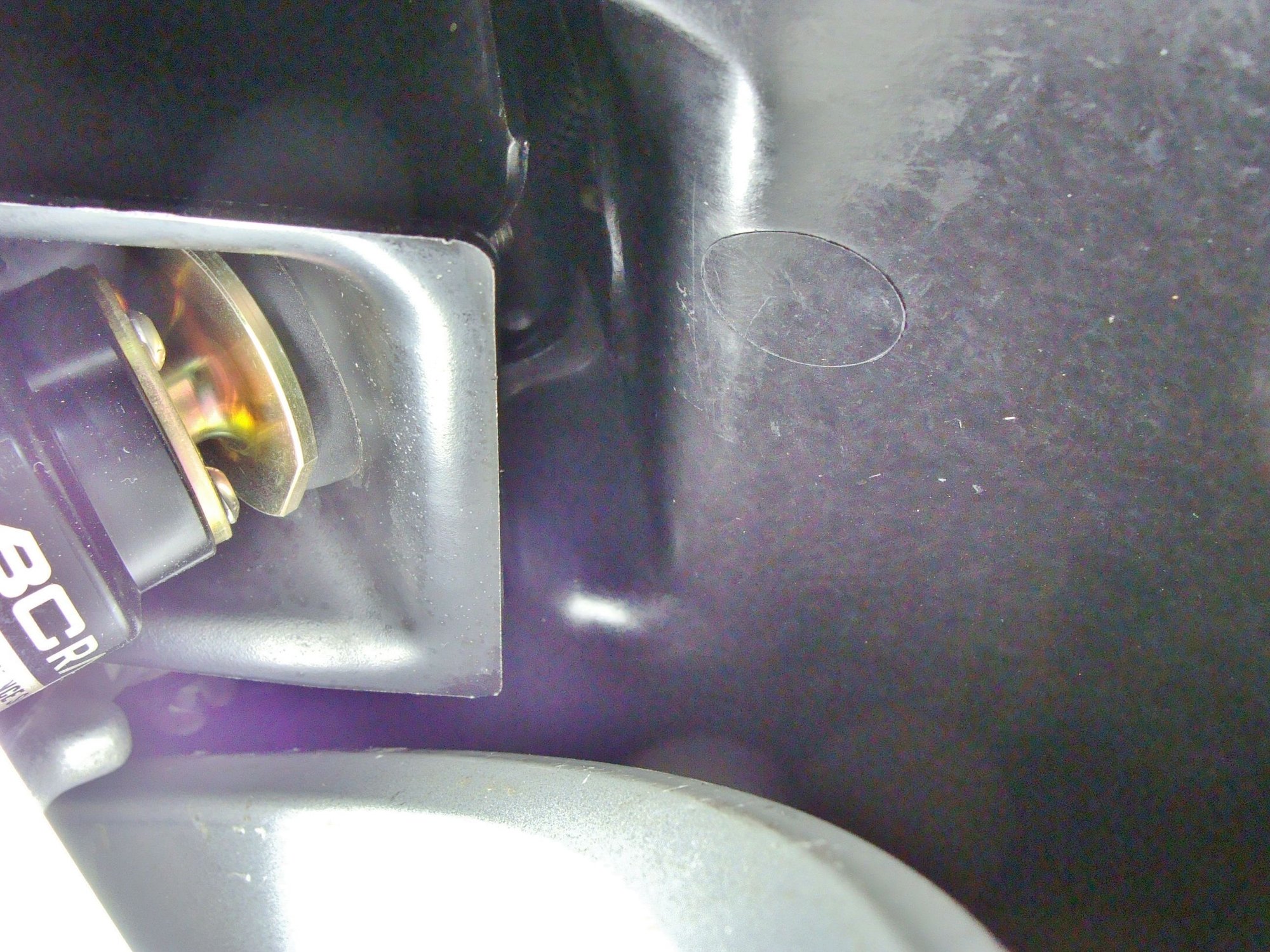

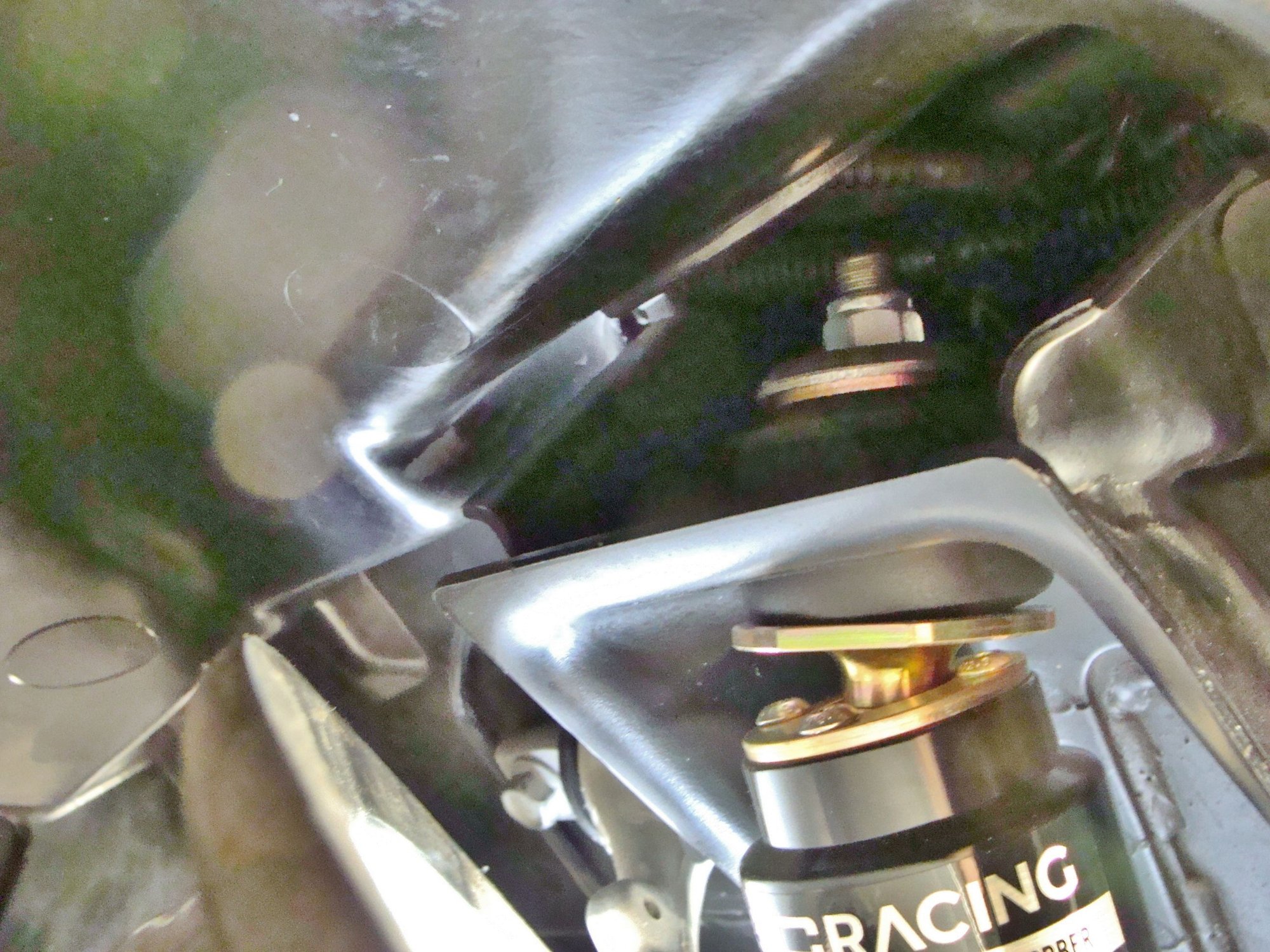

As I promised, 79mm 19 x 10 this is set as close as I could get it to my ride height 1/2" higher than I run, I have 1" drop spindles & with coilovers I am 2.5" lower than stock at the front jacking puck location. As you can see no issues in the front, at the rear it only barely hits the lower control arm, it is not touching the jack at all. The clearance at back of the shock tower at the top is about 3/8"-1/2" I put 3/16" of spacer on after the photo, it still hits the control arm but it is so close to being at full lock.
Old May 5, 2019 | 05:21 PM
CamaroAJ's Avatar
CamaroAJ
Pro Mechanic
Pro Mechanic
Joined: Mar 2007
Posts: 397
From: San Antonio, Texas
That’s bad ***, thank you. Looks like with a tire on it it will hit the frame before the wheel hits the control arm.
