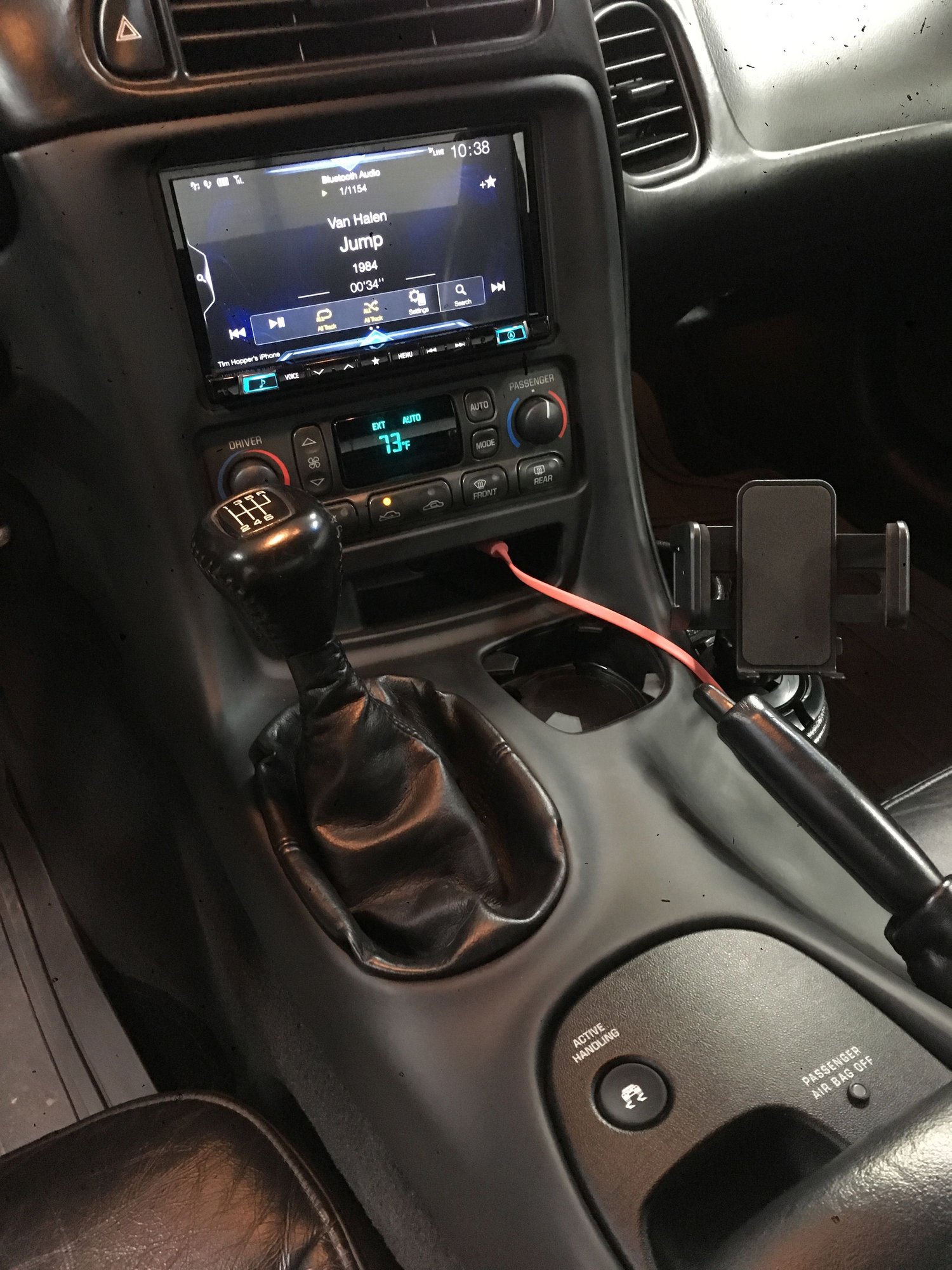

Long story: I've made the move to a double din in my Z06. I've been researching which double din bezel to use for over a year. I ultimately chose the Metra, and I just want to toss my 2 cents into the mix for other researchers. One of the choices for a bezel is to modify the OEM to allow DD to fit. I considered this, but it is labor intensive, and my time is valuable to me. If you pay someone to build you one, you are probably going to pay a chunk of green for it, and have to worry about quality unless they have examples you can see and touch. Ultimately, I eliminated the custom route as too time consuming. The other option is the Vettenuts bezel, which retains the factory look with the drink holder and ash tray covers. Ultimately, I decided the covers were not a primary need for me. Some of you will undoubtedly choose Vettenuts just to keep the covers, and that's your choice. There are two documented issues with the Vettenuts bezel, one being the brackets are inferior. This can be remedied by just making your own radio brackets, which several people have documented as having done with good results, so this is not a deal breaker. The other issue is that some have complained about the plastic divider between the head unit and the HVAC controller warping. Now I can't say whether this is a problem with the Vettenuts bezel or a problem with the install. I will say that if you are looking for perfect alignment of the head unit and the HVAC controller, you are in for some serious tweaking. The Metra kit (which I chose) comes with an alignment tool to help you relocate the HVAC controller, but it did not work perfectly in my case. If you don't get the Head unit and the HVAC unit perfectly aligned, I feel pretty confident that bezel warpage could result. GM did not perfectly align this stuff when they built the car, so be prepared that you may not be looking at a straight bolt-in no matter what bezel you choose. And of course, there is price. Vettenuts is about twice as expensive as the Metra. The Metra is structurally good, feels sturdy, and fits the dash well, but it is NOT a straight bolt-in if you are looking for perfection. I must have pulled either the head unit or HVAC controller at least 30 times making small tweaks, shimming, un-shimming, even re-drilling a couple holes and adjusting slots in brackets with a Dremel. Ultimately, I have the fit that I wanted and am very happy with the result. However, the color and texture of the Metra IS different that OEM. As pointed out by another poster somewhere, GM made these cars with several textures and colors in the interior, so..... The Metra is a smoother finish that OEM, and in certain lighting it appears to be a bit "gray" as opposed to straight black. Personally, this is not a deal breaker for me, but it may be a factor for you, so consider this before you choose. The Metra COULD be painted, but in my case, I feel that is not going to be necessary. It has been said that the Vettenuts bezel is close to OEM finish and color, so this may be a factor in your decision. I'm happy with MY choices, and just wanted to give some food for thought for any who are researching to make their own choice.
Since my Alpine head unit has "CarPlay," I added a USB port in the back of the "ash tray" compartment for convenience. And MGW shifter on order...... This pic is pretty good at showing the different color and texture under LED shop lights, doesn't look quite as gray in sunlight. However, there is no "texture" on the Metra, and the finish feels a bit like rubber. Hopefully this is good information for someone trying to decide.

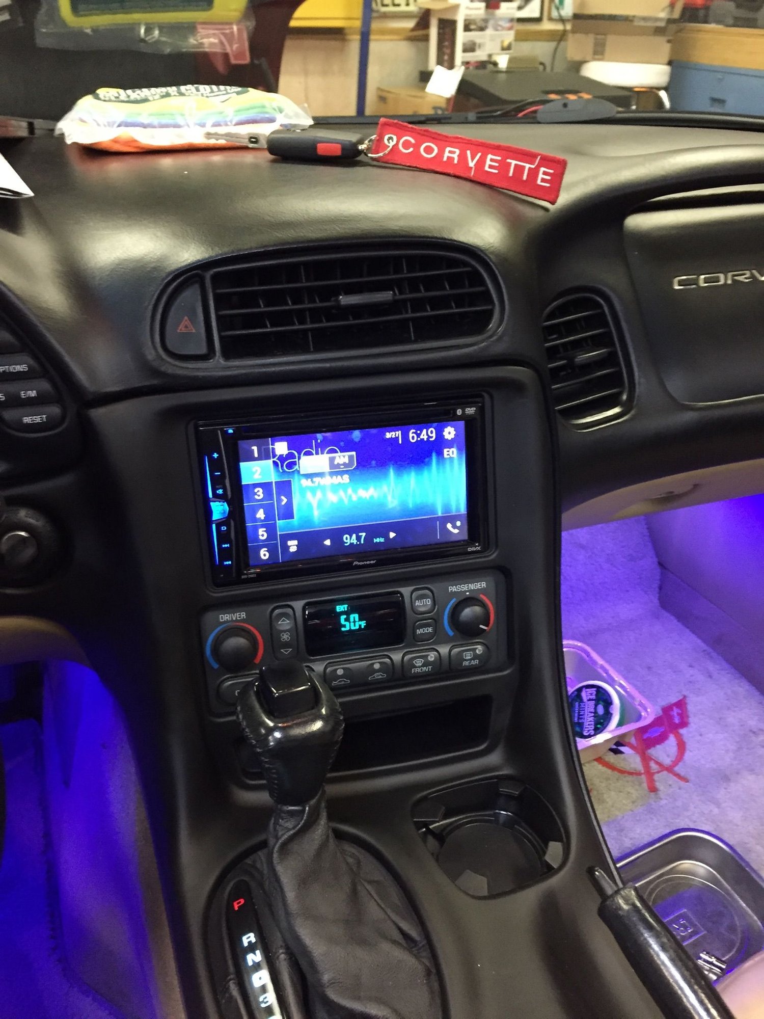

This is my install.

Originally Posted by shaggyvette
This is my install.
whats the story on those lights? that's pretty cool!

Default Foot lights
That is a strip (about 18" long) on each side hooked up to the footwell lights. Color is purple. Gets a lot of comments.
Thanks for noticing.
