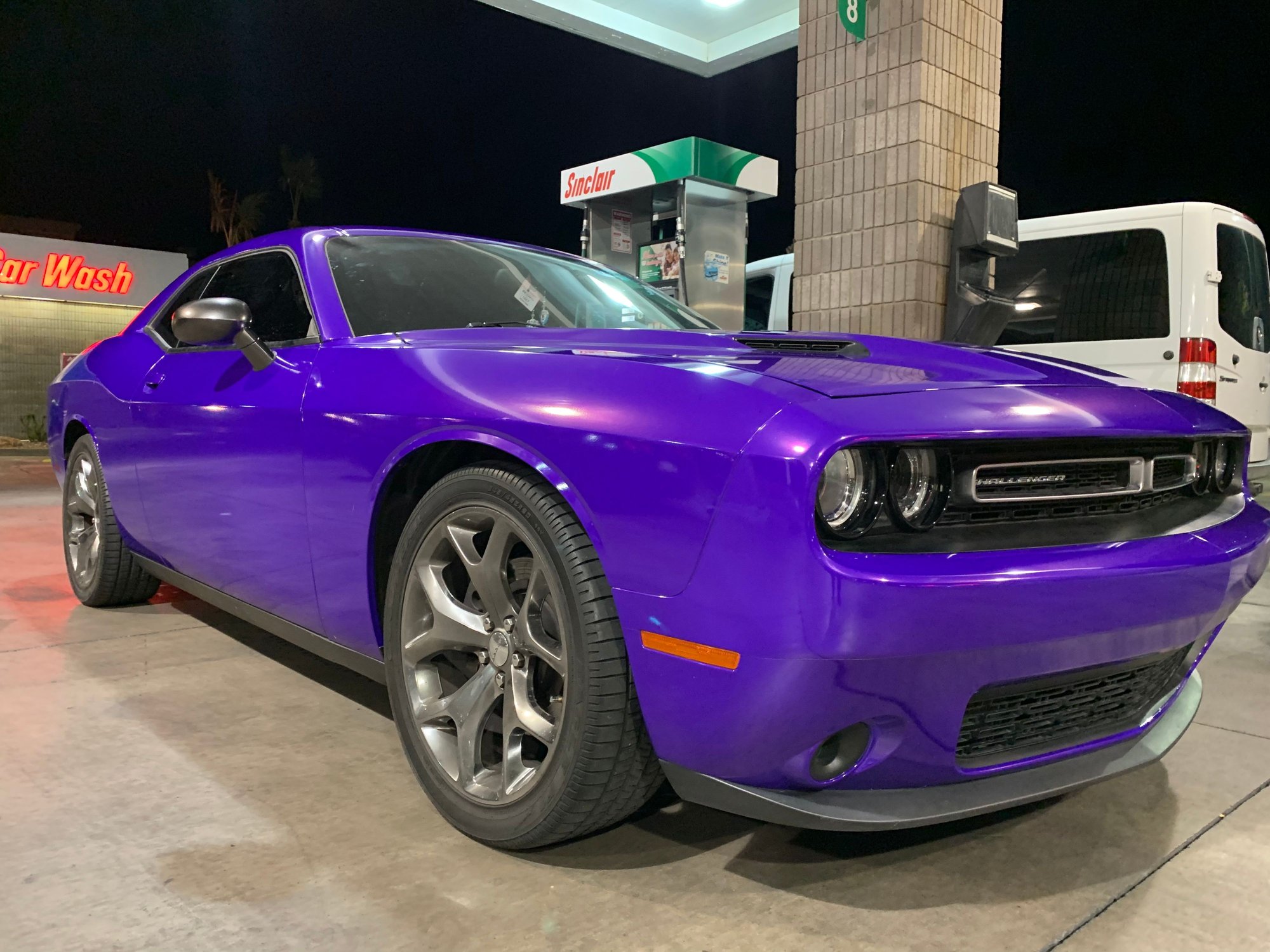

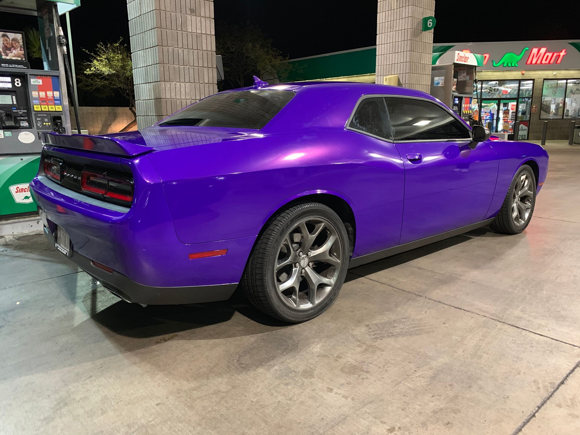

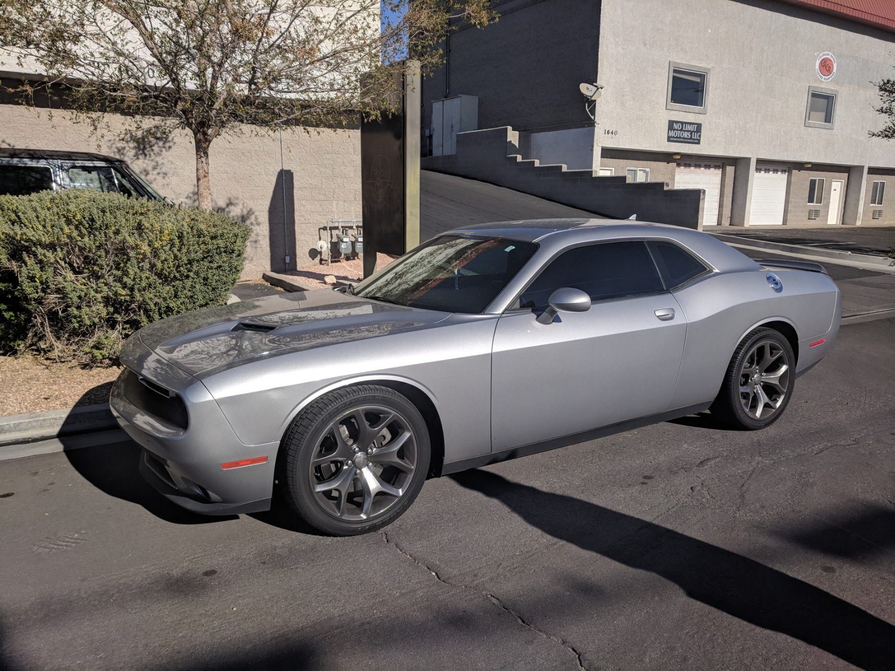

I did my car in 45 ft, VERY strategically, and I left the rear bumper black like the C5R. If you're talking about entire car, 55ft is the minimum and no real margin for error. I didn't do the entire side of the car, as one either. I did the quarter, door, fender separately, and was strategic about my use of material for each fender and used as much waste as possible. If you're doing the full side as a slab, you may need to go 60. Once you've bought 60, there's almost no point in buying anything less than a full roll, in order to have repair material. I did indeed, do my car in 3m satin white pearl in 45 though....car below. I also did the top in one piece with only one seam in the back centered behind the window. I've seen shops do it in two...essentially the shaped top part, then the base, with the seams, where the base meets the top and goes upward.
If you've never wrapped before, you're picking a tough car to start with...the front bumper is tough, the top is tough, and the fender coves can make you overstretch the material. Talk about a tough front bumper though...that stupid challenger I did below...whew...what a *****...

I did the whole side as one on the Challenger just simply to avoid seams anywhere, as the quarter, B and A pillar are all one metal piece, so seams compromise the look. Naturally then the door gets done in the process. I have done cars without doing this, and frankly the seam doesn't offend me and no one generally cares. If you seam things, then replacement becomes less of an issue and you're over it.
I seamed my gf's old BMW right at the rocker/B pillar and no one ever knew the difference
