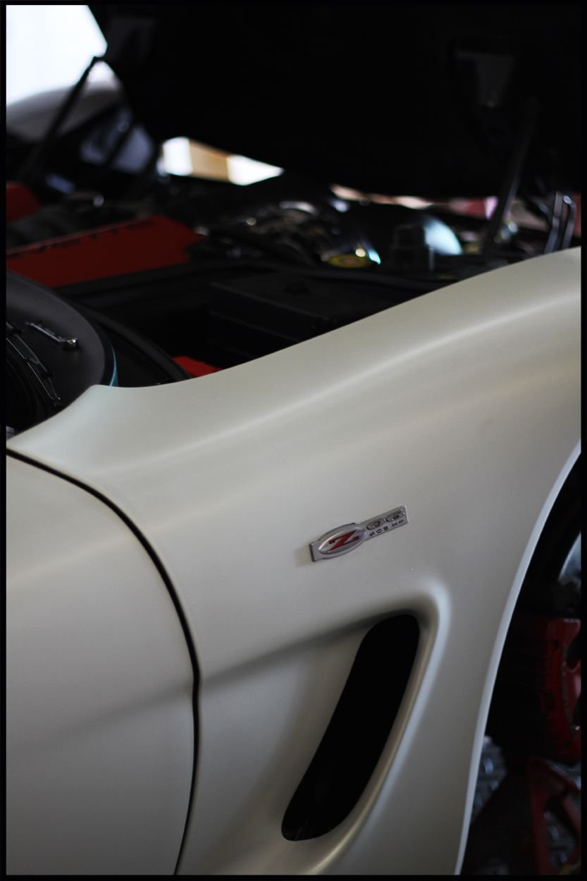

HEHEEHE....WELL...that was indeed, quite the decision. My car was black though, so that handed me a little visual trickery.
I did do a little strategic "bunching" of the wrap into the cove area to start with...I heated it and pushed into the cove area, then stuck below it, leaving an area of excess material (kinda hard to explain...easier to show). Then, the key was to push it in all as one...if you do it progressively, the portion of wrap available to stretch gets small quick, and that's it. Inevitably, I didn't get either side in all the way, but being my car was black behind it, I cut a "new shape" of the coves opening/outlet, to add to the size of the opening. It made it look more bold...look closely you see the paint shining black. Look below at how big the outlet looks...made it look larger/more aggressive, and due to the contrast, no one ever knew the difference.
VS OEM opening below

KITT, very clever with he cove and I do like the look. Even that I can see the black, it looks like a custom decorative stripe in that area.

KITT, a couple of more questions,
  1. which version of the knifeless tape did you use? The general purpose or ‘fine cut’?
  2. Your cut around the cove opening is excellent, did you use the tape there?
  3. Did you ‘bunch’ the cove before setting any other part of the fender?
  4. What would you say was the toughest area after the coves?
  5. How did you prepare the surface, including paint chips?

1. I use the brand Knifeless...they gave me their product at SEMA, told me how to best use it, and I just never waivered. I DO wish it would turn corners better, but I make it work well for me. If I really have a complex situation, I use fine line vinyl tape, run the shape I want, then I run another piece right next to it, so it creates like a "groove" I can see. I then wrap over it, and blade the visible groove...with a light touch you won't touch paint beneath. Then I pull it out like i would knifeless tape, then heat/finish the final stick on the wrap.
2. Cove done with the twin pieces of vinyl tape like explained above
3. On the 2nd one I did more aggressively, yes. The first side...I almost didn't make it to the shape I cut them in. Getting the cove ALL THE WAY without an extra piece...that likely would be real tough and quite likely over stretch the material. You can probably do it, but certainly colors would probably not tolerate it. I see A LOT of cars wrapped, that look a bunch of different shades because installers are infatuated with seamless installs. I'd MUCH rather have a well executed and concealed seam, than stretched/faded/sh*t install.

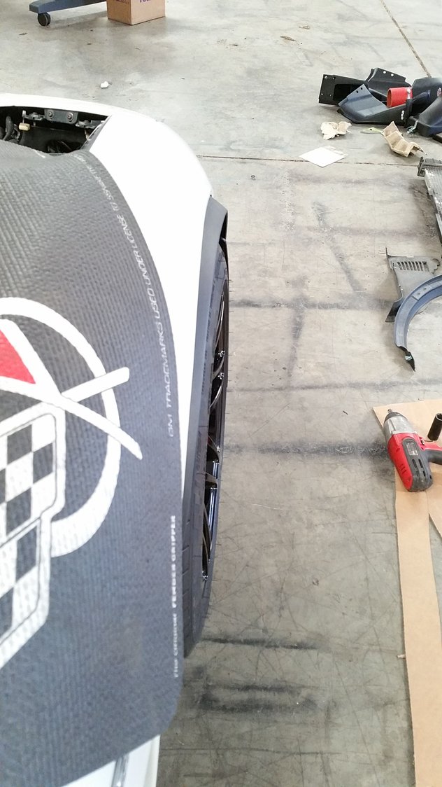

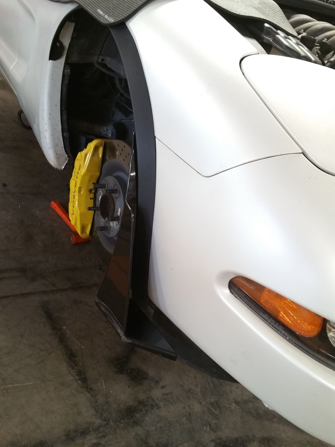

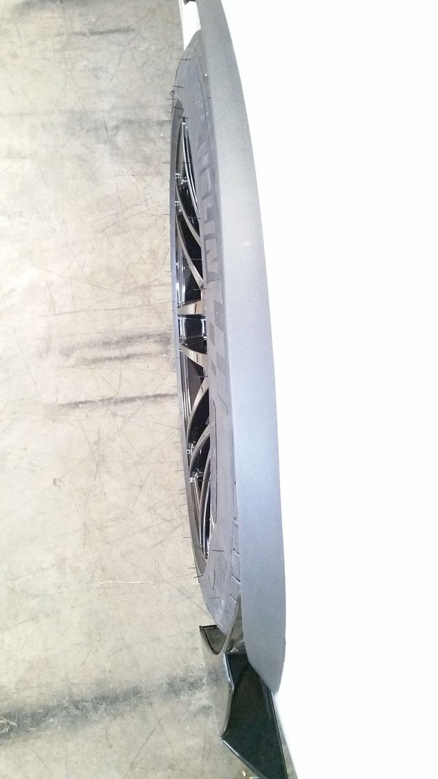

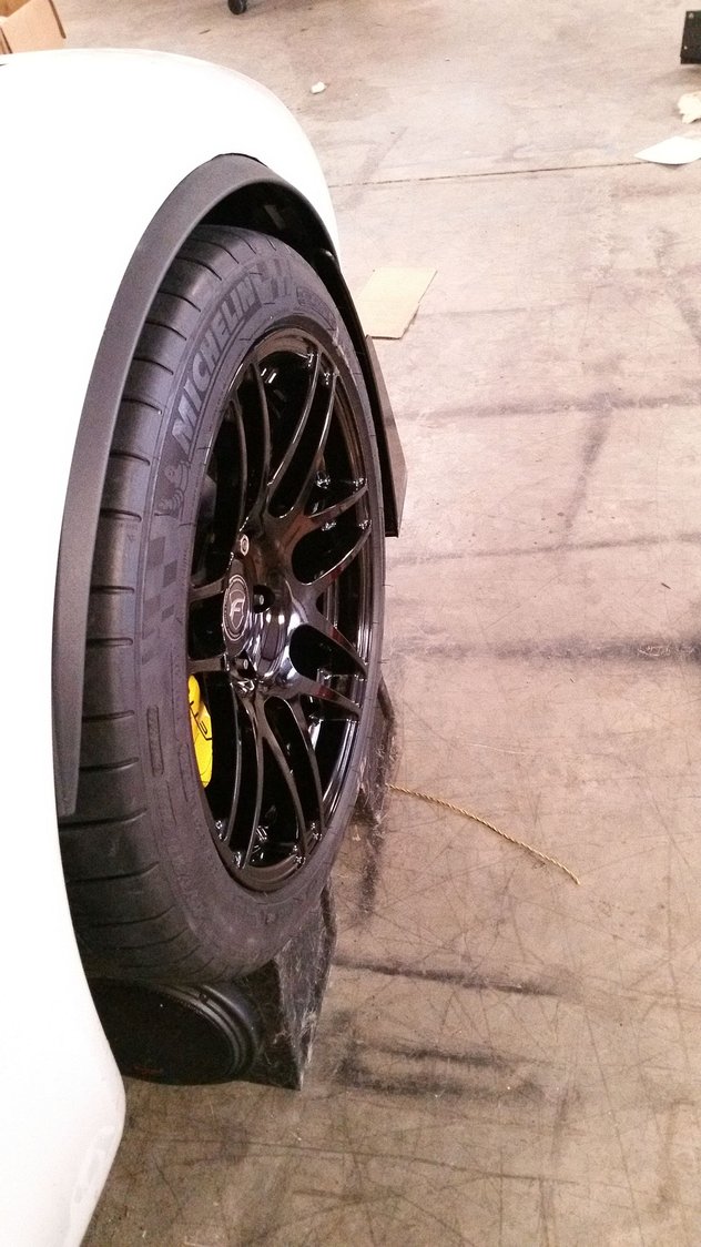

Are those c7 fender flares on your c5? I sure would love to know/see more about that.

Yeah, I did a test mockup of them, but then changed course and was doing a full one-off widebody in carbon BUT...then I relocated across the country/switched shops and it fouled up my progress. I'm making some carbon parts for C5 and C6 ahead and doing the widebody shortly. I put the spats on initially and they do work with some modifications to the fender and the spat.
And yes, I was holding my wheel/tire up with speaker boxes...lol. I had the coilovers out and was holding it at ride height for visual.

Wow! I really like that. Was it just actual OEM C7 flares you were modifying?

Yep, just oem replacement C7Z/GS stuff. I have the stage 3 aero ends as well, which I was going to add to a alumicore based splitter but...doing something different next.
