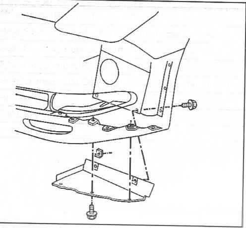

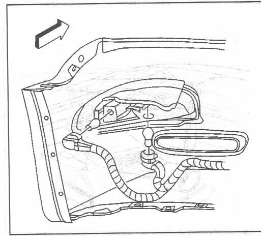

Probably the easiest way is to go through the bottom access panels:
Old Jun 27, 2019 | 04:47 PM
OregonDan's Avatar
OregonDan
Joined: Jun 2019
Posts: 457
Likes: 54
From: Dallas, Oregon
Well that makes it look easy! Didn't even know those panels existed! Thanks again...................Oregon Dan
