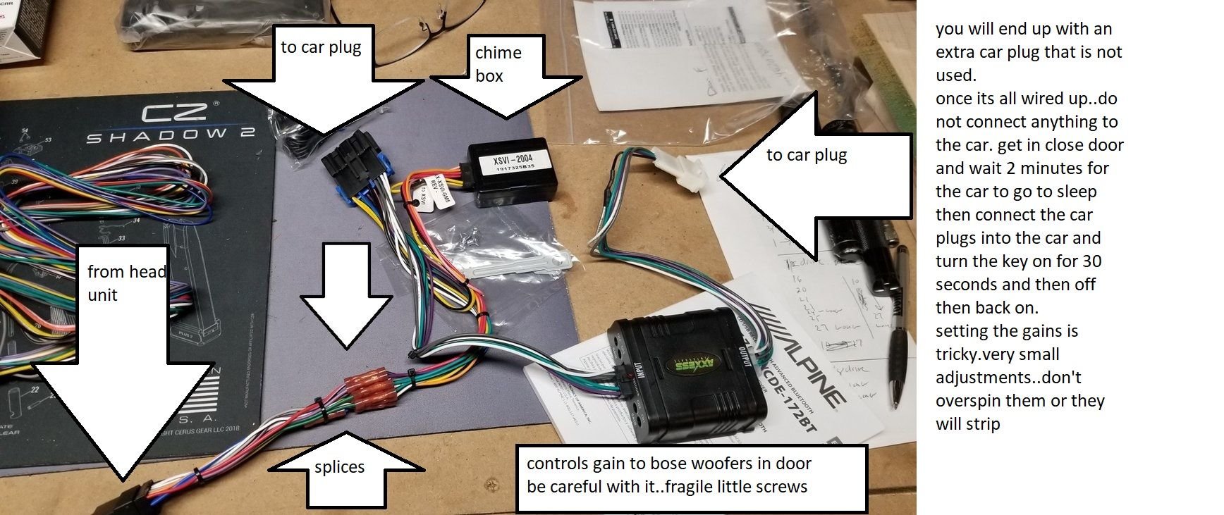

So after research I ended up getting the Kenwood DNX 996XR along with AXXESS XSVI-2004 wiring Interface. In the process to start the install and first obstacle is the wiring interface AXXESS which did not come with description of the different components. I was wondering how to connect certain plugs assuming they need to be connected somewhere. There are 2 black boxes and 2 wiring harnesses. that came with the AXXESS kit. I am trying to understand certain plugs where they go.
- What do I do with the small black box, the 2 wiring harnesses that came with the kit none of them plug into it and I couldn't find anything in the car to plug into it either
- So the first wiring harness with the white plugs on either end, one end goes into the converter with the dials and the other end goes into the factory harness - CHECK
- The second wiring harness has 3 black plugs and stripped wires.
- The stripped wires I will have to wire with the new Kenwood wiring harness by matching colors - CHECK
- The big black plug gets connected to the factory harness - CHECK
- What about the 2 small black plugs where do they go, I could not find anywhere to plug them.
Any help on this is greatly appreciated

Old Aug 7, 2019 | 07:42 PM

Ok so I wired the Axxess XSVI2004 to my kenwood wiring harness and I by mistake forgot to wait till the car goes to sleep and I went ahead plugged and turned it on. When I remembered I turned off and took the switch off but all lights kept flickering so I unplugged everything..... so my question did I ruin the initiation is there a reset to redo it
Old Aug 9, 2019 | 07:23 AM
mfi2000's Avatar
mfi2000
Joined: May 2019
Posts: 765
Likes: 182
Does the radio work?
If not just repeat the process.

Old Aug 9, 2019 | 03:28 PM
mfi2000's Avatar
mfi2000
Joined: May 2019
Posts: 765
Likes: 182
I didnt disconnect the bsttery
I had the bezel off..harness unplugged..then got in the car..shut the door and let the car snooze for a few minutes..then connected the 2 plugs back into the car and did the 30 second on..off.
Then adjusted the bose woofers..which are gone now.
Im not sure why this works but it does
