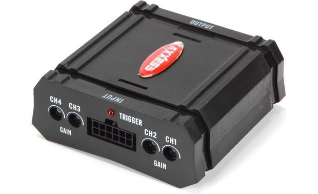

If its an axxess adaptor it has a LOC which is a line level converter..small black box with 4 little screws that adjust the gain. If they arent set right they will overdrive the speakers and that crackle you hear is the head unit amp clipping..not a good thing.
It should not have even worked without this unless they did some weird wiring.

If it wasn't for a blown #1 gain control....replacing module today..I had it sounding pretty good..just have to set the gains carefully..I'm doing it with an SPL meter.
But yes..the next step is to rip it all out and do it right.
