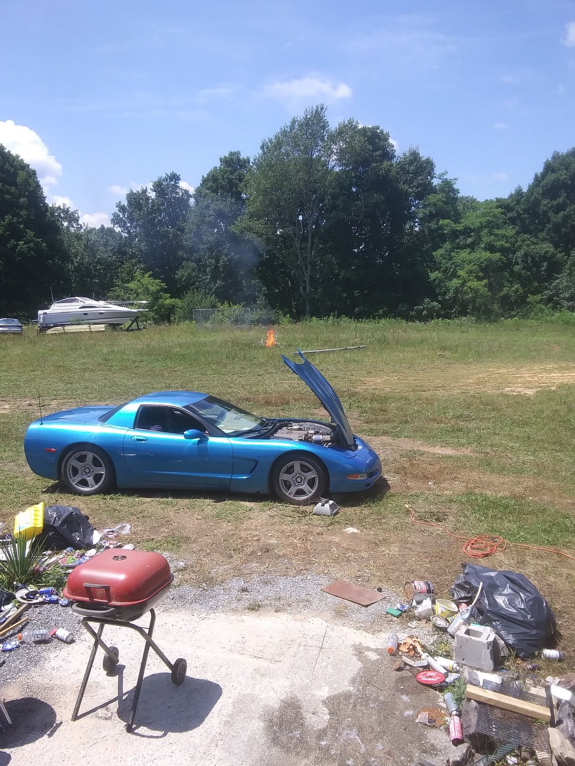

My 1999 Nassau Blue 6 speed w/ stainless steel headers
