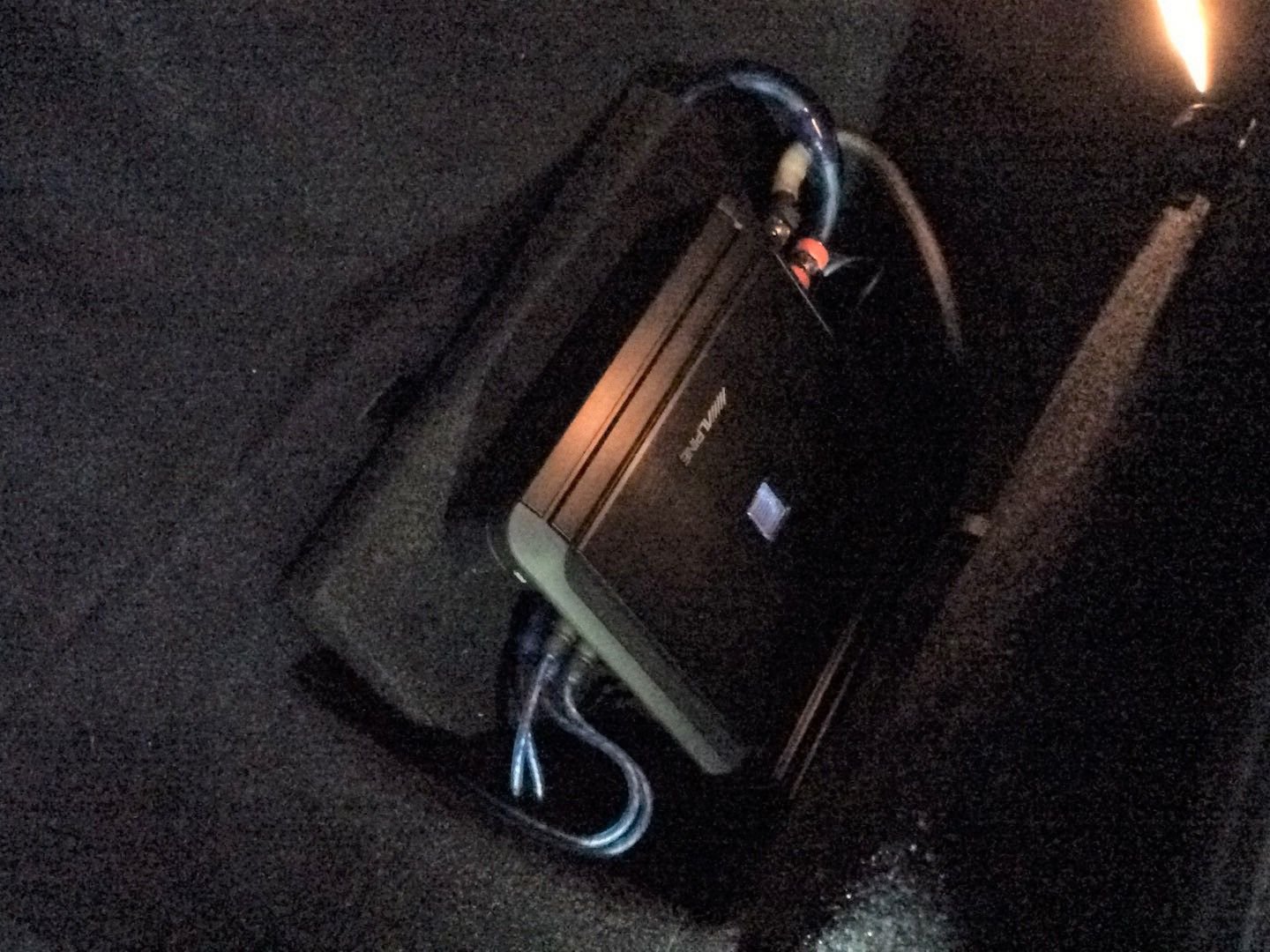

In my C5 convertible I was thinking of doing a new amp rack.
Right now I have one amp sort of resting in there on a piece of wood with black carpeting on it, but in considering adding a second amp I would like to make something more fancy than that since there would now be two amps and a power distribution block. It will definitely need to be taller, but I want it to be able to stand on its own instead of just leaning like I have it now.
current state
I'm wondering if anyone else has done this before and if they could share photos. I'm just looking for inspiration.
Someone else on the forum was kind enough to supply the measurements of the interior of the cubby - 11" x 6 1/4" x 5 1/4".

I have not seen a 5 channel amp that fits properly in the cubby. The Rockford Fosgate, for example, is 16.5 x 10.3. The Alpine amps I have in mind are 13 x 9 (the 4 channel I have already) and 10 x 10 (mono) respectively. Remember mine is a convertible. I can't mount amps where the top is. I do not want to mount behind the seat because I park with the top down sometimes. And I can't put them into the middle well because there's a sub box in there already. So the cubby is what I thought the best option was.
I built a prototype of the amp rack using some scrap plywood. I'll use MDF with black automotive carpet on the final product but I didn't have any MDF on hand. I've seen someone who builds these with PVC but I am not sure I understand why. Separate thread I guess.
So the base piece is the size of the bottom of the cubby, that's to weigh things down so everything stays in place while the car is moving. I'm not going to screw it down into anything, just let the weight keep it still in the cubby. If I run into issues I can always double the MDF on the base piece. Then there are two pieces mounted vertically to that which are tall enough to have the one amp on one piece and the distribution block and the other amp on the other piece. I would take pictures and share, but the prototype didn't come out right, I have to redo it so the amps fit. Also I was orienting the amps facing left (in the right side cubby) - the 7 1/2 inch width of the pieces wasn't wide enough, I need 10 inches, so they need to face rear. I'll share photos when this is done.
With the above said, I have not purchased the second amp yet, so I'm still open to suggestions. I will keep looking for other 5 channel amps just in case I find one that would work. I agree with simpler wiring and a simpler amp rack to build.

You're right, I'm paranoid about some jerk coming and cutting the wires and ripping it out.
That said, if I did change to a 5 channel and mount behind the waterfall, what do you mount it to? I pulled the carpet up and I couldn't tell what would be safe to screw it down. I would maybe still want a panel with carpet on it so I can put zip ties down and make it neat.

I cut a piece of MDF and glued it down under the carpet. I then screwed down the amp to the MDF.

The space behind the seats is the gas tank..do not screw into that...just glue mdf to it..or anywhere and screw into that..threaded inserts are best as you can remove the screw many times if needed and provides a stronger attachment than wood screws..

So the amp is underneath the carpet now? I'm assuming there's no overheating risk? Or did you cut the carpet in that area?
I am liking this idea of 5 channel although I does mean I have to reroute wires and run a new ground or at least a longer one. I'm connected to the FM antenna ground that you access behind the right most tail light at the moment. There must be a better location to use when the amp isn't in the back of the car.
Someone also suggested threaded inserts which I was definitely planning to use, also ferrules. And I could use shorter RCA cables too. The amp wiring kit I used when I first installed all of this 5 years ago came with 17 foot long cables. I would imagine behind the teardrop, one could go with 6 footers.
Definitely been watching a bunch of car audio install videos lately.

He means ..glue the mdf under the carpet..then screw the amp down to it ..the amp is on top of the carpet..
Its so you dont ever screw into the car and possibly puncture something like the gas tank

Right one piece of mdf is glued under the carpet. I then screwed another piece of mdf over the one under the carpet ( 2nd piece on top of carpet) then screwed the amp to that so it is more secure. I cannot up load pics from my phone so will post a little later

No that's cool, I get it now. If you remember what sort of glue you used, that would help, but I'm sure I can research that. Wood to fiberglass shouldn't be hard to figure out.
For a more professional look, I can put some black automotive carpet on the MDF that the amp gets mounted to, as in my original photo. I used spray adhesive last time and I'm sure I still have some left. I have lot of extra carpet left.
