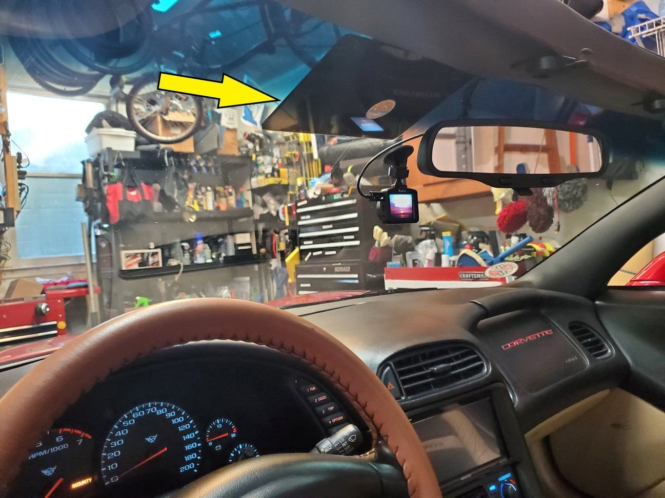

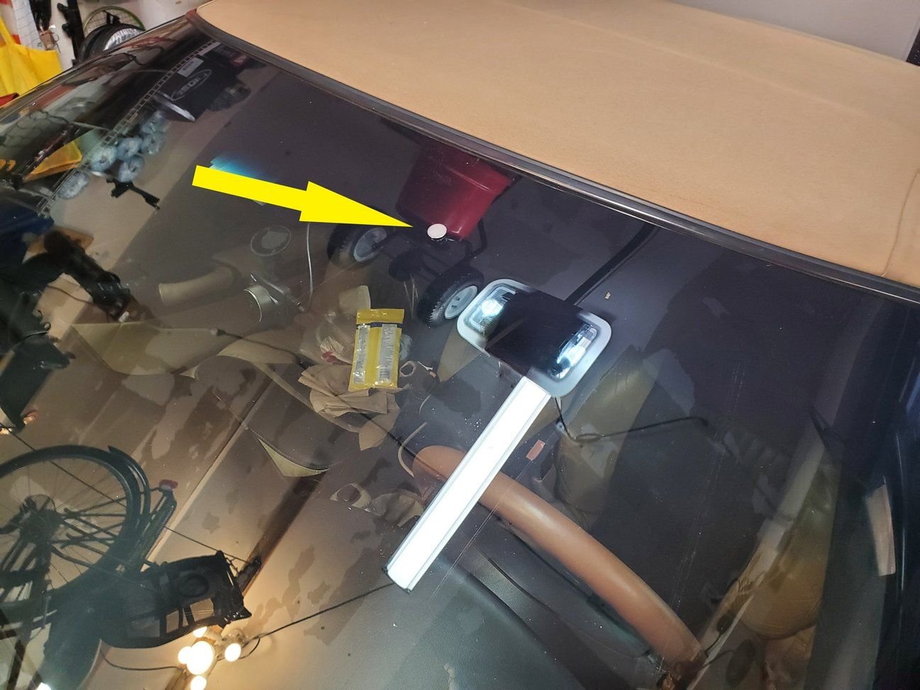

Originally Posted by NemesisC5
Thanks Edmund - placed my order
A few years ago when I redid my sun visors, I had them out for several weeks and really liked the clean look and the more open view. However, I did put them back in once they were refurbished. However, two years ago during a multi-day road trip, I got tired of them always being in the way (I have a convertible as well). So I pulled them off and threw them in the trunk and decided I'm going visor-less from now on. I ordered the plugs from Corvette Clips and I got this thing (https://sunblocker.store/) for those rare times when I have to deal with sun glare. The Sun Blocker just parks up top near the rear view mirror, pretty much out of the way, and is available anytime I need to move it into position - held on by magnets and you can slide it around to position it where you need it. All you see on the outside is a quarter-sized silver metal disc on the windshield.
