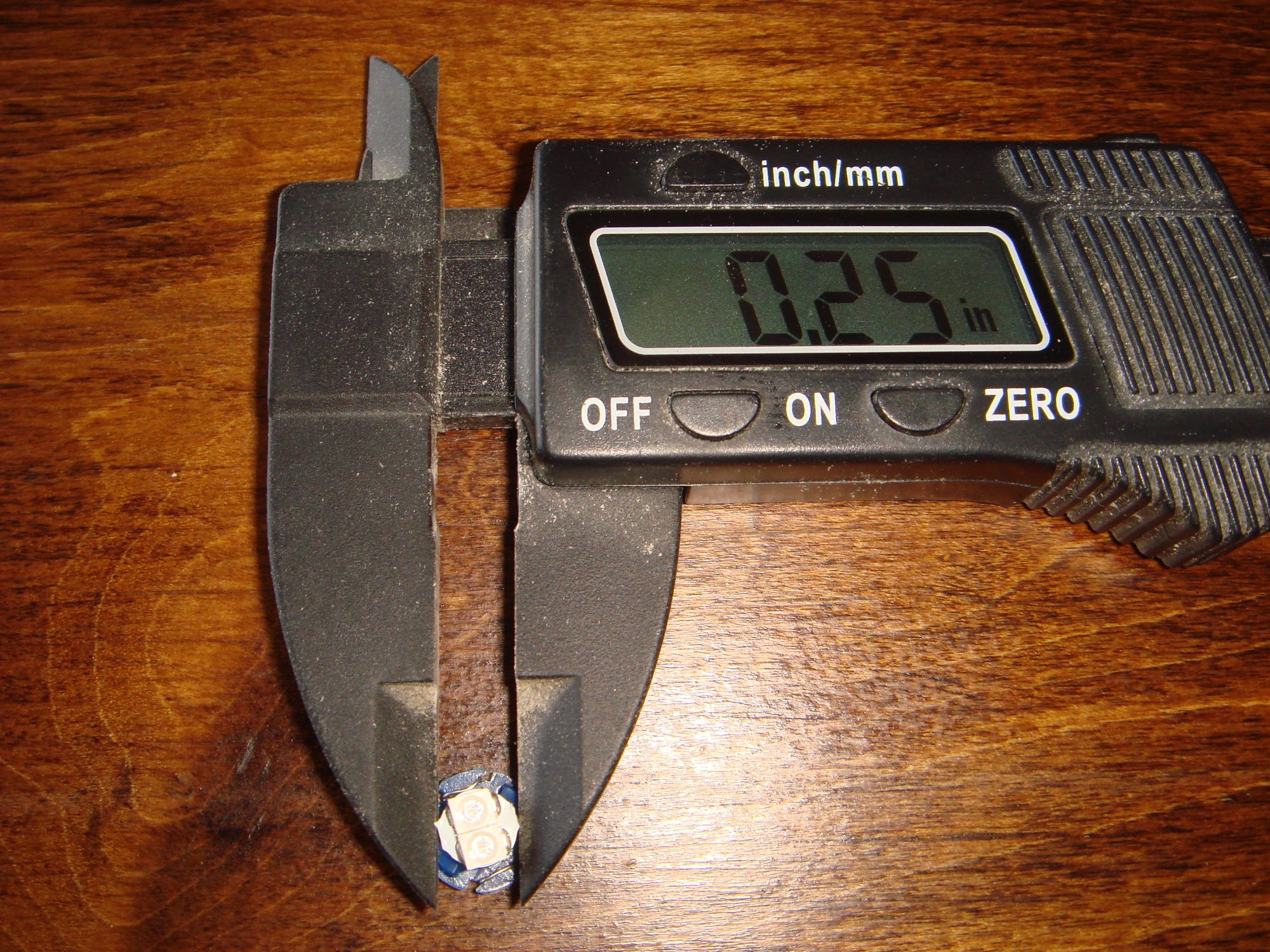

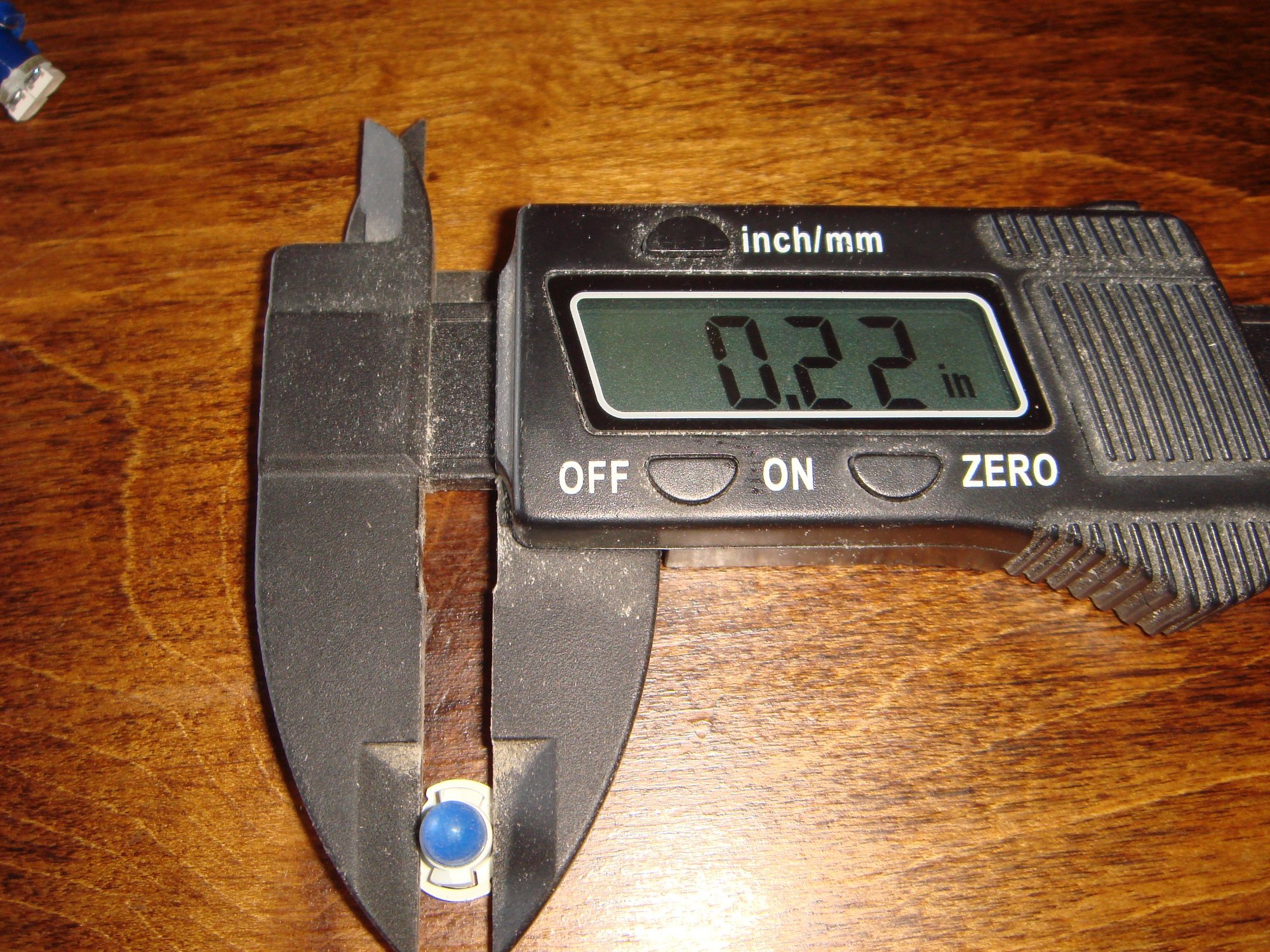

I bought some LEDs from a forum vendor and had to use a small file to fit each one. Was kinda' a PITA but with a few hours work it came out nice. Make sure to check the polarity of the board AND each LED!

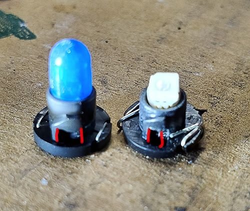

Not having issues with fitting in hole but staying there - lugs (as illustrated are not deep enought to keep LED in place. Cant do any griding to make lugs deeper. Hopefully new ones will be a better fit.

Possible some super glue on the lugs to add more to them? Not super glue the in place though! But just to add more beef? Then you can grind as needed?
