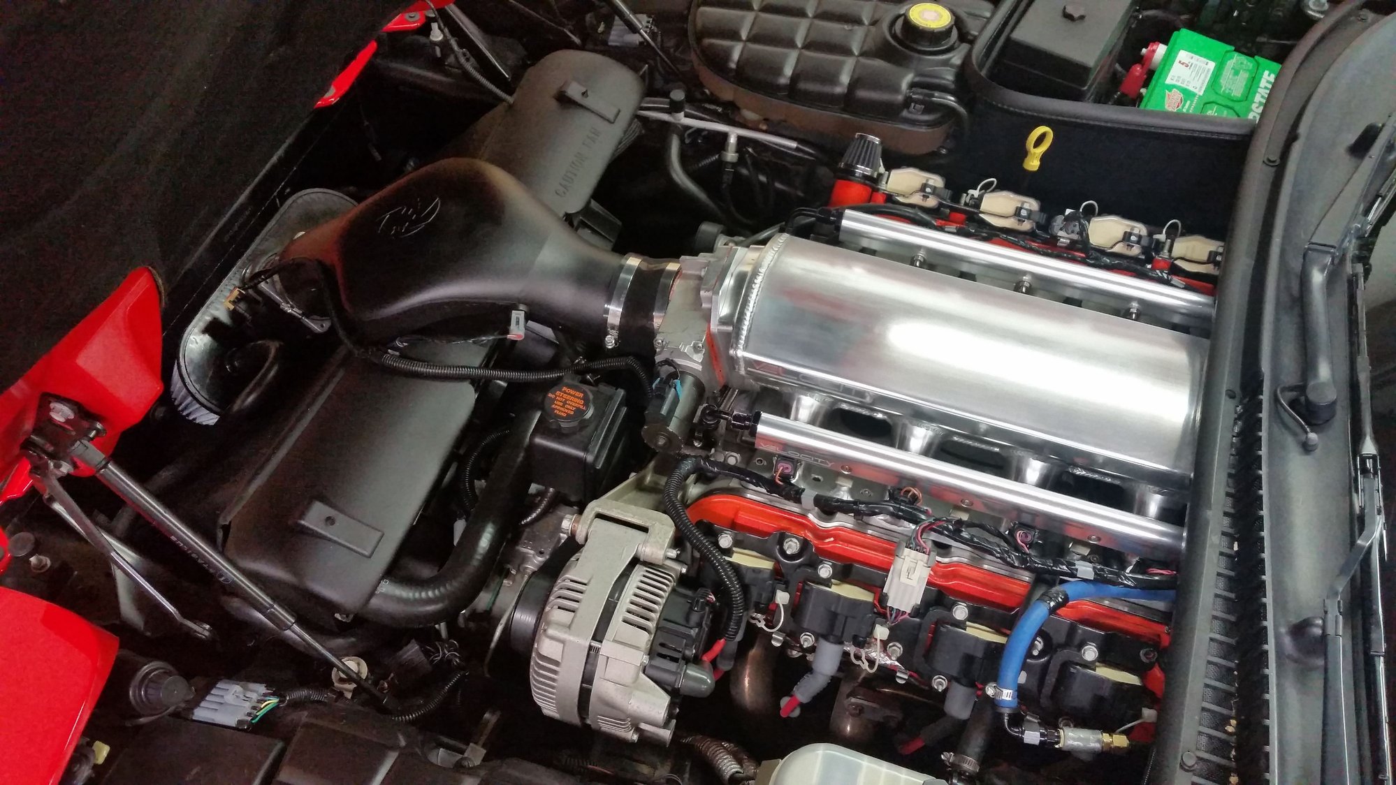

For what it's worth, I've been really happy with the AFE intake.
It replaces the air bridge with nice, large piece and puts a nice filter in a good spot. The Honker was my #1 option initially, but cutting up the shroud worried me on engine cooling and the possibility of ingesting water into the intake. I drive my Vette in the rain so it was a concern.
I had to play with couplers to make it all meet up with the sheetmetal intake, but that wasn't horrible at all.

I drive mine in the rain too. My setup resembles yours. Does the airbridge contact the hood liner?
Old Sep 3, 2019 | 07:04 PM
partspusher's Avatar
partspusher
Joined: May 2019
Posts: 159
Likes: 50
Pretty sure it does contact the liner, it is definitely taking on an impression from the tube and I'm ok with that.
