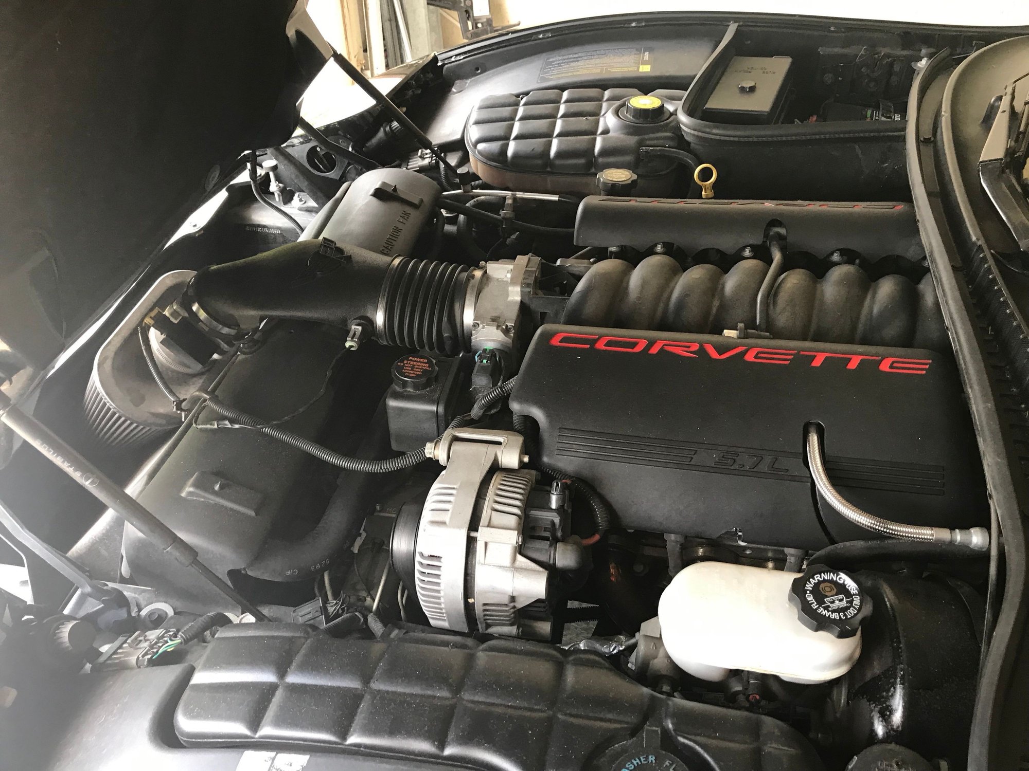

Hello all! I'm sure this topic has been beat to death but I'm kind of at a dead end with my own research. I recently picked up a 99 FRC that was mildly built (FRC heads, cam, exhaust, etc) by the previous owner and I'm trying to figure out what he did with the intake. If it were up to me, I would've just kept that stock but there appears to be some sort of cheap(ish) aftermarket addition. Given the under hood temps, I highly doubt it's contributing much to my power and the mounting system is a little hokey. I've looked into the other aftermarket options and the only ones that seem of any quality are the Callaway honker and the Vararam. My only problem with the Callaway is I hate that you have to cut up factory parts and I've heard about a lot of fitment issues with the Vararam.
I guess I just don't like hacking things up if it can be avoided and I equally dislike poor quality aftermarket stuff. I'm open to any and all suggestions at this point haha thanks! (Here are some pictures for reference..)

That actually doesn't look like too bad of a setup. The Halltech KB2 is one of the best flowing intakes you can buy, and other than have a bigger air bridge and the newer style MAF, its essentially the same concept
Hmm, ok I gotcha. Well maybe I should just look into why it keeps popping off the mounts and see if there's any better alternatives.
I guess I'm just leery with intakes after I got out of my "tuner" phase. Specifically cutting holes in the sides of engine bays for CAI's lol

If you replace that odd ball filter with an SLP Blackwing filter it will fit properly and not pop up on you at the air bridge.
The filter does look like a Halltech filter or a knock off of it that would as mentioned earlier have a different much better air bridge to go with it.

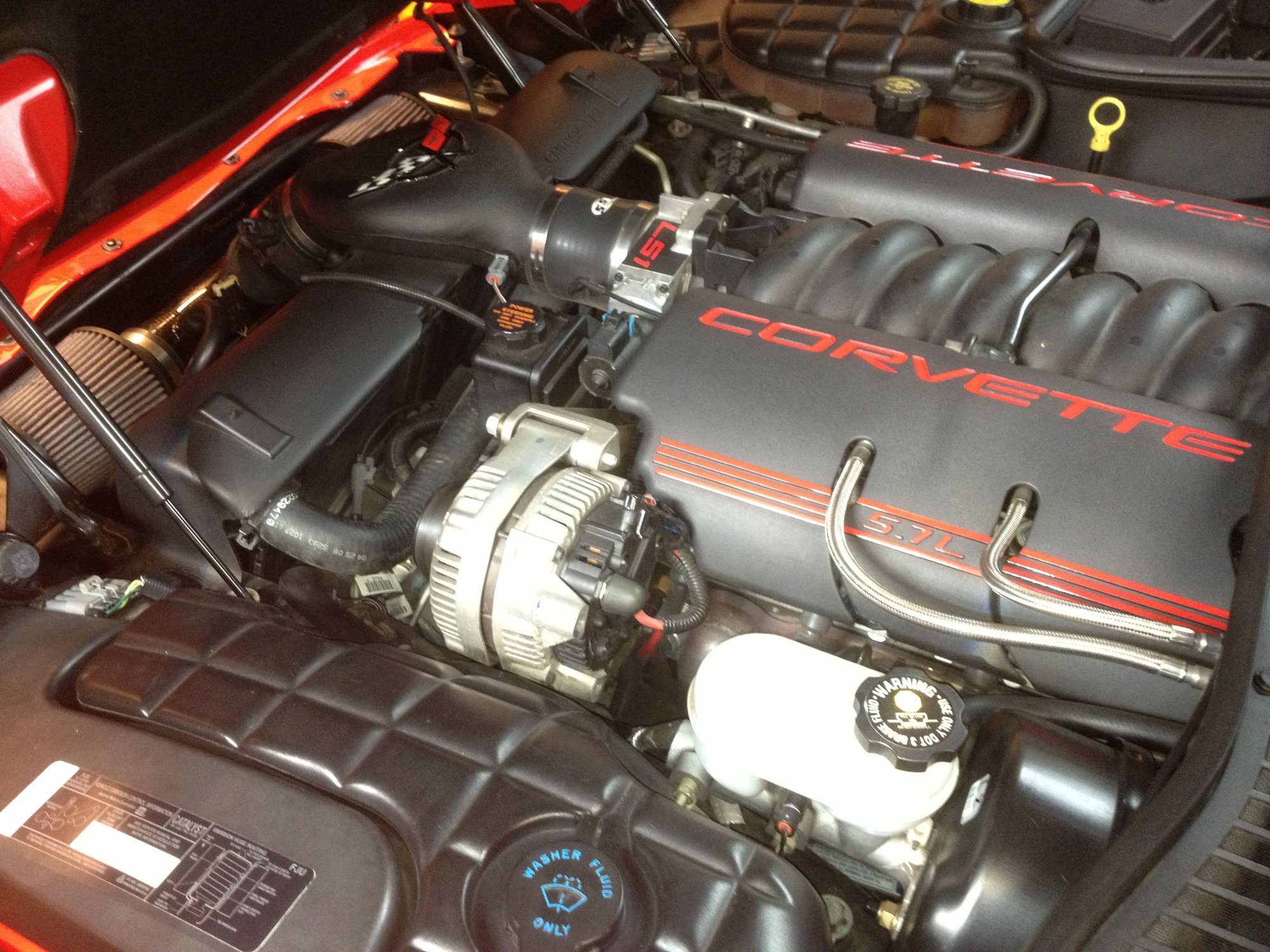

I have an older Halltech that resembles yours but without the taper and is identical to K&N’s I’ve seen. I replaced the airbridge with a stock one like yours because the Hall version contacted my hood, slightly raising it in the middle and ruining my hood blanked graphic. I can see that your airbridge is not secured at the bracket, which I’m guessing is due to the shape/size of the filter itself?

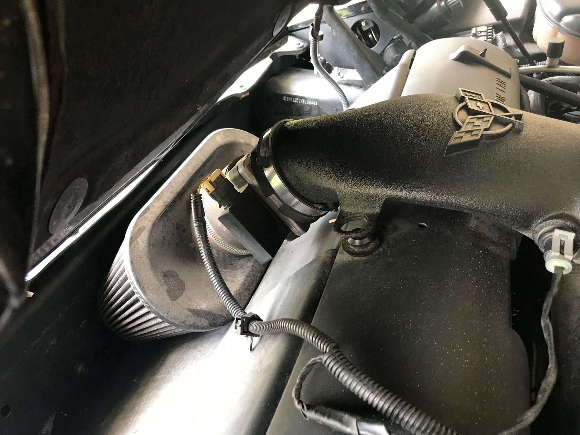

As I mentioned earlier in this thread, I went with what is simple and it just works. It's a good quality filter from SLP. It fits perfectly and there is no air bridge popping up ever.
Kind of a shitty picture but you get the idea.

Also OP, not a huge concern at all, but your MAF and IAT wiring are not routed correctly.

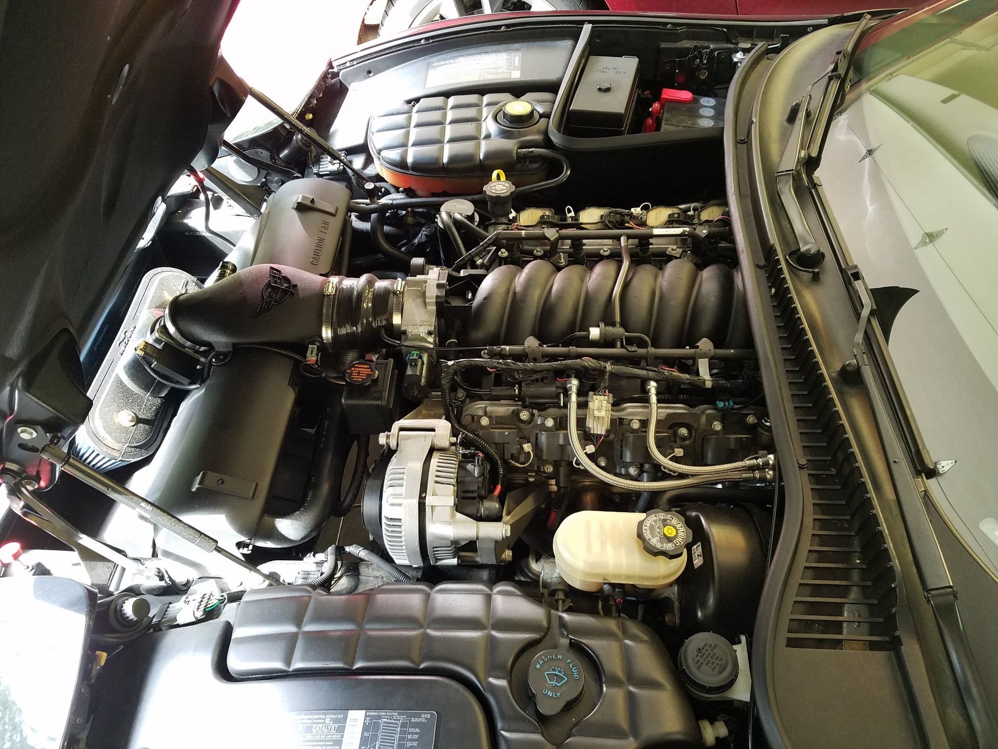

This is my set up. My car is a 98. Duel K&N, LS6 MAF, Larger tunnel ram, Smooth coupler too the TB, LS6 Intake manifold. In 98 that duel K&N was all that was available. It was the very first Mod i did to the car. All I read about these cars when they were new was how restrictive the air box was. Also did a tune and PRT cat back.
Thank you. I'm assuming that clamp needs to be in the small hole near the air bridge mounts?
Love the look of your setup. Did some research on CAI’s and read the dual cone units are the least desirable due to the air turbulence within the tubes where the air from both filter joins together at the bridge. Any insight to this would be appreciated. As of now sticking with oem. Thanks.

Yes. The main harness should be coming out from the intake under the throttle motor on the throttle body and in between the power steering reservoir and intake coupler. It will be almost under the airbridge all the way to the MAF.
Anything and everything is better than stock. I also have heard about the duel cones. But over the years I have seen that setup on many exotics. So they must not be that bad. Everything I have done to my car has woke it up compared to stock.
