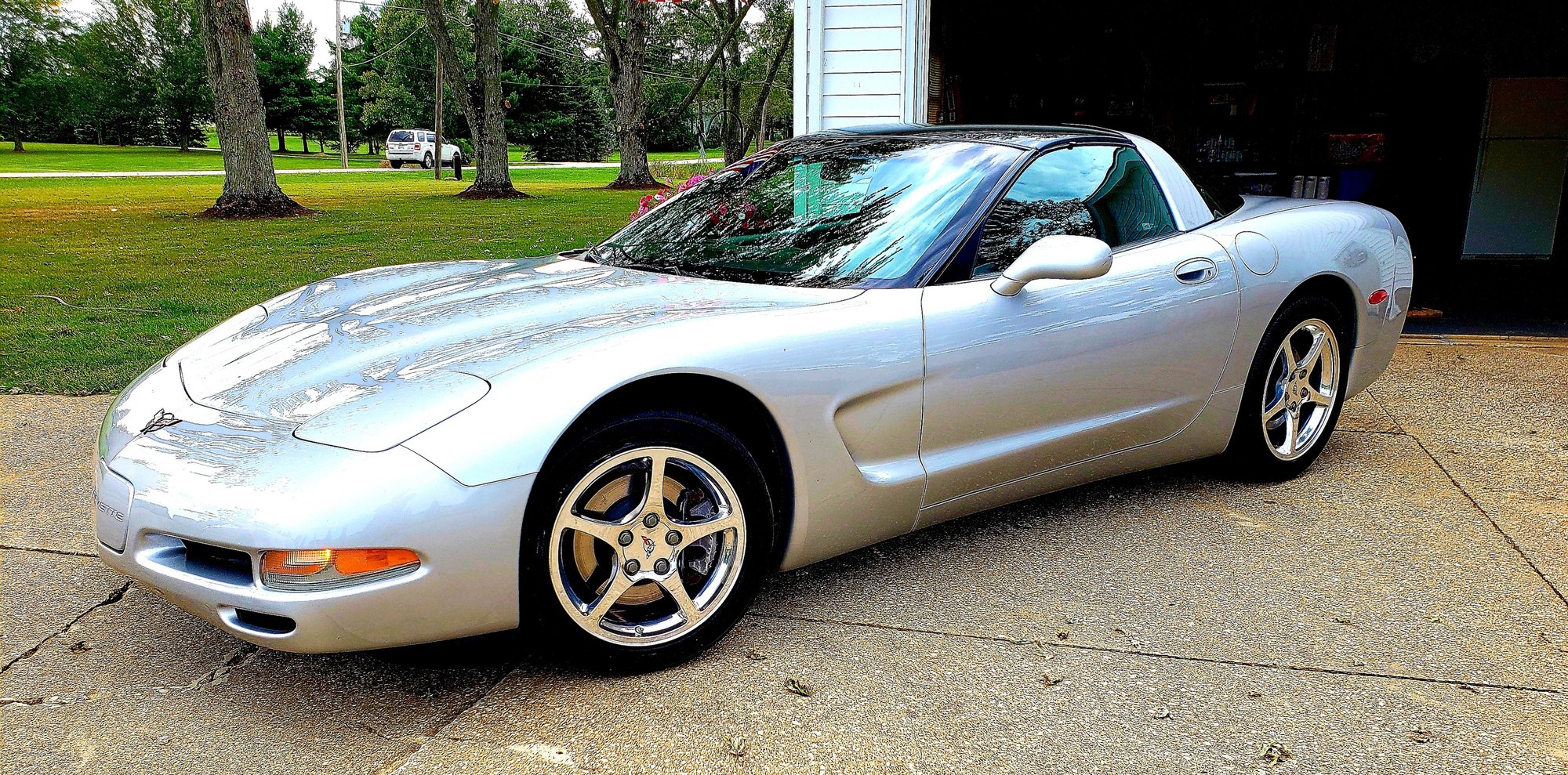

Sold my White FRC C5 and White C6 for offers I could not refused.....then this Silver C5 followed me home for a price I could not refused

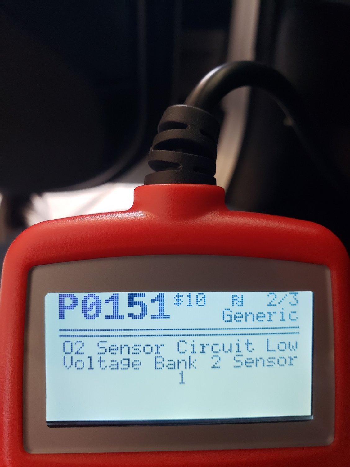

Thank you.....I am chasing check engine codes...O2 bank 1 and 2 sensor 1 and 2....I clear the codes....runs great.....jump on it ..check engine light comes on.

What DTC’s are you getting with your O2 sensors????

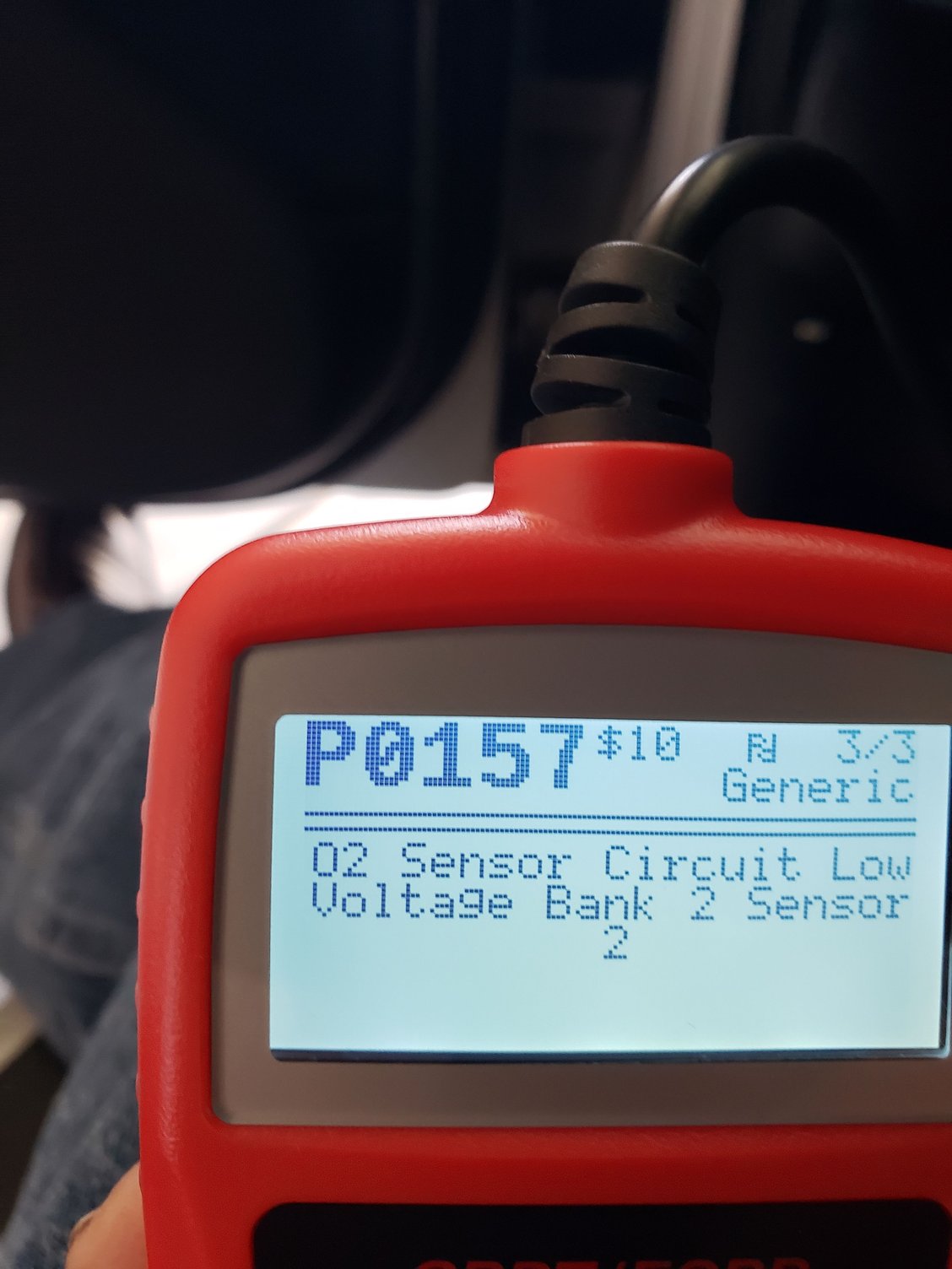

Chasing check engine codes.
How can all 4 o2 sensors be bad?
My handheld scanner is saying the code for:
Bank 1 and 2....sensor 1 and 2
Old Sep 1, 2019 | 09:37 PM
C5 Diag's Avatar
C5 Diag
Moderator, Tech Contributor
Posts: 15,498
Likes: 3,999
From: Cape Coral, Florida
Are these O2 heater circuit DTC’s ??...the fuse is common to ALL 4 O2 sensors !!...what are the “P” code numbers from your scanner ??...P0135, P0141 etc... ??...without the specific numbers you can’t diagnose it !!!
