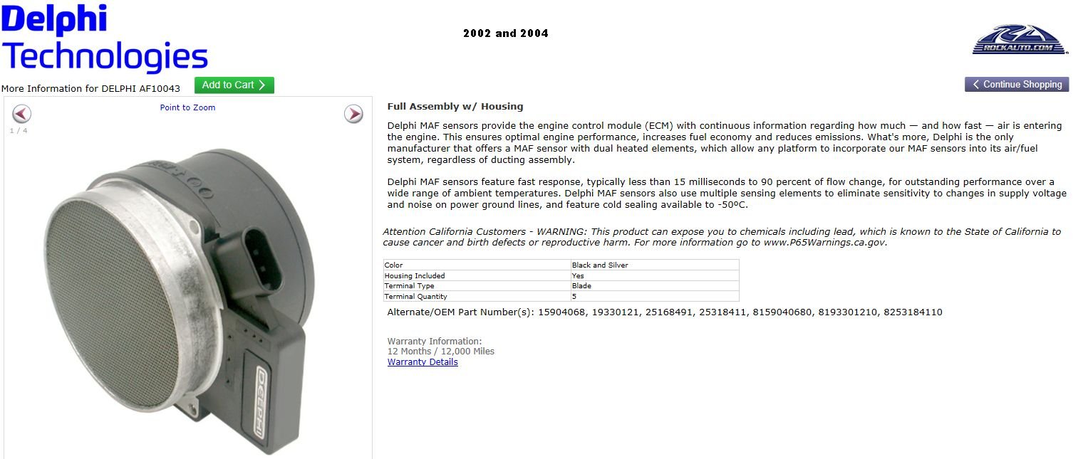

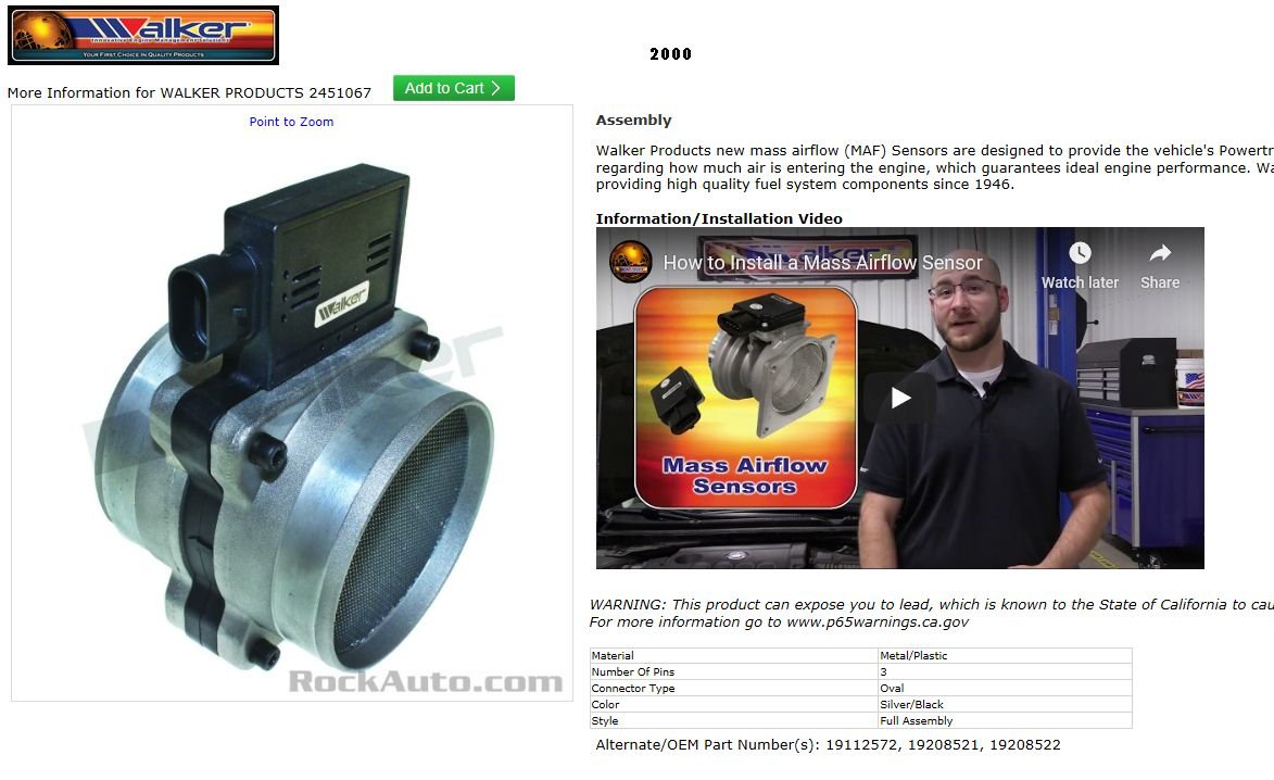

Curious - I went to Rock Auto to see what they show. 2000 is different than 2002 and 2004 is the same as 2002. Interesting that for 2002, 2004 only AC Delco shown (no Walker)…
