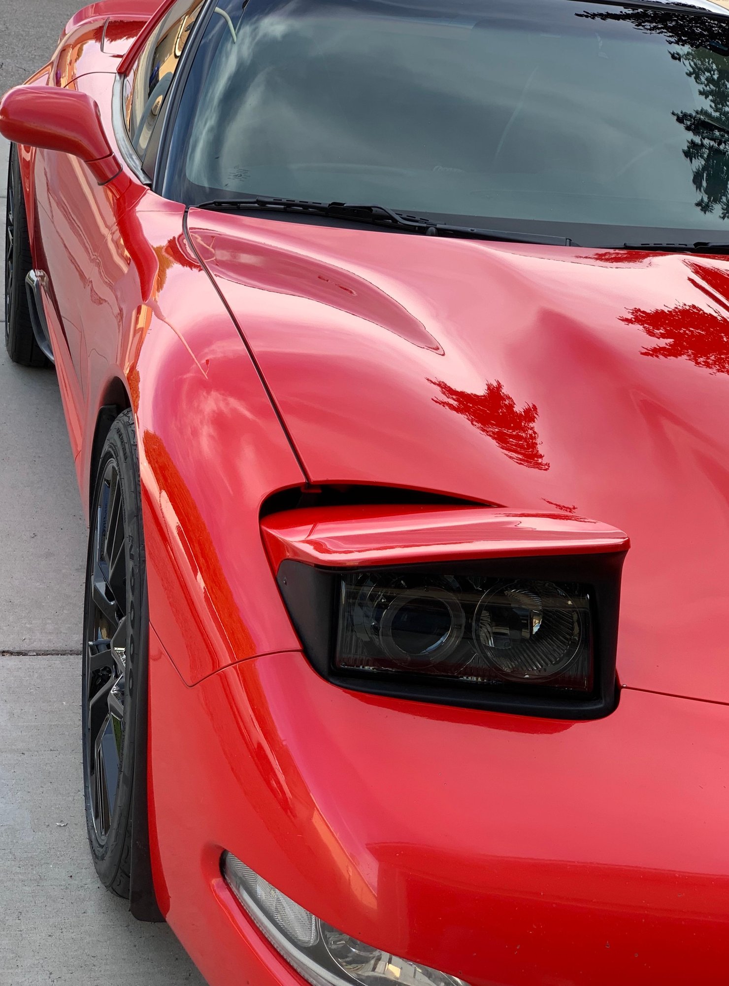

Not sure about those bulbs but I'm using these cheepo LEDs in my cheepo tinted ACAs for high beams. Works fine.

Wow! I'm surprised you see anything with all that tinting! I purchased mine smoked and had to return them because it hindered light output so much I could barely see the road. Yours look twice as dark as the one's I had. But then, I was using CorvetteMods trash lighting at the time. Went Morimoto with my clear ACAs. Much better now. But my high beams are still halogen and the yellowish color has to go! Do these have a white or blueish temperature?

I originally ordered regular clear/black ACA housings but the seller emailed me and said he didn't have them in stock and offered to send me the smoked/angel eye version for the same price.
https://www.ebay.com/itm/97-04-Chevy...8AAOSwL3Jaxov3
I accepted his offer and tried them out. The tint with these bulbs doesn't visibly block the light that I can notice ¯\_(ツ)_/¯
I'm using these nighteye bulbs for the low beams along with the high beam bulbs posted above

Yes, those are the same ones I had. They look darker in your pic. The same seller was wanting over $200 for the black/clear ones. I was able to find them from a different seller for just under $200. Thanks for the suggestion on the LEDs. I'll give them a try.
