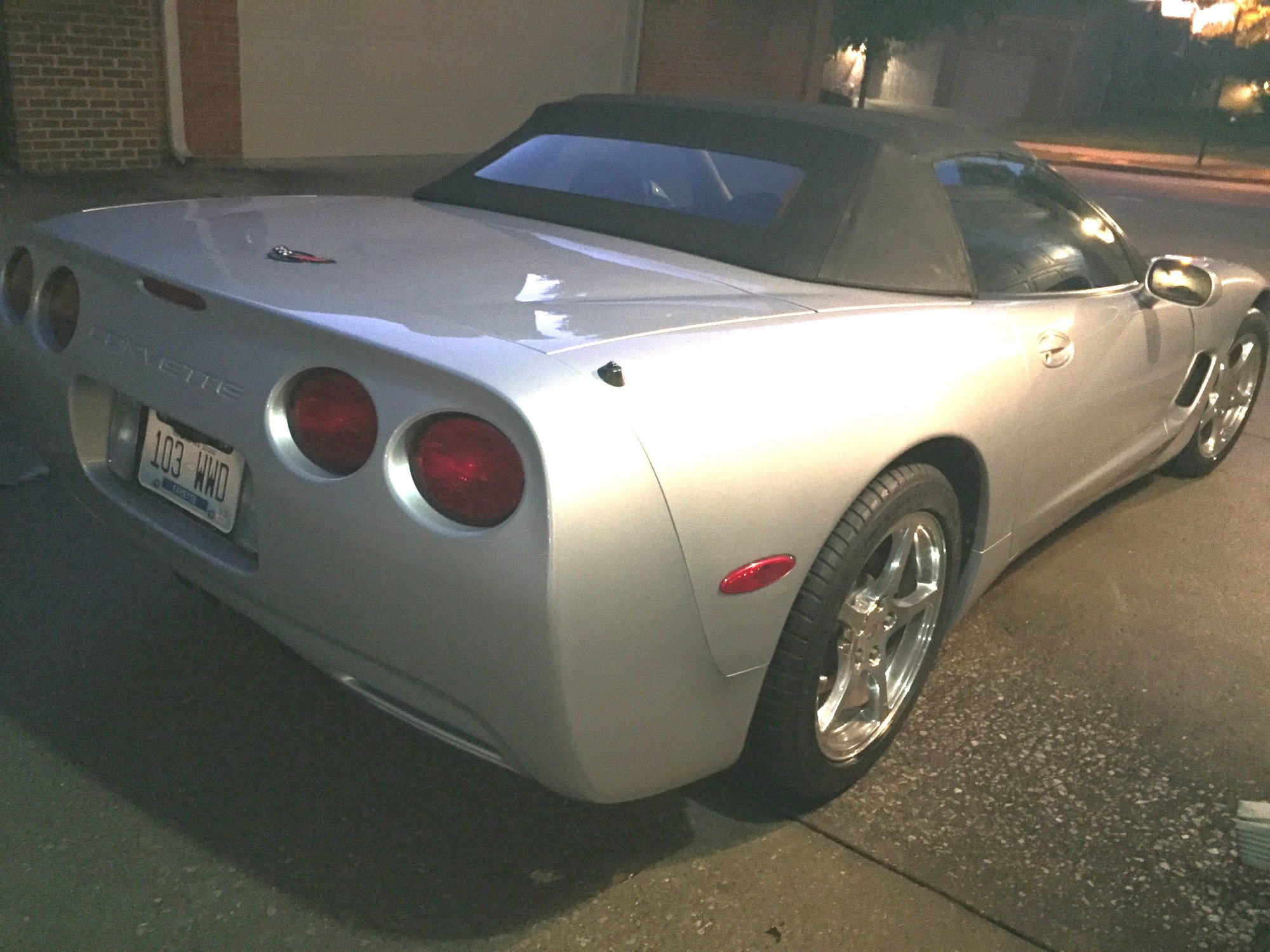

Default Yessir, ET

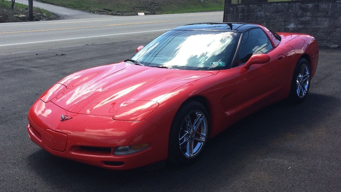

Both of those products have always worked great for me. Makes my 98 sparkle.
If the vette’s too dirty, I use Meguiar’s car wash liquid with wax in it. I also have used Rejex once a year for the past dozen years.
Here’s my baby posing at dusk wearing only the Turtle Wax Wash & Wax.

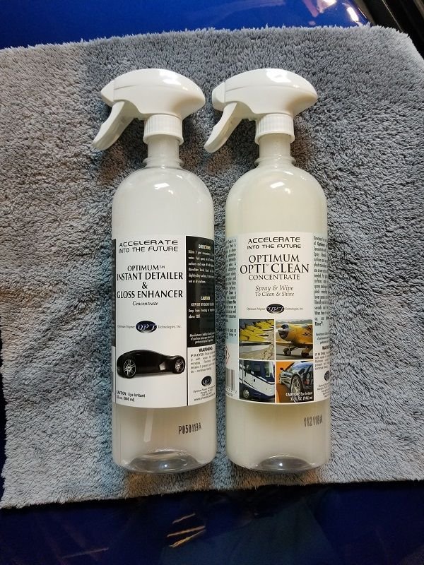

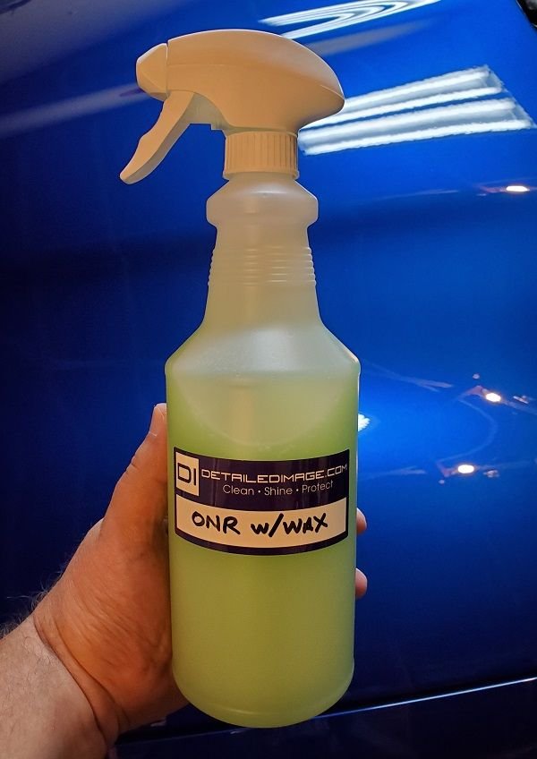

I use ONR W&W in a detail spray dilution as my go-to waterless wash on my Z06, which is covered in carnauba.
My daily is protected with a synthetic sealant, so I use Wolfgang Uber Rinseless on that. But, I am a huge fan of Optimum's products. I highly recommend trying their "Instant Detailer & Gloss Enhancer" and their "Opti Clean", which is like "No-Rinse" on steroids. IG&DE is quickly replacing all of my detail sprays. It leaves the gloss of a spray wax and the polymer protection of ONR behind.

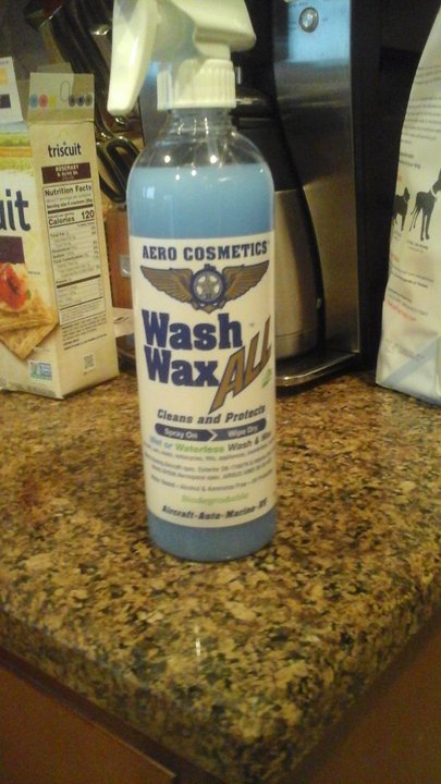

Default Aero Cosmetics
10 times better than the Amsoil product I first used and the shine is probably better.

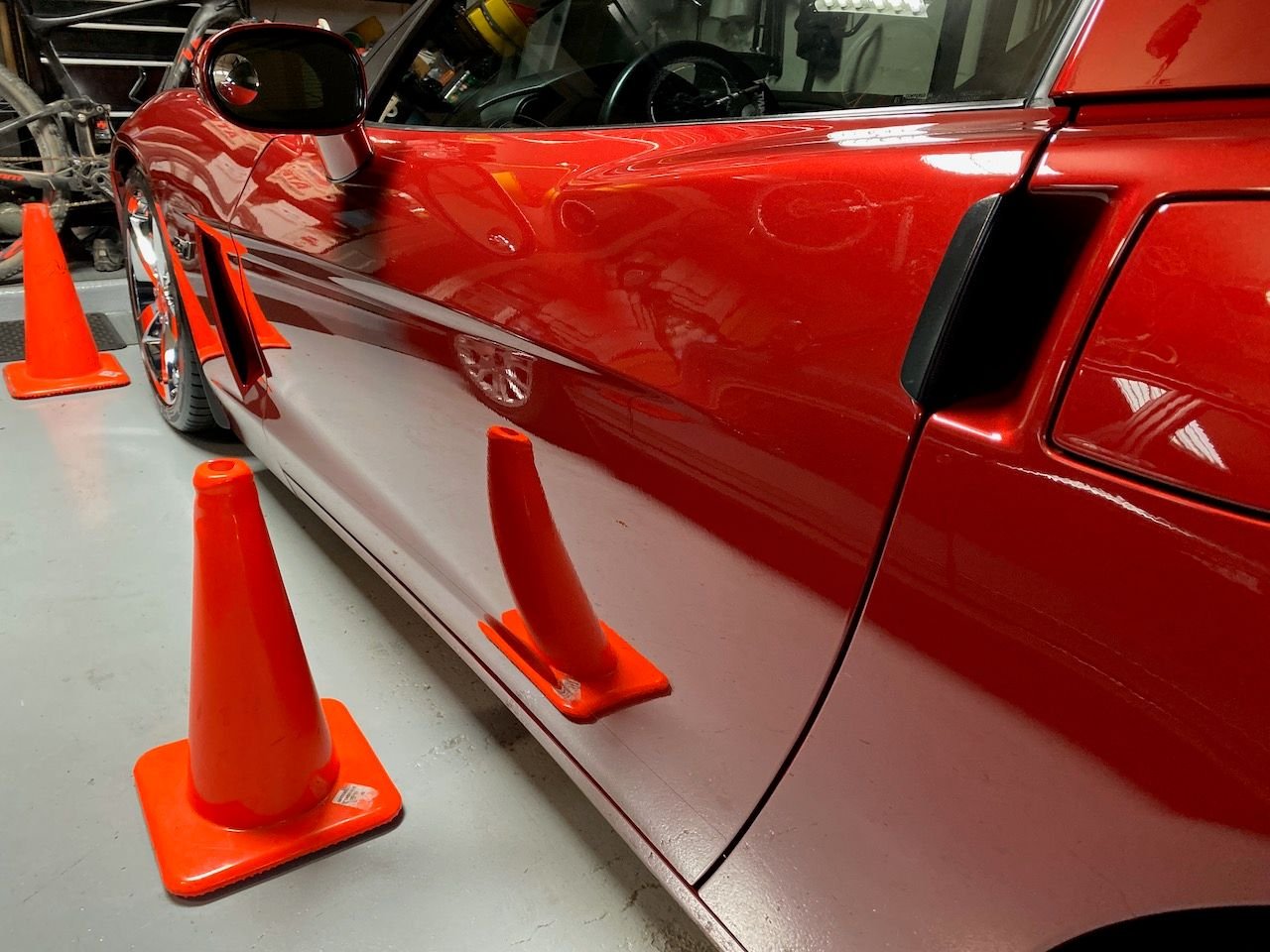

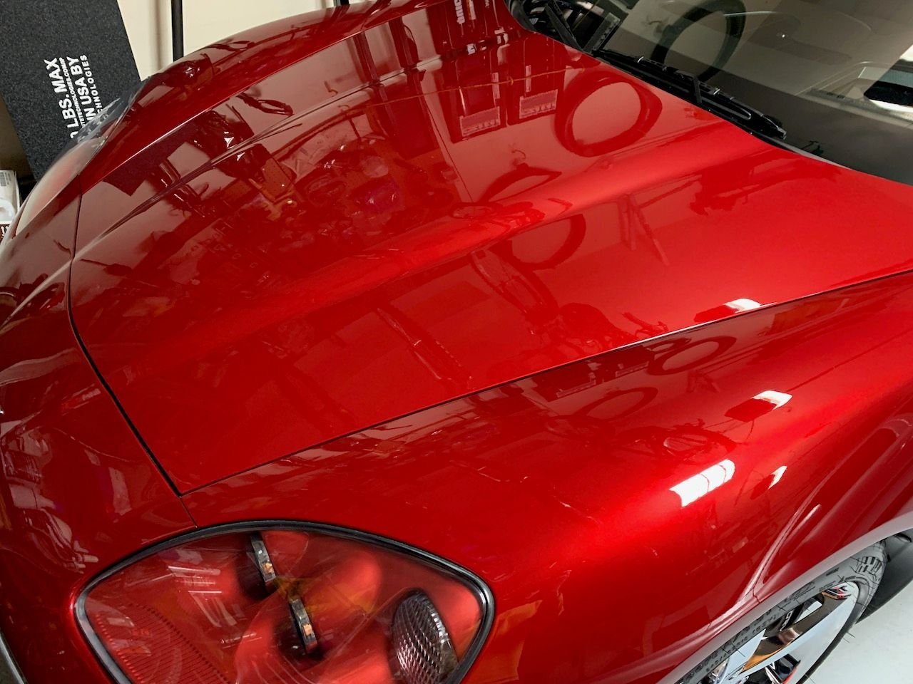

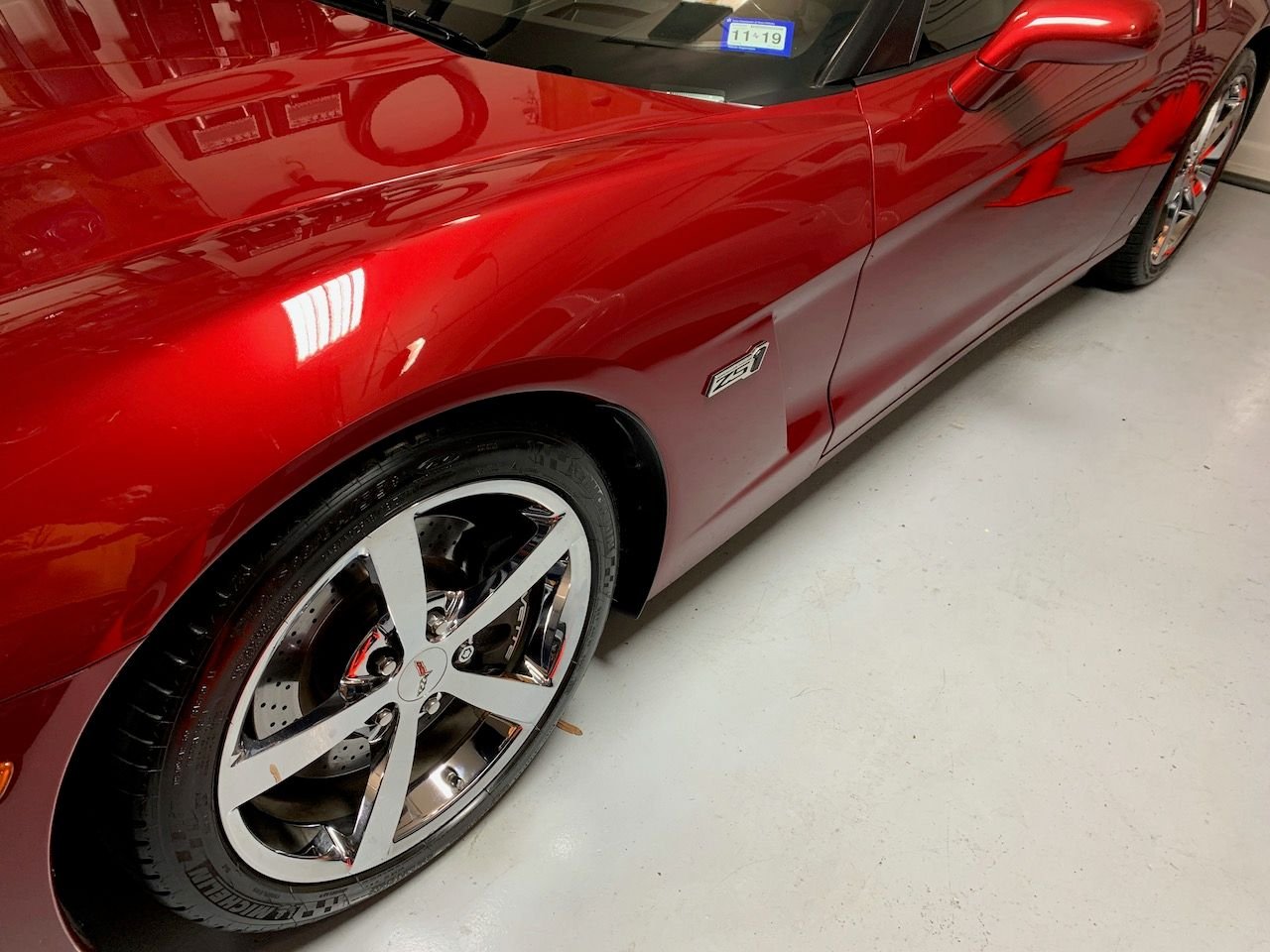

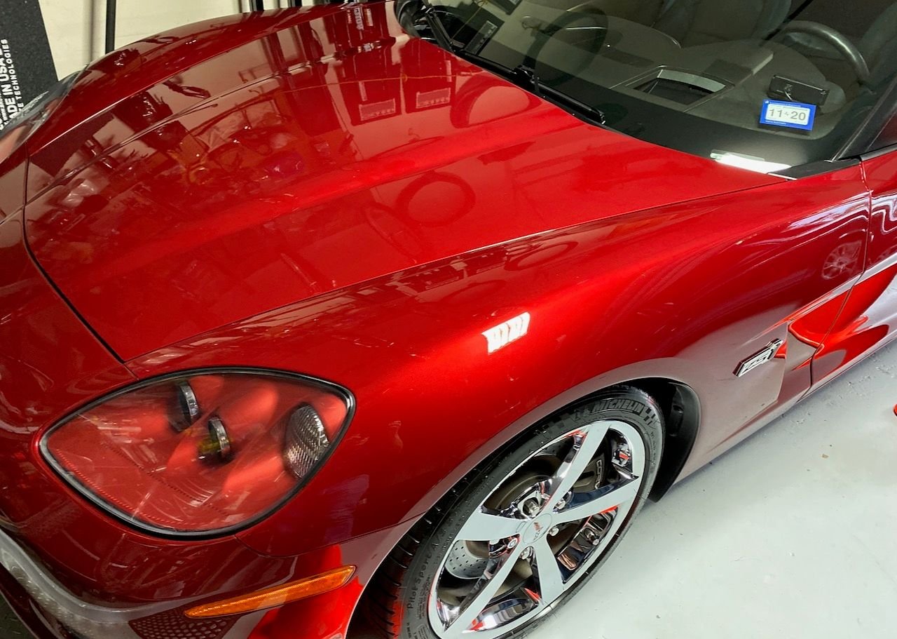

I believe the OP is referring to Dri Wash n Guard. It is not offered by Amsoil. Maybe it was at one time. I does work very well - perhaps annoyingly so. I did a side by side compare of this on two cars with the same paint code. One car is garaged daily driver and is well cared for. It received a full detail with clay + polish + Griot's Poly Wax. Second car is a parked outside daily driver. It hadn't been washed in 9 months. I bucket washed it, dried it, and did a quick detail with the Dri Wash n Guard. I asked two people which shined better. One couldn't see a difference and the other picked the Dri Wash n Guard car. Annoying.
To the better trained eye the Dri Wash n Guard car has a stronger reflective gloss, while the Griot's Poly Wax had a more diffuse reflection. The Poly Wax had a bit better depth. To me the Poly Wax wins, but with that comes more effort. I have tried clay + polish + buffer applied Dri Wash n Guard + a spray on wax topper. The difference is even less distinguishable. It takes deep dark colors to reveal the depth difference the most.
As in this example I avoid using spray on washes on truly dirty cars. Others may be braver. For a true show car I wouldn't recommend any of this. For those it is probably more of a Best of Show carnauba world for when they come out from under a cover. To be fair ceramic coatings for all their benefits aren't recommended for collectable show cars either.
I have also made this comparison on my Vette. First two images are Dri Wash n Guard only. Second two are Griot's Poly Wax. This may all just simply prove that paint prep is the most important step.
Exactly. The correction/polishing phase is what provides 95% of a paint's gloss. Whatever protection is added provides the rest. As many pro detailers have shown using electronic gloss meters, the difference in gloss between various protection products is negligible. There are a few select products that do provide noticeable gloss increases, but there aren't many. Apart from the various sealants and waxes I use as base protection, I do frequently use a number of "topper" spray products proven to add additional gloss, according to the gloss meters. They aren't very durable, but are great before shows and cruises.
