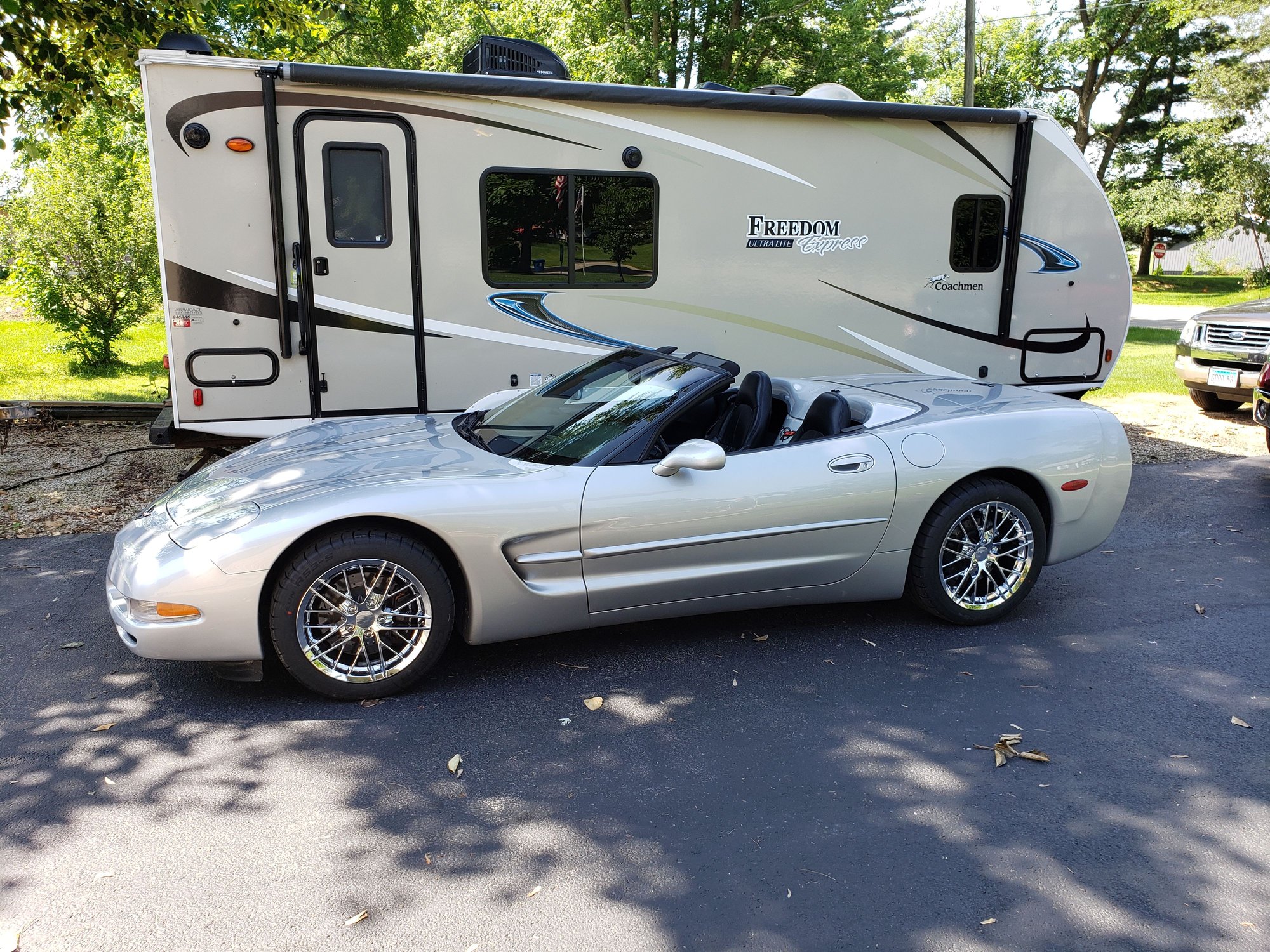

Default VET. and GTO I sold to buy the VET.
I put the new wheels on it.

That's a fine looking C5 the OP just purchased. I like the wheels but I'm glad I don't have to clean them.
