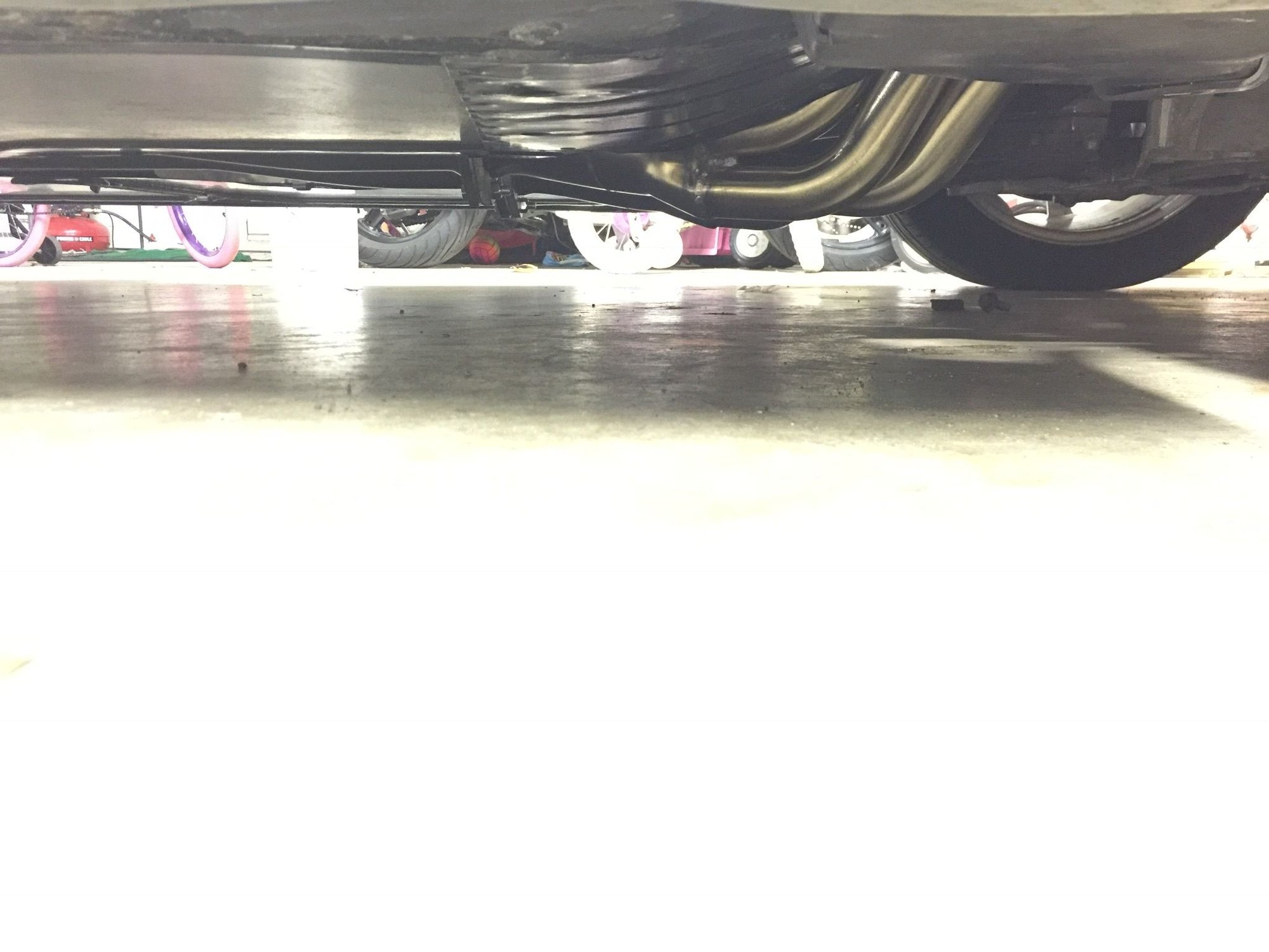

Old Nov 3, 2019 | 01:05 AM

Originally Posted by lavaheadache
I have the Billy Boat headers on my 01. They are great. Don't need to modify anything to get them to fit. I did not have to dent a primary to have clearance for the steering shaft or any of that crap that I see people do for headers. I got them in from the top. Passenger side was simple. Driver's side required pulling the alternator, valve cover, motor mount and jacking the motor up as high as I could to get it to drop in but that was still pretty simple as long as you know you have to do it going into the ordeal. I would buy them again if I were to do it again.
After the install did you have any clearance issues under the car? Any scraping?
pipes seem low but I haven’t had any issues over the two years / 10,000 miles they’ve been on.
